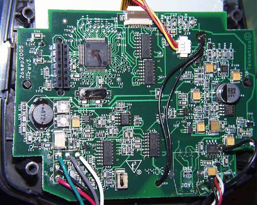

    Hello all, I wonder if anyone can help me out. I use a Teknetics G2 (I think its the same as a Fisher Goldbug), the detector is a great detector, on most of my sites i can run it at full sensitivity and its very stable, but i feel astho i could do with more, is there any way of upping the sens ie replacing the potentiometer or maybe is there an adjustment on the PCB ? Regards Jim.

        you can begin to do experiment with coils NEL or MARS TIGER. to do a mod - have you a schematic? not. so why you ask?
        no pics of hight resolution, no schematic, no part list, NOTHING of info and you hope on something????
        sell this chinese crap, buy xTerra 75 or Deus and close this matter. no decision.

                        I can follow you on the ID feature in AM. But I also think the unit is factory built/set hot, so that improving the gain could turn the detector into a pretty unstable unit. But I do not know of a G2 user that beefed up the gain, so it's maybe worth trying. But I haven't got a clue as to how to do this.
