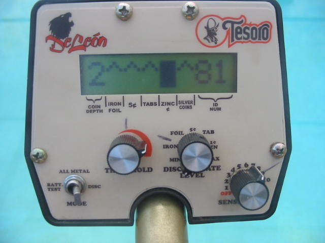

    Hello guys and gals,
    right now I'm going to get some hearing troubles. Falling in this offending noise range is the audio pitch from the De Leon. Just using headphones with volume control ain't e real help. So what I'd like to do is changing the audio pitch of the detector.
    Beeing very familiar with electronics it will be no problem to change a resistor or capacitor.
    But it will be a problem if the audio is done via software in a micro-controller. Using the "search" here brought no result on this.
    So I'm asking the community for help.
    May be there is another detectorist out there who had the same problem and got a solution.
    Well there are possibilities for the audio on that machine. As no schematic is to be found
    we would need pictures of the PC board to start determining how we could mod it for
    different audio.

    Hmm I cannot upload an image right now. I'll give it a try later at home...
      we need pics inside.
        Oh it has a LCD, then it probably has a micro for sound and you probably cannot do much with it.
          is that the same model as the laser hawkeye?, if so there are some schematics(partial) floating around the net.

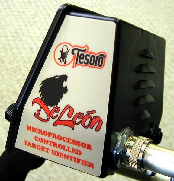

ID:	342359 I AGAIN CALL TO GIVE MORE PICS INSIDE. anotherway this thread is only dead matter. no pics from you - only regress atfar.

                      The DeLeon uses a micro to generate the audio tones. You can't easily change them.
                      That said, I once put a higher frequency crystal in a Sandshark to speed up the pulse delay and it had the side-effect of increasing the audio pitch. So, it may be possible to change the DeLeon crystal to change the audio, but it would probably mess up performance and would certainly mess up the ground balance calibration. It would turn into a huge effort to correct the side effects.
