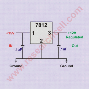

    ~ c) Power: what about power source? is it best to use 18v and regulate to 12v? if yes what is the best way? i have read in a post that using 7812 for is a way to go, but is this any good for this pcb design or will it introduce more noise? what about two huge 10000uf 35v capacitors? please look at the attached picture is this the right way for the 7812 ?

      The 7812 is a bit of a brute force method to regulate the power it needs 2.5V to function you might look for a low drop out regulator.

        about the regulation, does the voltage regulation make things better *while( detecting?? or its just to keep settings the same for a period of 30mins of continus detecting (because voltage does drop slowly 12,01 / 12,00 / 11,99) ?? i dont care about the second, but i care about the first

          The 12V regulator will get hot and not let you run as long but no improvements in detection. An area that could be
          worked on is the -E generator. A real regulator there would be better. Increasing the +E -E would help too but you
          have to be sure the transmit is still biased properly...
            since there is nothing we can do best in this pcb as is, i hold this as a todo for a real electronics gangster like you know who you are!!
