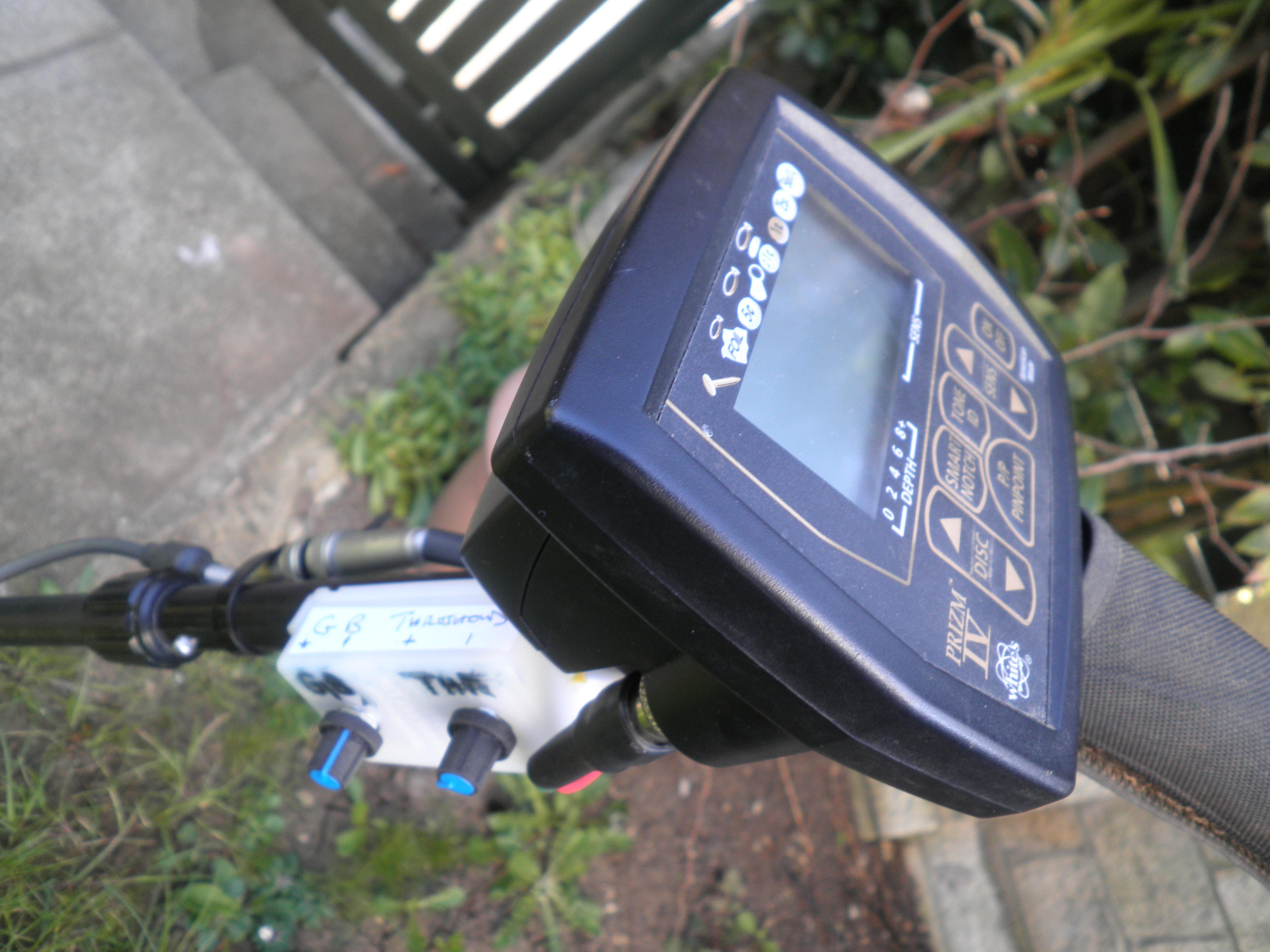

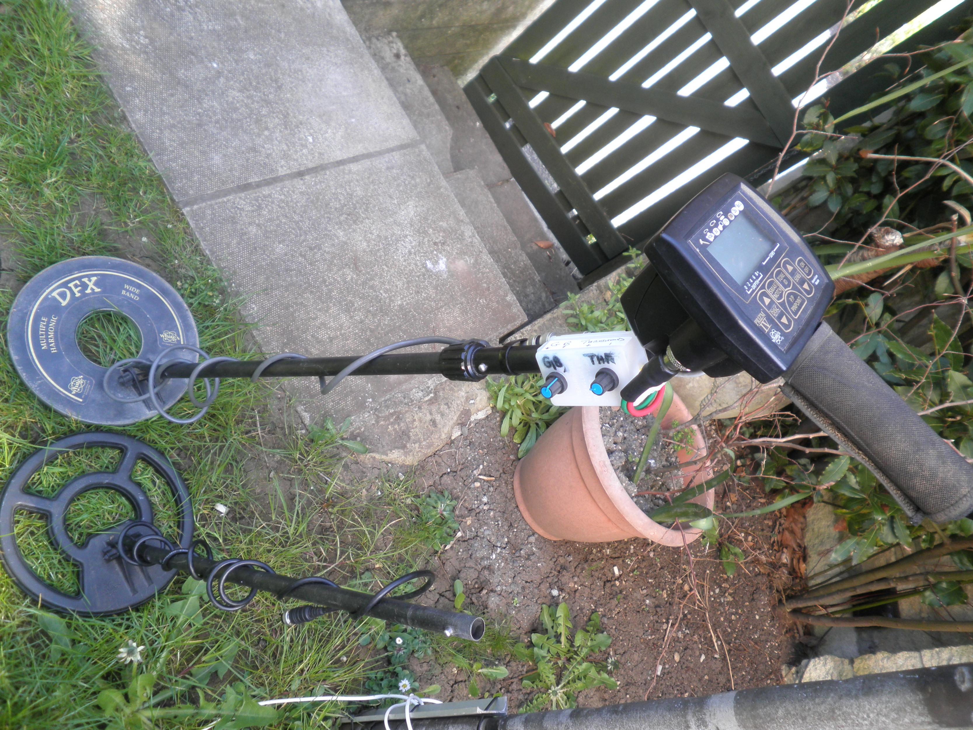

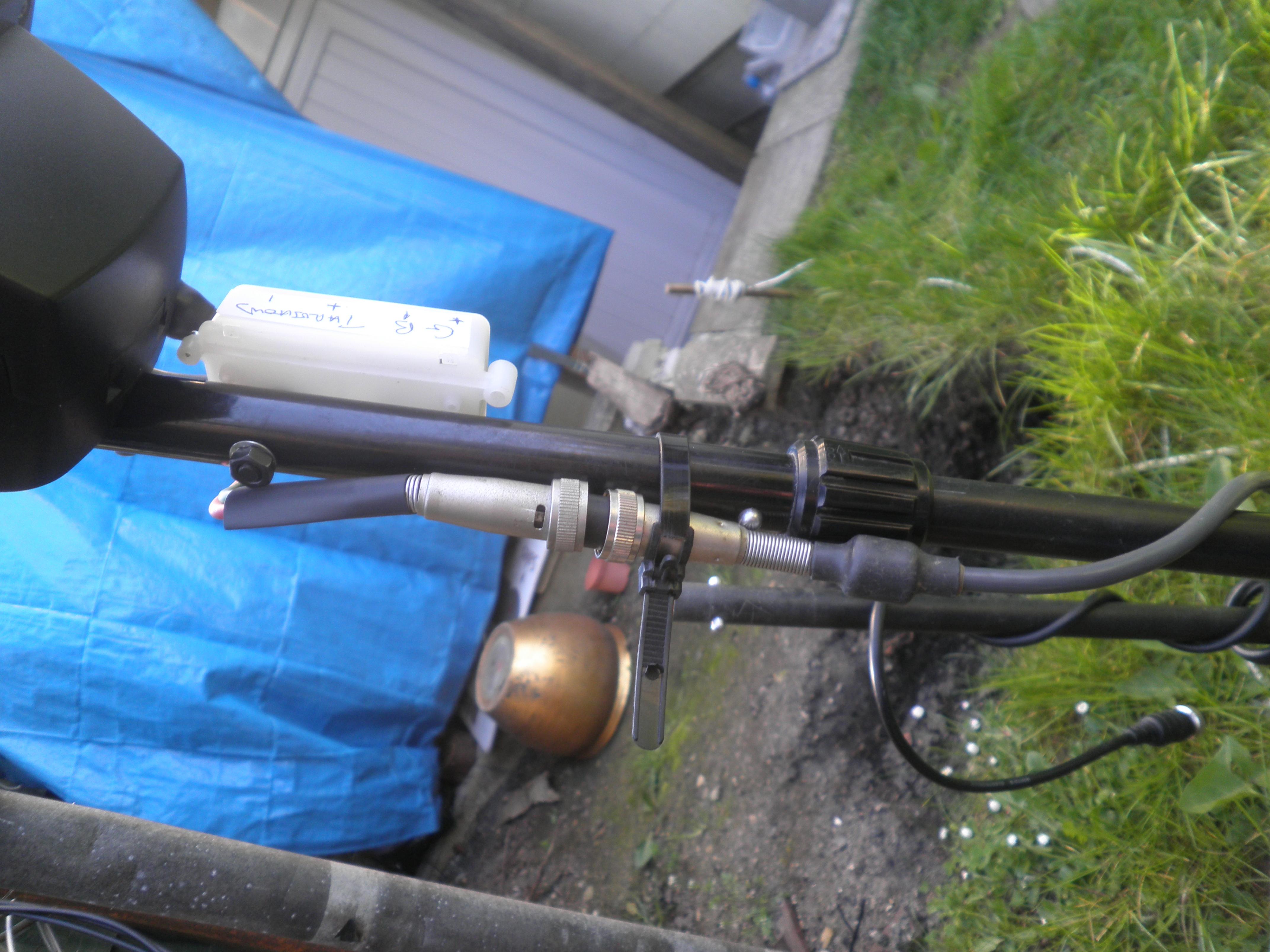

    Hi
    Prizm V1 modifications include external manual ground balance, external threshold and now able to simply interchange coils produced for the DFX,MXT,V31,VX3, and M6.
    Components for coil matching integrated into adaptor lead.
    Machine is very stable and in my opinion is now in the mid/high range of detector .
    Using the DFX 10" coil is my favourite to date because not only does it give that little bit more depth its allot more stable, improved VDI accuracy , pinpoint in all metal mode is accurate bang in centre of coil, also depth read out is much improved in comparison with 9" web stock coil.
    Will update with further tests

      Dave, nice job. Do you he coil pinout ?Also values for the GB and Threshold pots? Is is possible to tune the existing coils?
