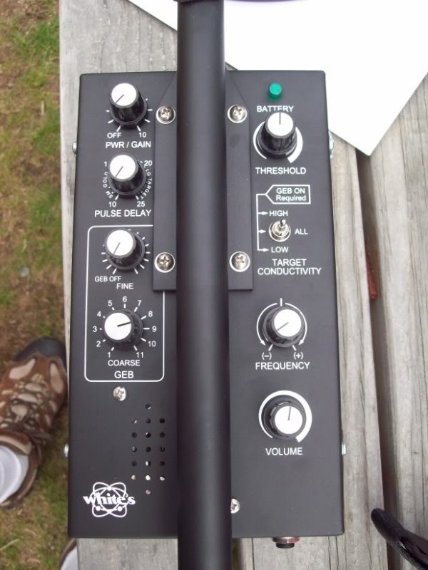

Eh, not exactly... the Pro has 2 add'l controls: fine GB and volume. SL has slightly less raw depth but also runs quieter (less chatter), same bells & whistles (controls) as the std TDI.Originally posted by Beach Bandit View PostThe 1st or early TDI has the most controls,then the Pro has the same size control box but has a couple less contro knobs..The SL is near 3lbs in weight compared to about 5lbs with the other two..and the control box is smaller.I haven't heard of any difference in performance between the 3 machines just the SL doesn't have all the "bell and whistles" as the other two...

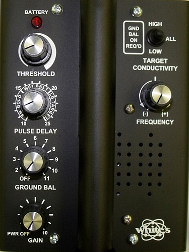

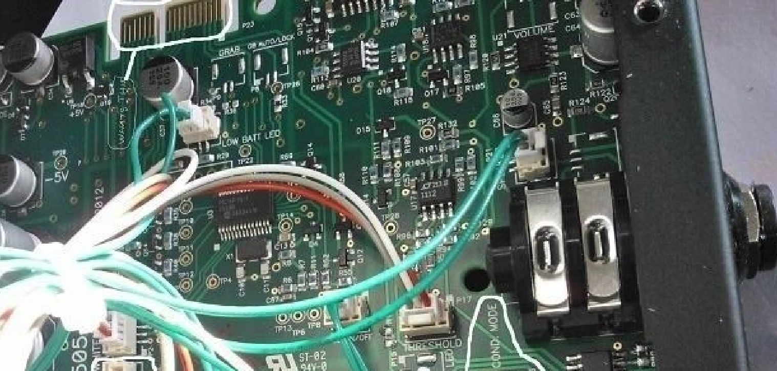

Some TDI Control Boxes and SL (SPP) pcb screen capture.
I have some images I leached from various places on the internet.

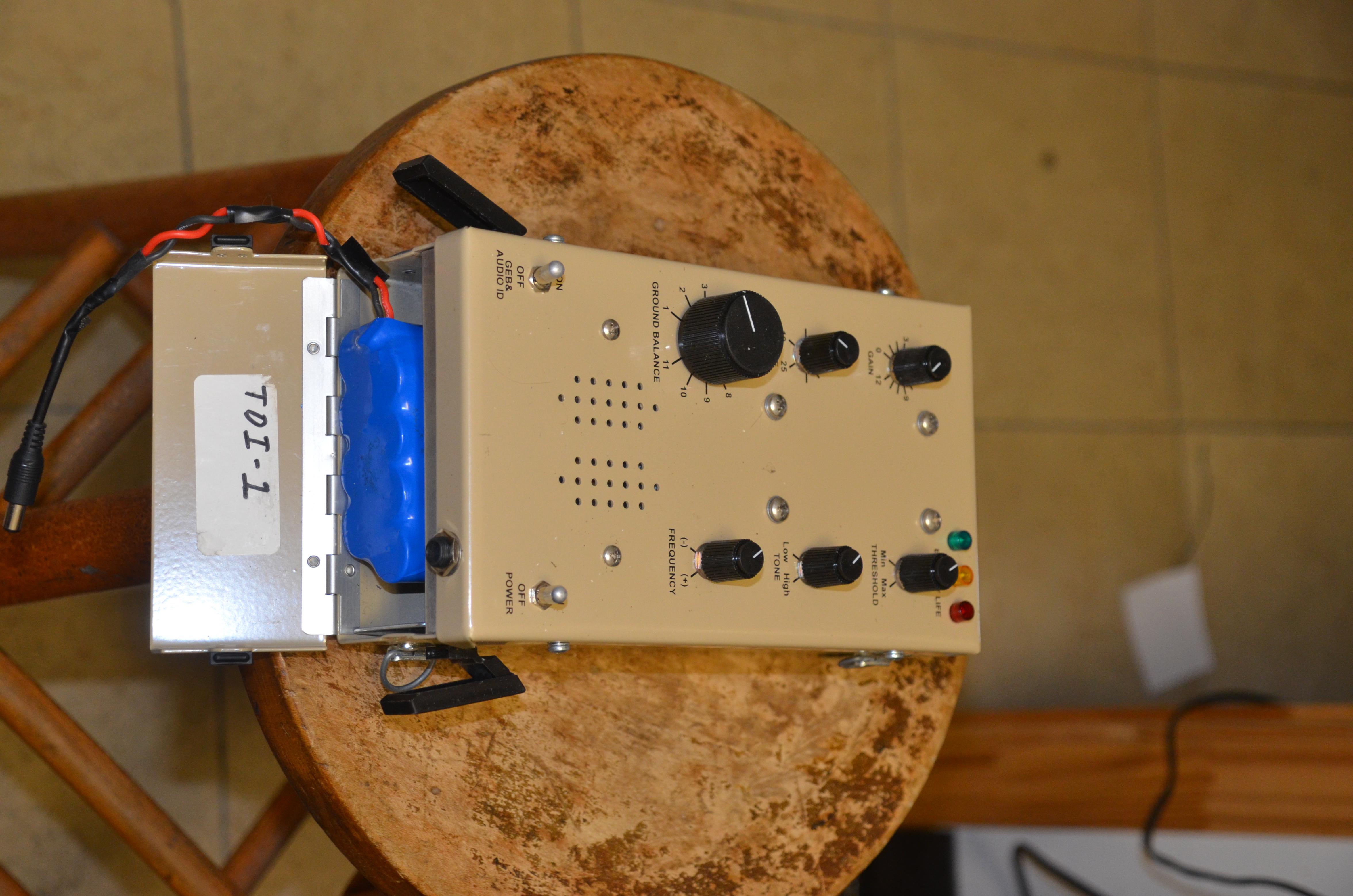

Very early TDI.
TDI Pro.

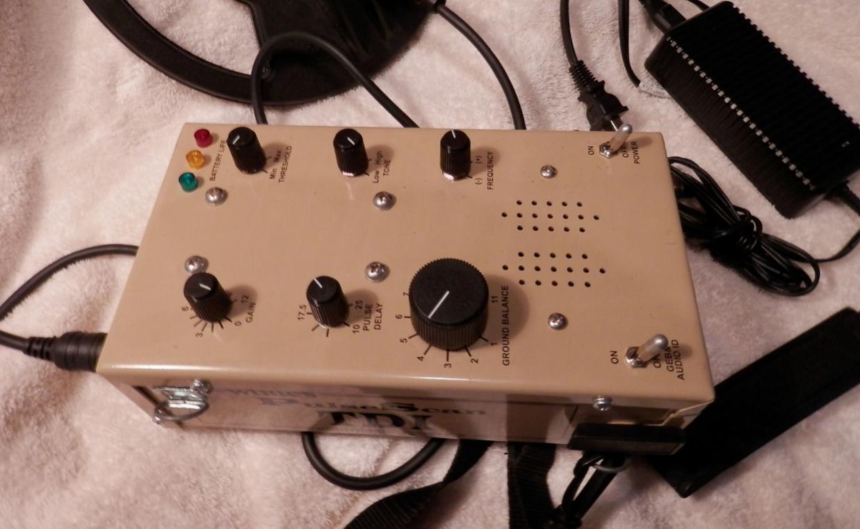

Early TDI (also listed as TDI 300 on some vendor websites).

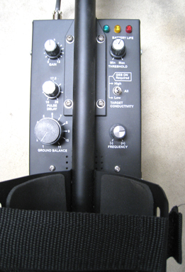

TDI SL.

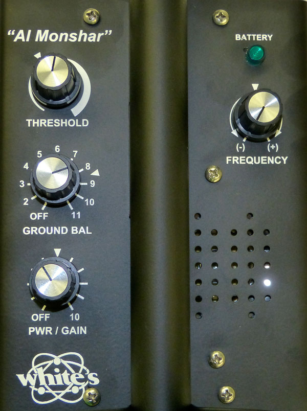

Whites GMT SuperPulse ("Al Monshar") / Whites SPP.
I think Geo posted an image of his TDI pcb, somewhere here on Geotech.
And on https://www.prospectingaustralia.com.au/forum/ , you can find an image of the SL/SPP pcb. They have differences. It appears the SL/SPP has a few features that for some reason Whites decided not to implement. Namely "GRAB" and "GB AUTO/LOCK".

When I designed the SL I threw in some hooks for development work I was doing on ground tracking. That work turned into an entirely different machine and the methods I developed didn't work on TDI. So there are no unimplemented features on TDI, just unused hooks.Originally posted by greylourie View PostIt appears the SL/SPP has a few features that for some reason Whites decided not to implement. Namely "GRAB" and "GB AUTO/LOCK".
I actually own this TDI in the photo. Inside the battery door its marked "TDI-1". It has pcb's markedOriginally posted by greylourie View PostI have some images I leached from various places on the internet.
Very early TDI.[ATTACH]33470[/ATTACH]
PPD6 for Pulse Power Developments 6 and a audio board made by White's. This would have been the Goldscan 6
if Whites hadn't license the design. It is for sale if anyone is interested.
Yes this unit was on Ebay. The photo from the listing was posted above by greylourie "early version". The seller sent it with a White's vlf coil, probably why he didn't like the performance. In the photo notice the black coil cable, the TDI coils all seem to use the gray cable. When I hookedOriginally posted by Beach Bandit View PostAltria.....Was your TDI on e Bay for sale a few months ago.?....What were you asking for it.?...Regards.
a minelab gpx coil it worked great. I was going to mod the unit, but thought maybe better to keep it original. I am selling for $560 plus shipping. This is for the box, battery and charger. No other accessories. PM if interested.
