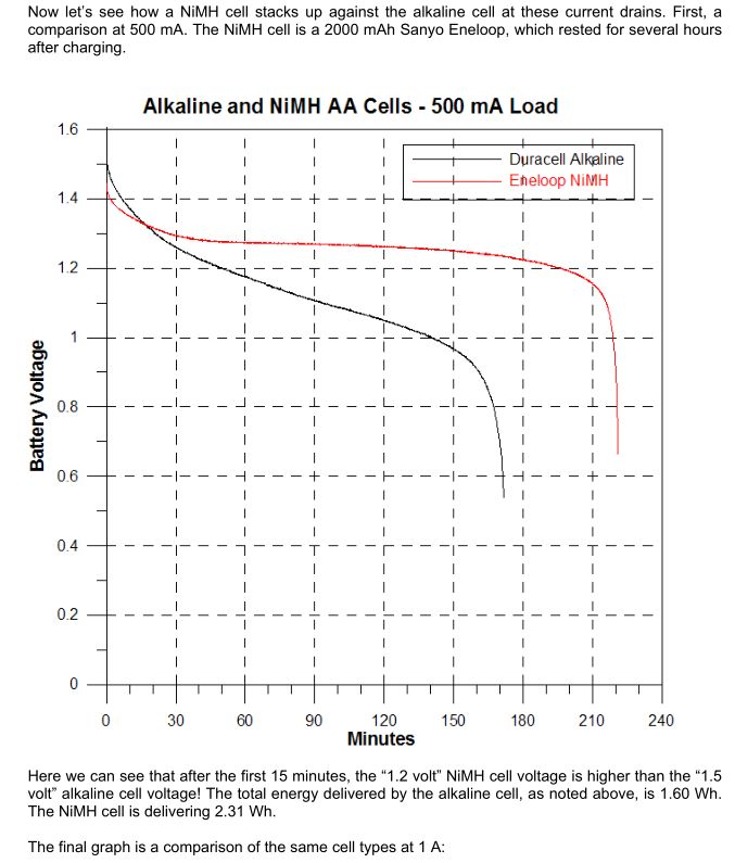

                            I've been using 2nd generation eneloop AA NiMH'S 1900 mAh (3UTGA) for 2 1/2 years. Active usage up to now about 900 hrs.
                            I am VERY happy with them. The 4th generation is already out!
                            I charge them with 500mA.
                            If you choose to get re-chargeables do yourself a great favour and get an intelligent charger with delta t &or delta v (I'm sure someone can explain this better).
                            I've got the BC700.
                            Here's a pic of discharge curves alkaline vs. NiMH:
                            Taken from this pdf file which I find is a nice read:
                            1.5_vs_1.2_Volt_Batteries.pdf
