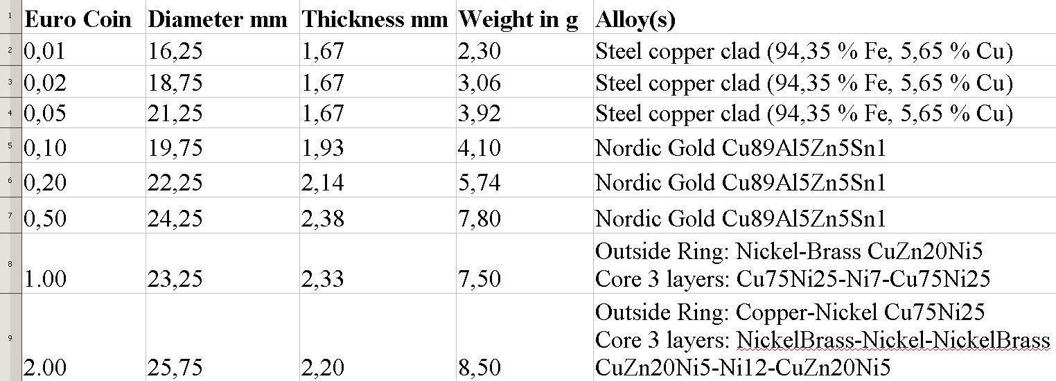

I am using a 1946 Nickel to experiment with my Surf PI.
Solid detecting distance with threshhold absolutely quiet: 24cm (9.5")
That's quite a good result from what I have read and understood on this forum.
What has me puzzled is why Euro coins can only be detected around ~25cm (10")
Adjusting the delay is what I would call "finicky" and it's hard to hit the max distance.
I do that by measuring the voltage at PIN 7 of the 358 which is 1.7v in this case.
I don't have an Oscilloscope yet, so am doing everything by trial and error.
Here are the specs:
Coil: 20 Windings Teflon, Oval, 12.6"x5", R=1.4Ω
Rdamp= ~750Ω (found thru pot adjust))
Power: 85mA
Frequency: 2560 Hz, Txon=32us, Txoff=358us
(calculated with values of 555 C & R's)
My question: why is the detecting distance of other coins only marginally better than that of a nickel?
Have I been messing around too much in the circuit and gotten lost ... Any pointers much appreciated!
