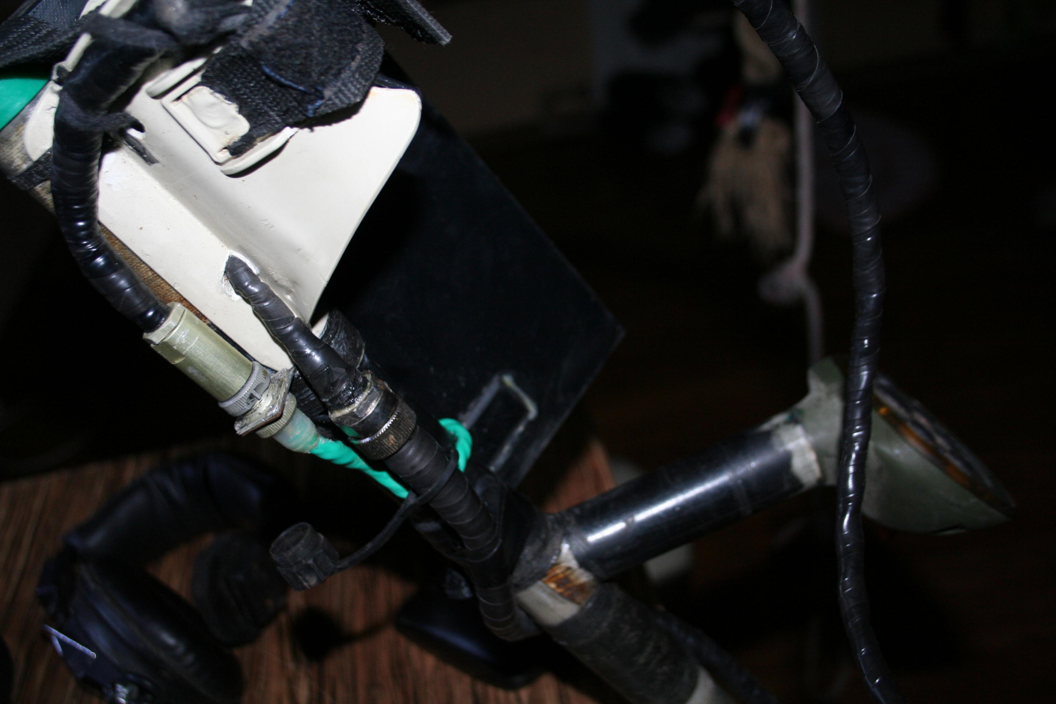

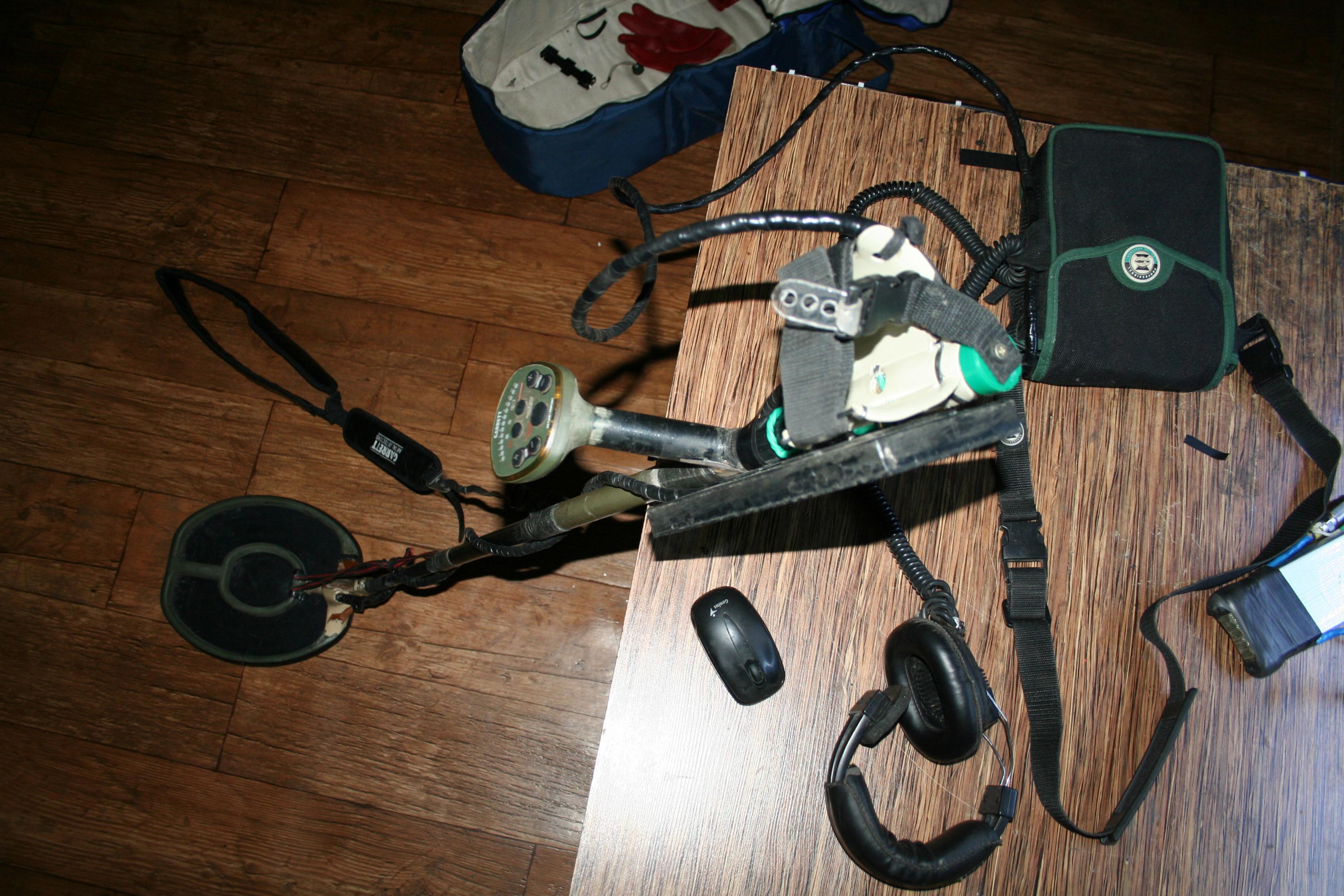

    Here's what you can do.Click image for larger version

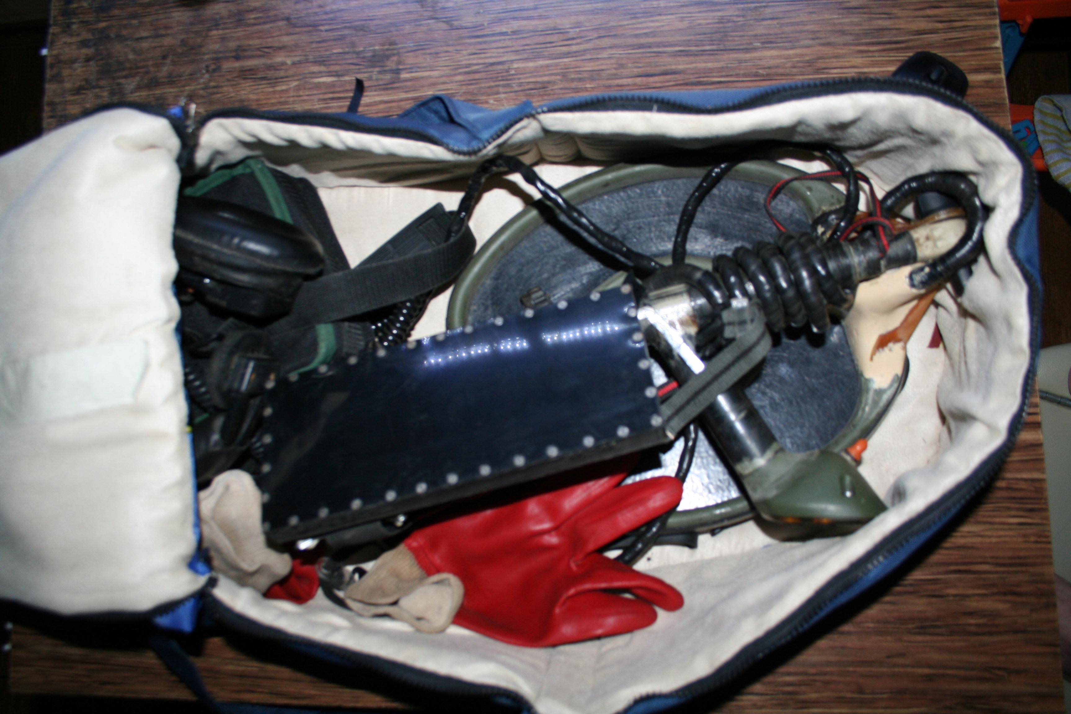

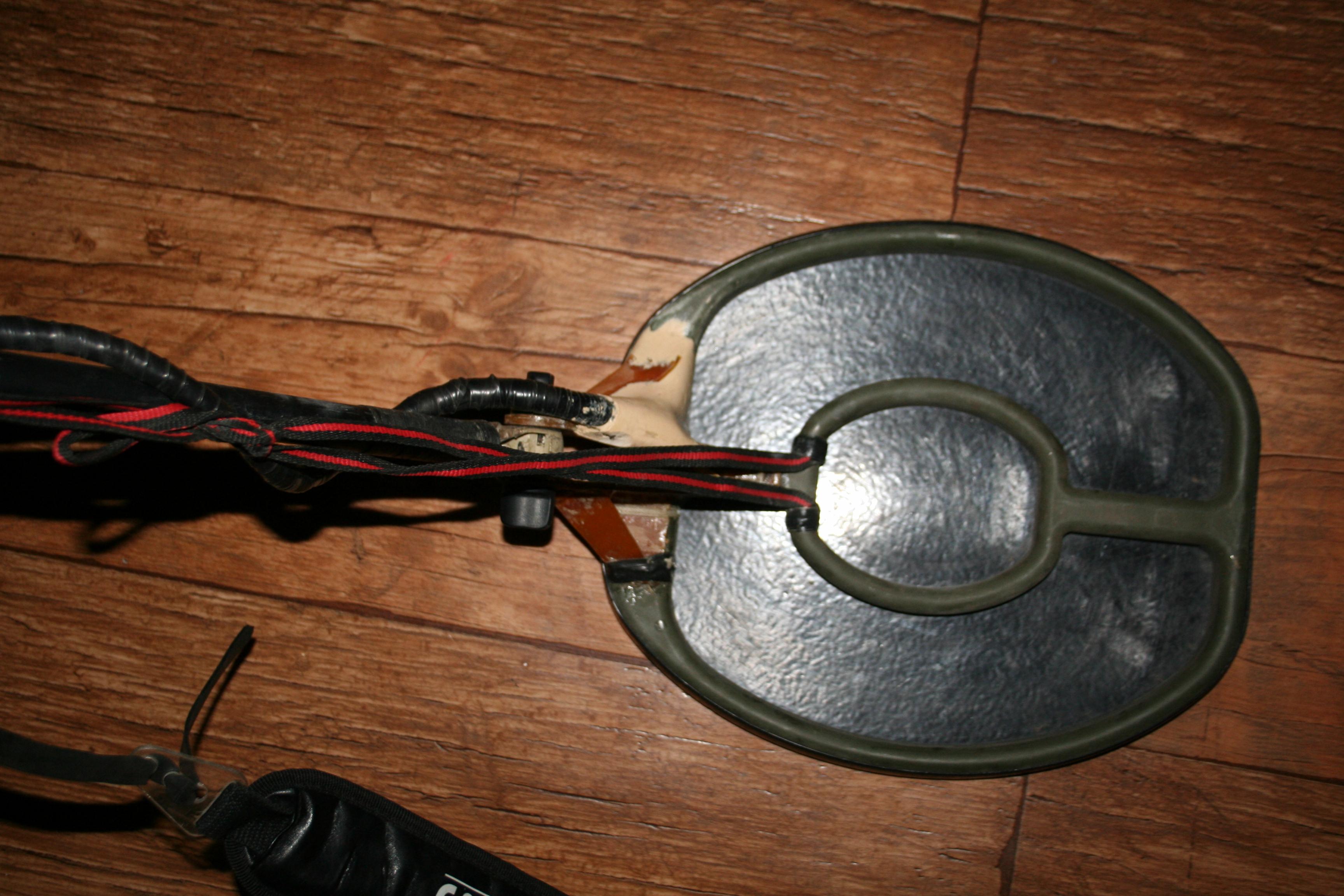

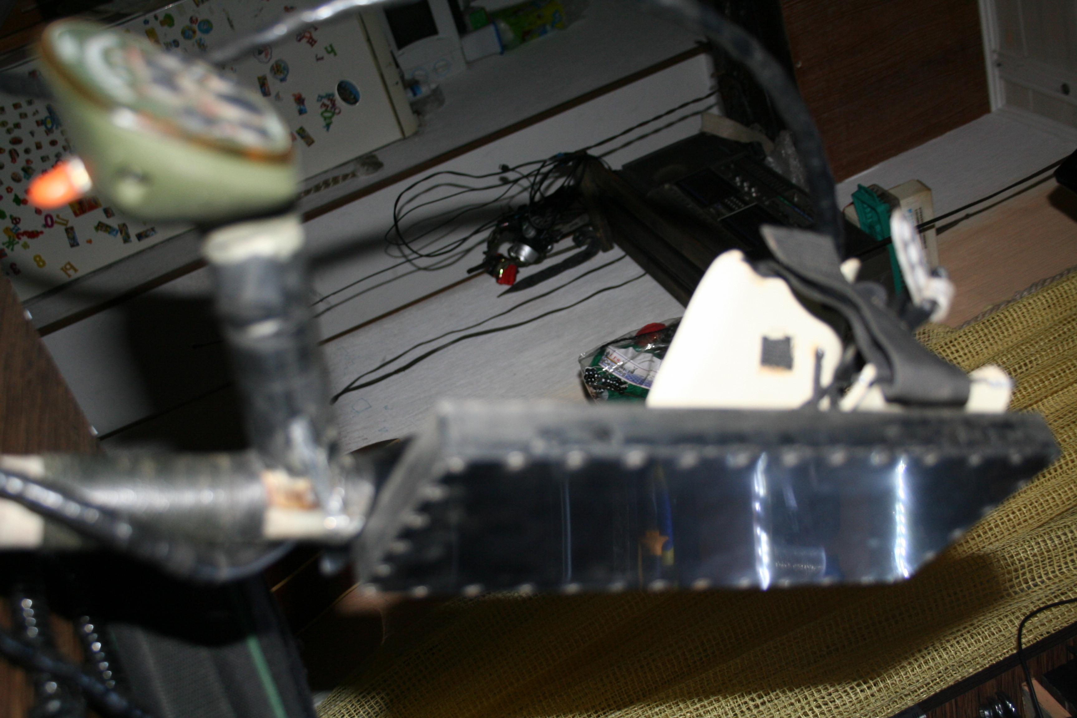

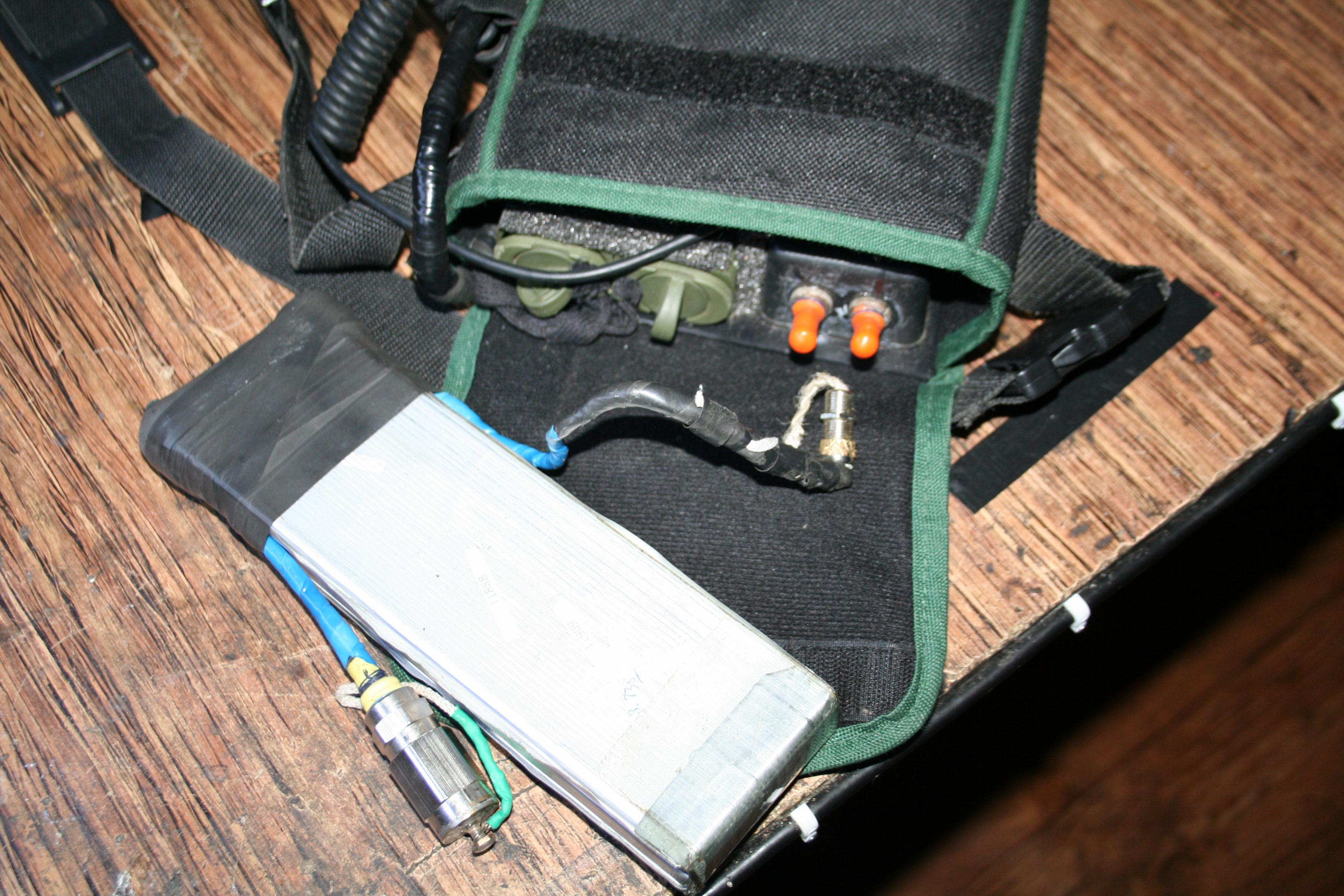

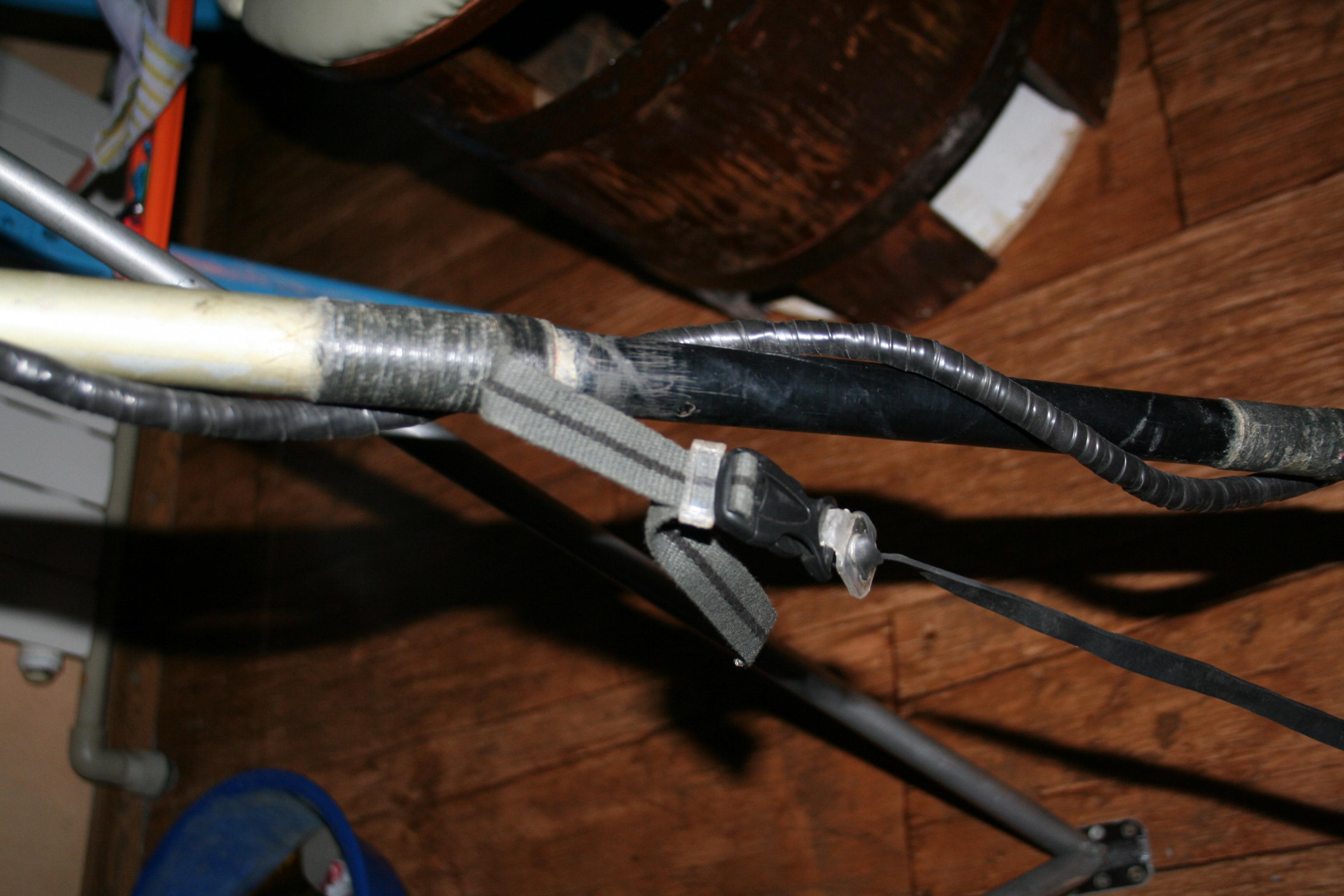

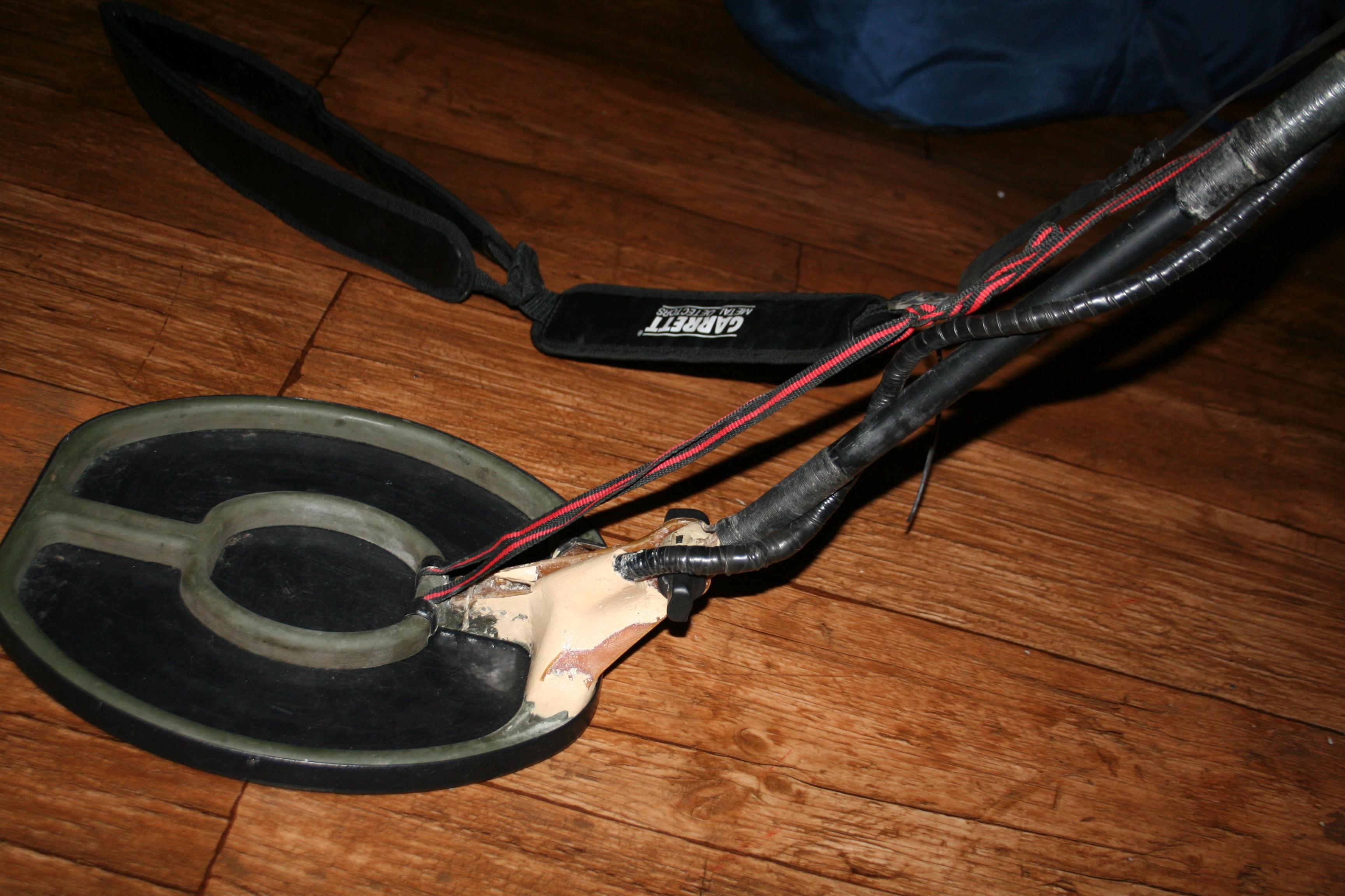

    • #47
ID:	347766Click image for larger version
ID:	347765Click image for larger version
ID:	347764Click image for larger version
      • #48
        • #49
          [ATTACH]38719[/ATTACH]
ID:	347771Click image for larger version

                    I realise this thread is a bit old, but I'v been digging recently in old ATX and have some data that could be useful to you guys.
                    The stock 12"DD coil has the following parameters;
                    TX 270uH, 700mOhms with the cable.
                    RX 540 Uh, 12 Ohms with the cable.
                    The coil cable is with two pairs individually twisted and screened together. No screen between TX and RX part of the cable. The TX cable wires are about 0.6mm square, the RX cable wires are very thin.
                    The RX loop is balanced perfectly. If the RX loop is out of balance the Iron Check does not work properly and probably the discrimination too.
                    The 20" x 15" ATX mono is build with a RX pick up coil that is stuck on top of the TX loop. The RX pick up loop is of thin magnet wire. The TX loop is Litz. The electrical parameters are the same as of the 12"DD.
                    The RX pick up loop is controlled by a switching smd board (placed in the coil) that takes the TX pulses and trough a switching schematic done with mosfet transistors and no added power supply. The switching board is connecting the RX pick up loop (only when the TX loop is switched off) to analogue ground and the input of the detector like the RX on the 12"DD.
                    The reason for this is because the TX of the ATX is a self regenerating type (this is what it looks like to me) or a sort of a pseudo resonance of sorts and it can not function properly if any inductive load is opposing the TX loop.
                    The TX loop in the ATX has no reference to analogue (signal) ground or minus of the battery therefore standard Mono coils can never work. The ATX requires a separate RX loop to function properly.

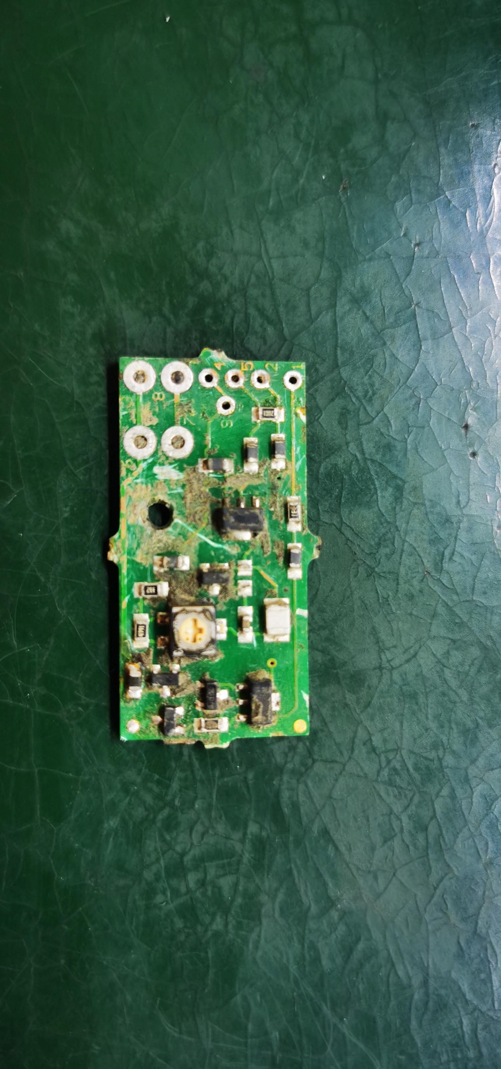

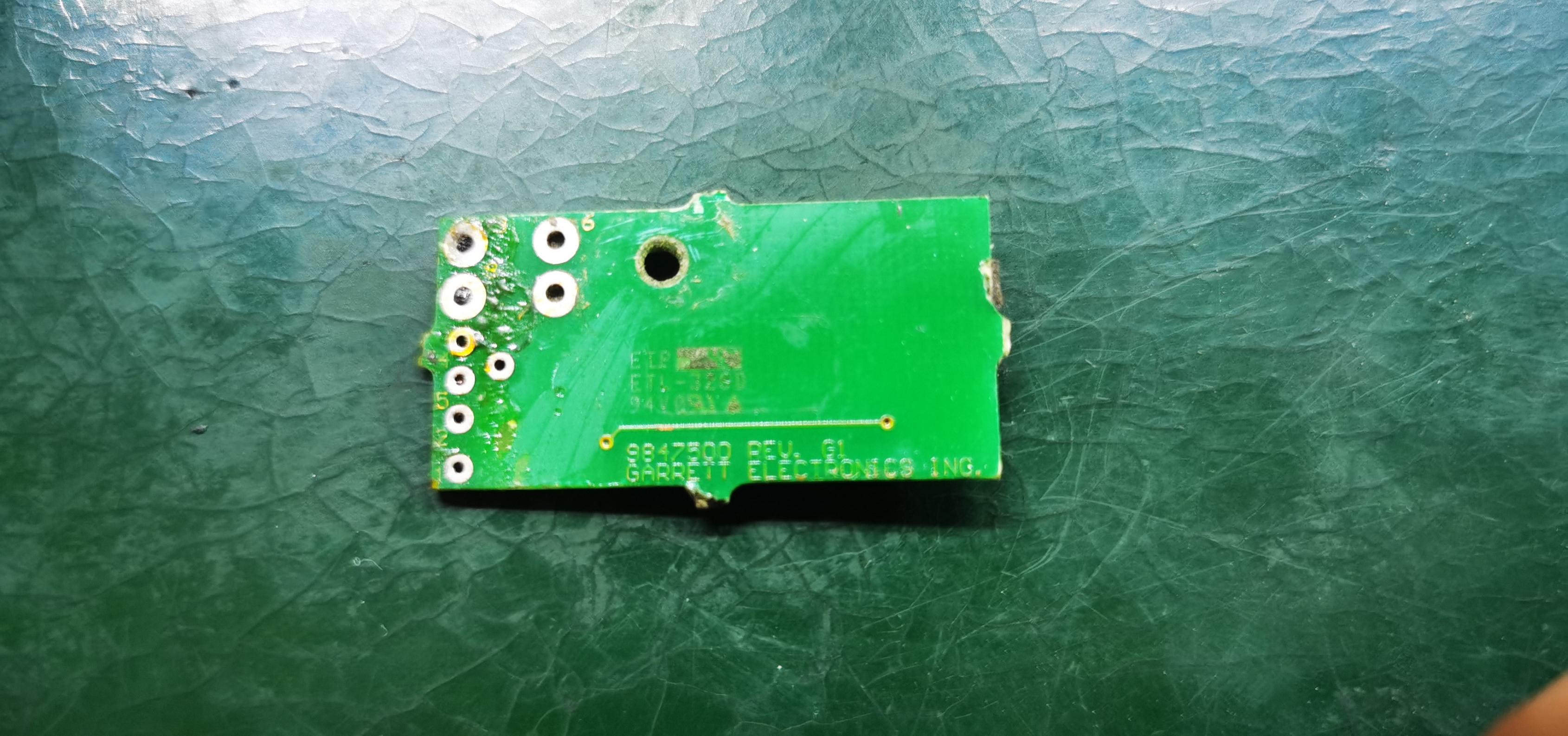

                    • #55
                      这是从ATX里面拆出来的小板子,但是忘记怎么接线了,可以研究一下
                      • #56
                        Please post in English, thanks.
                        • #57
                          No posted scheme (or I not found yet) for Garrett ATX but from the pictures of the board we have to make the conclusion that the two power MOSFETs + the two U3G diodes + one big poly capacitor have to be used for bipolar half-sine or bipolar truncated-sine TX pulses (also the power supply solution uses two "banks of 4x alkaline batteries). The civil version of the Garrett's mine detector "Recon Pro AML-1000" have to be very close as idea and case of the original.

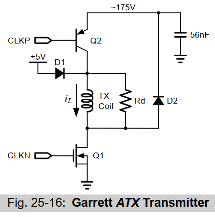

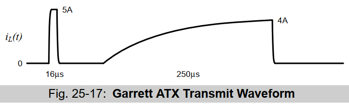

                            No, they are used for energy recycling on the short pulse. Here is the TX circuit (from ITMD3):
                            Click image for larger version  Name:	image.png Views:	0 Size:	28.9 KB ID:	444749​
                            The TX (current) waveform is a short boosted pulse and a wide normal pulse:
                            Click image for larger version  Name:	image.png Views:	0 Size:	22.0 KB ID:	444750​
                            Axiom is the same, Recon likely also.
                            • #59
                              Hi Carl,
                              Interesting, it is too brave solution to use not bipolar TX pulses for mine detector in Recon MD. Thank you for this explaining. It is important to read ITMD3 more slow and with more attention!
                              • #60
                                Something strange haves in this time-diagram (Fig. 25-17) for me. The change of the voltage on a capacitor is "delta U= (I x delta t) / C. Start voltage is 175V. The short pulse is 16us. The capacitance for peek voltage storage capacitor is 56nF. The peek current of the short pulse is 5A. If the form of this current is triangle, average discharge current is 2.5A. As a result: (2.5A x 16us)/56nF= 714V. For 16us the discharge voltage of 56nF capacitor will be 714V but the start voltage is only 175V. Some strange happened. The energy on 56nF capacitor is not enough to generate 5A coil's current in 16us. Or I'm not right in my calculations?
