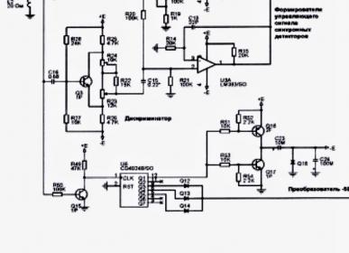

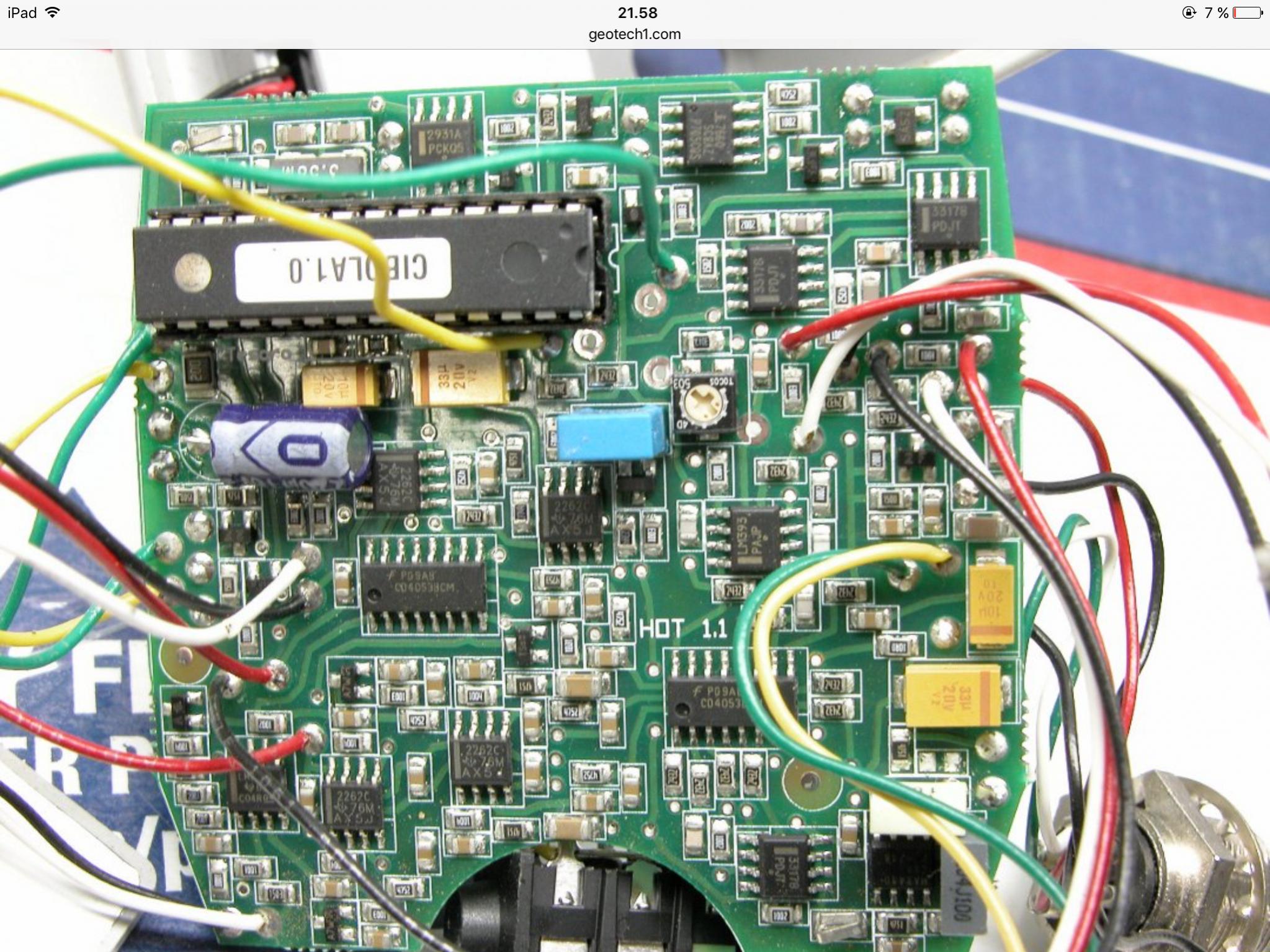

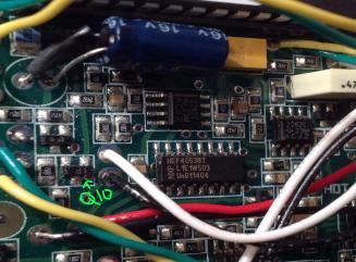

    Picture shows my board and to me its seems that IC 4053 or IC 2262 is placed where the IC4024 at the Compadre, were I should change the connection 1N4148 (or similar) from pin 9 to pin 11.

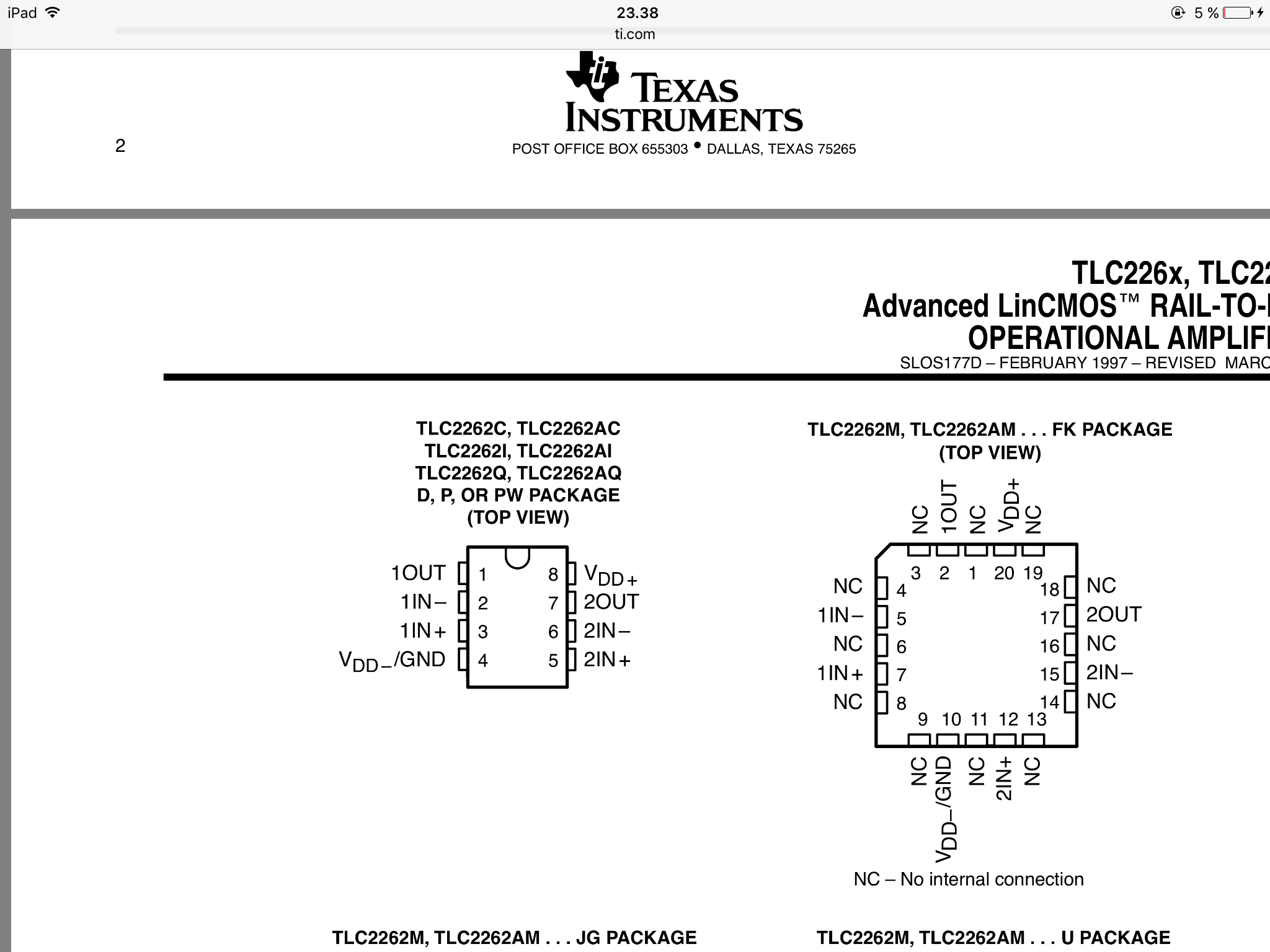

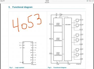

    I posted some other pictures, scematic IC 4053 and 2262, and none are similar the 4024 (counter)
    could it be that the tones are preprogramed in the IC controller (named Vanquero) ?

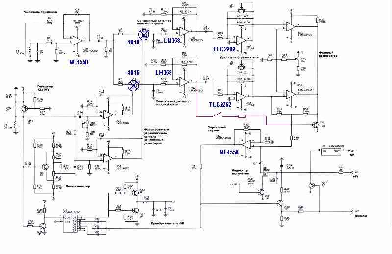

    PS picture below (no5) is part of the Compadre 4024 IC, were the tones can be changed.

    its seems that the Cibola and the Vanqero is Very similar inside, and the Compadre is totally different. My mistake.
    and two Tesoro models (cibola and Vanqero) they must be send over the Atlantic to Tesoro, to change the tone.

      i do not know that is vanquero. i know there is Vaquero.
      compadre is full analog, vaquero - give please more hi def pics inside just cause i have pale board pics - is u-chip based.
      so yes maybe (PROBABLY) you are right that Vaqu is similar to Cibo.
      waiting pics from you and ready say something more.
      there is specific difficulty for you - sound is forming by a code, programming. that is why you do not find up the divider 4024,
      as not so needed in the case.

        it is the the same, the cibola and my vaq..
        I found this picture of yours (cibola) picture 2
        and mine vaq. picture 1
        Its a tesoro job to change the tone I think.
