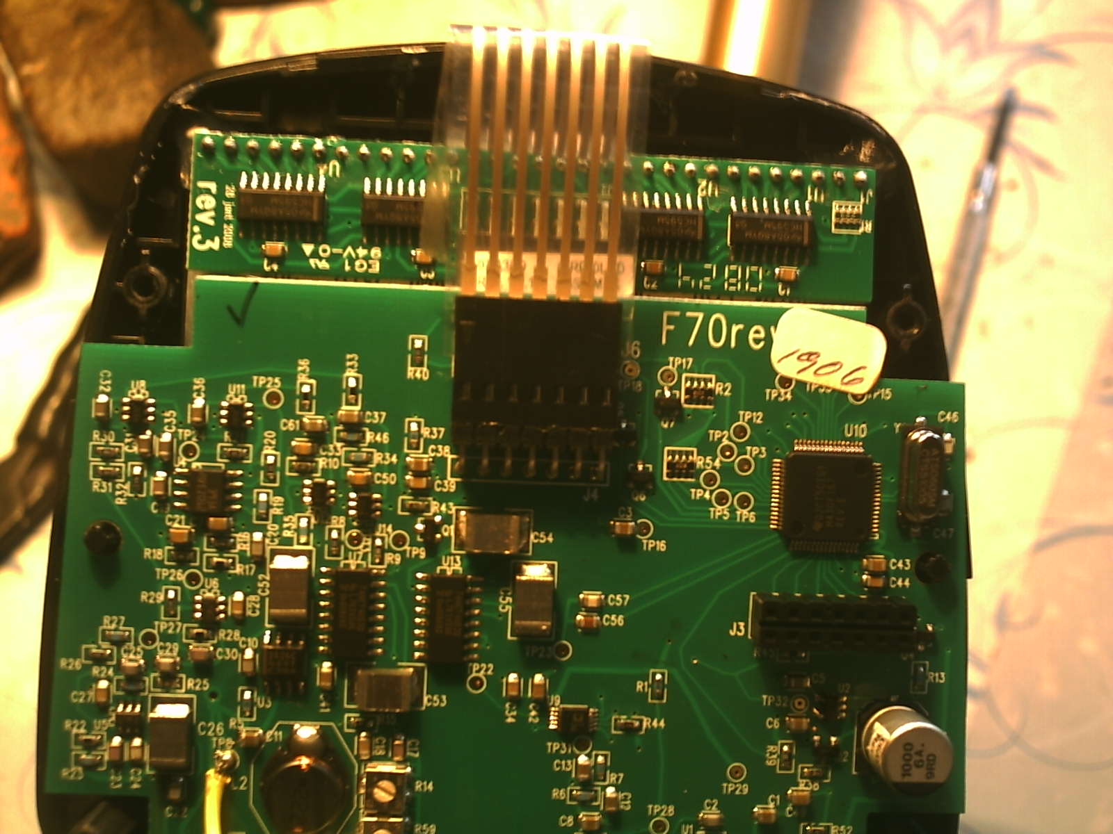

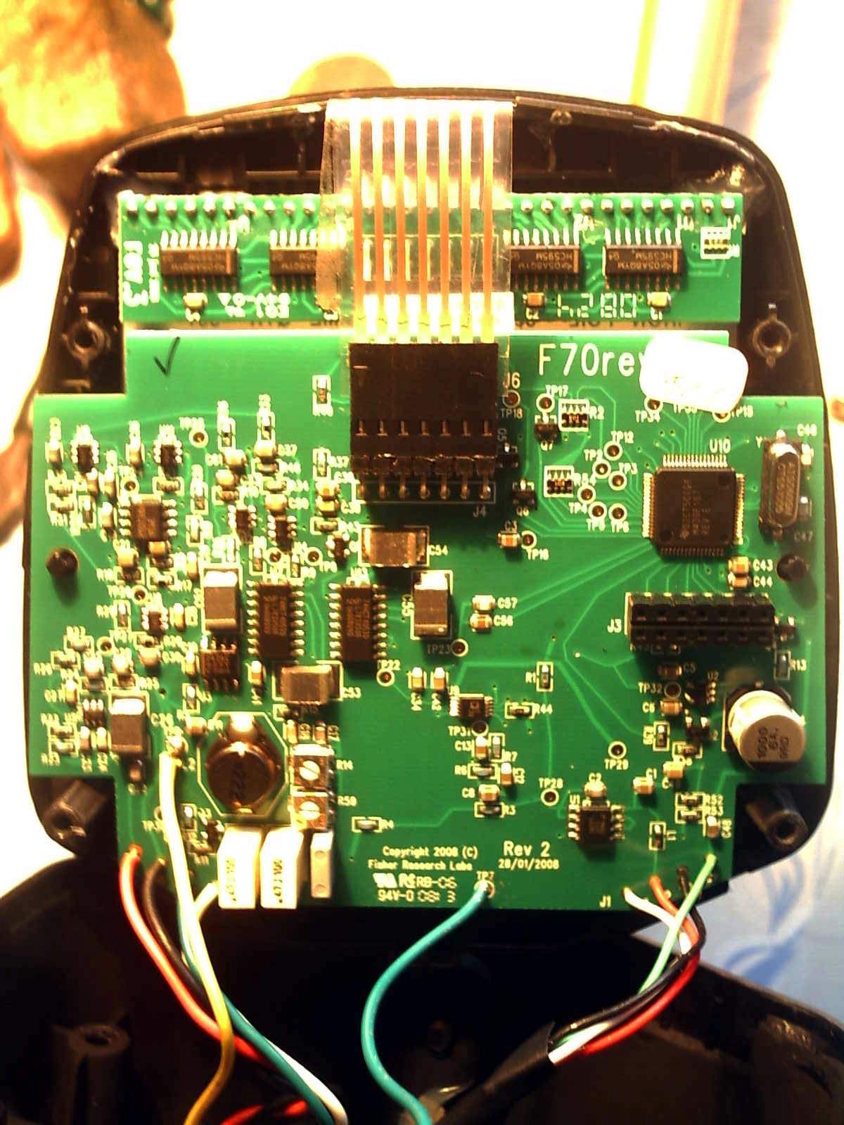

    I am having Fisher F70 on repair. Usual story; there is no legal&regular custom support in Serbia for Fisher products.
    Sending faulty device abroad to legal service is usually out of question, due several serous reasons.
    Overall costs in such case will reach 1/2 of price. Completely pointless. People from abroad do not understand that problems.
    So... what's wrong with this F70?
    It will not turn ON. After dozen attempts; suddenly it turns ON and behaves correct. Than all of the sudden, randomly; it turns Off.
    Next dozen attempts to turn it ON fails. After several hours it still will not turn ON. Than again, randomly; it suddenly turns On.
    Sometimes when it turns On it is not behaving correctly, some elements on LCD display are missing, it displays random patterns etc.
    Sometimes it is producing some erratic tones for short period and than turns Off.
    All is happening pretty random. Most of the time it is dead, not turning On, not displaying nothing and not producing any tone.
    Ok.
    So first i checked trivial things; batteries are alright, contacts are alright, switch is alright.
    Cables from battery&speaker case to main case and pcb are alright.
    8-pin 5v regulator on pcb is giving proper 5 volts.
    All Vcc points are properly supplied with 5 volts (opamps etc).
    Some test points closer to MCU are having 3V3 voltage.
    Some points are having some other smaller voltages.
    I don't have schematic nor i have any additional info.
    I resoldered (over existing junctions) again, suspecting some "cold junction". I checked all the connections.
    Nothing!
    No progress!
    Either i missed something, either MCU is faulty. No third case.

    Here are few shots;

    Here are few shots;
    [ATTACH]34612[/ATTACH]
    [ATTACH]34613[/ATTACH]

      Crystals can fail if they have had a slight bump.
          Good point!
          I only wonder... assume that quartz is broken for some reason; can it prevent md to turn ON?
          I will explore this further!
          Thanks for idea!

              Check the crystal, apply heat see it it fires up...
                It's ATS060SM CTS51005...
                6Mhz quartz so it is.
                I will look for another one and see.
                  CDI, Mechanik and Koala thanks!
                  Yes quartz is bad!
                  Sheeesh! It was last on my mind to suspect it!
                  Now it turns ON on every attempt.
                  But now i have other problems to solve...
                  It is working erratically and detection is poor.
                  Ok... one step at the time!
                  Thanks again for tips!
                    They are not weather-resistant. Check for any water-related damage - corrosion, stains, those sort of things.
                    A mostly complete circuit diagram is out there, on a Russian site, I have a copy if you PM me. It's named F70_sch.gif, maybe you can find it.
                      I am having it for quite some time but completely forgot it!
                      This afternoon i was looking up for some other things on my disk and randomly stumbled on it!!
                      Detector is powering On. But also is having very bad behavior due some for me still unknown reason?
                      I will try again in few days, right now i am completely exhausted.
                      Looks like something is burned hard on pcb. Will see.
