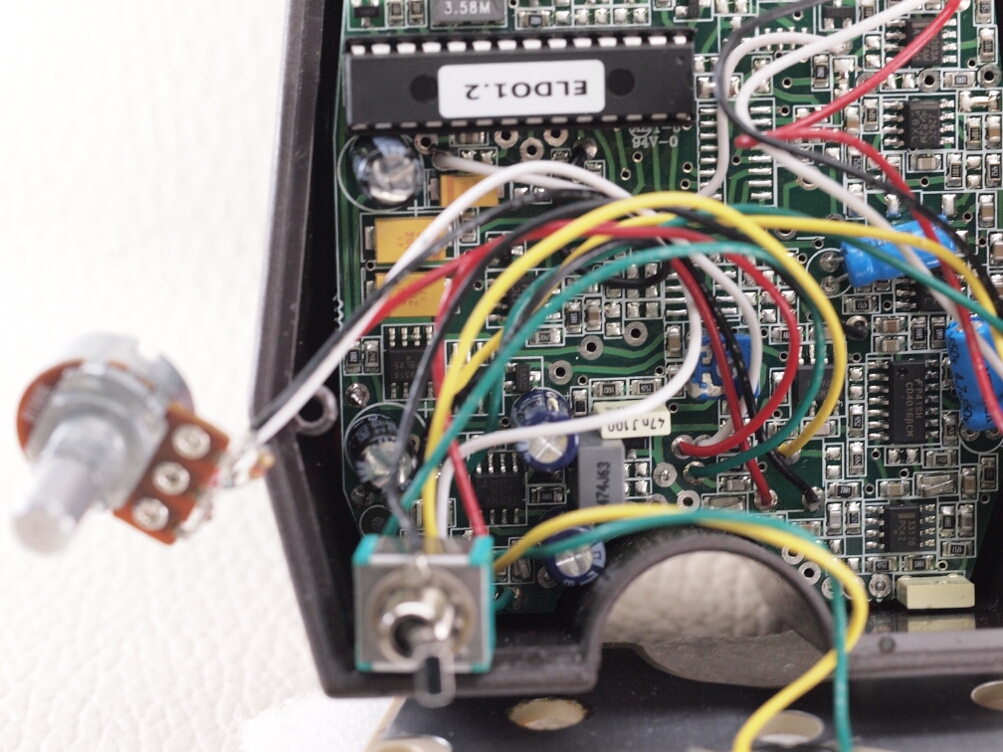

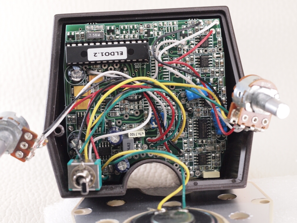

    Hi all.
    Can you tell me modification to give more sensitivity to a Tesoro Silver uMax?
    Thank you very much.
    hello,
    welcome to the techers' forum.
    in my pale opinion you may add treshold and ground balance pots at its housing.
    can you send me hi resolution pics of the board under good light?
    my email [email protected]
    kind regards
    Anatloy
      Anatoly thank you very much, any help is welcome
        Obolo si usted puede ayudarme a llenar mi archivo de la información necesaria.

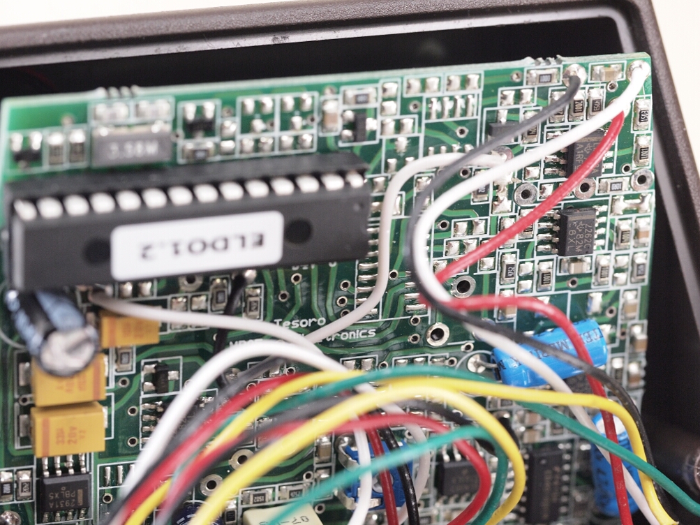

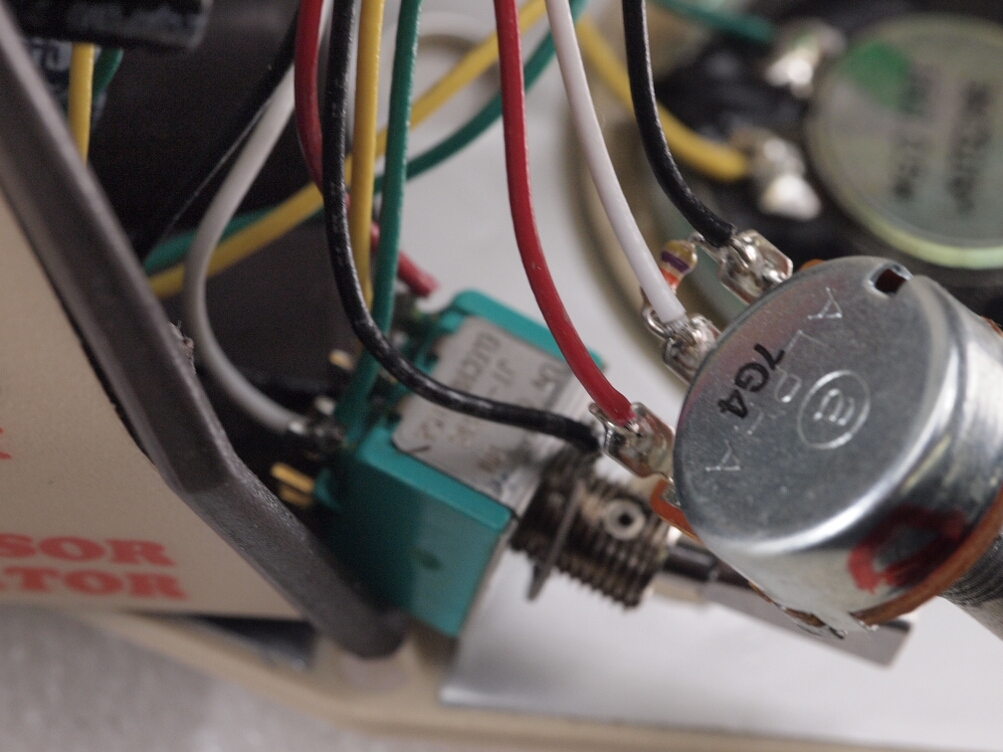

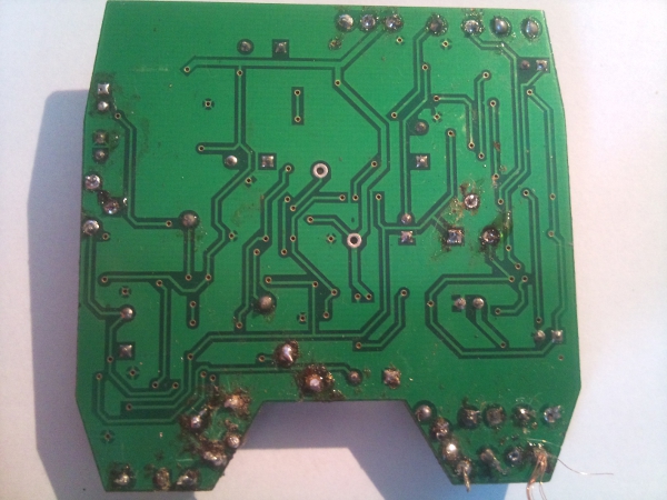

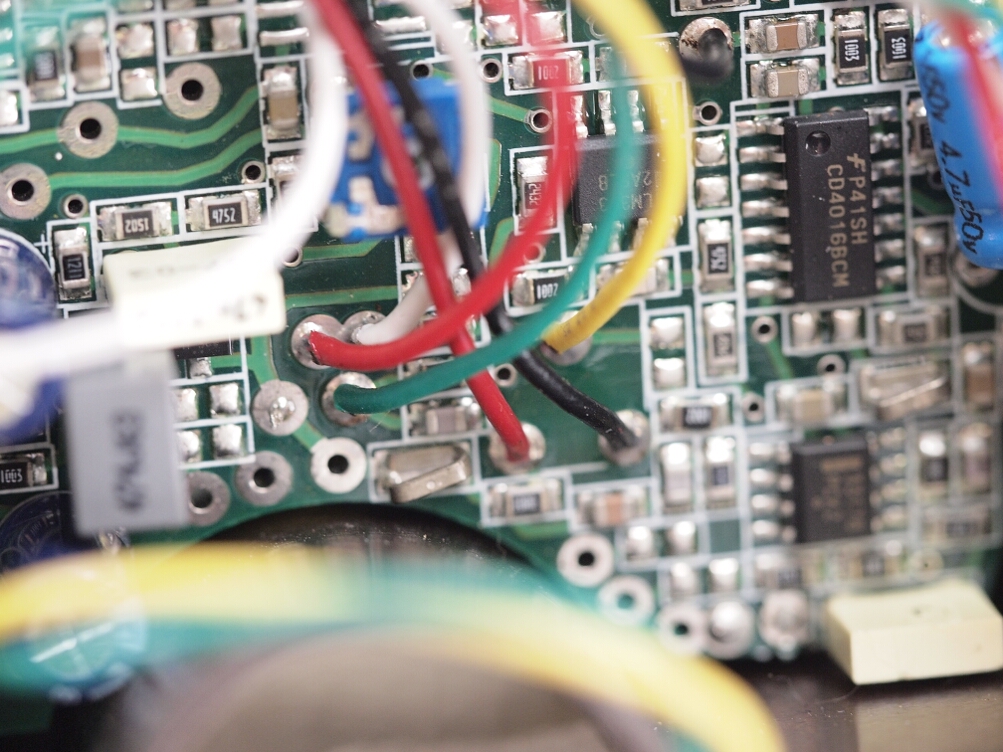

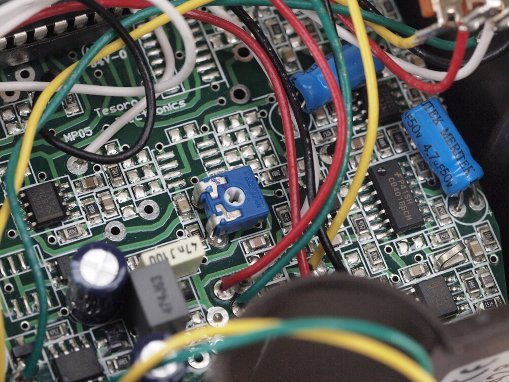

          Obolo, your pics are blur ((( but resolution is nice!
          can you turn your camera in Macro mode, at first (flower sign)? At second, can you zoom image on maximum? (i mean the optical zoom, NOT DIGITAL).
          thank you!
            I have only the phone camera, are the only pictures I can do.
              try read this thread
              http://www.geotech1.com/forums/showt...lass-uMax-Info
              FatBob made nice job, your detector has full similarity. i did give there schematics.

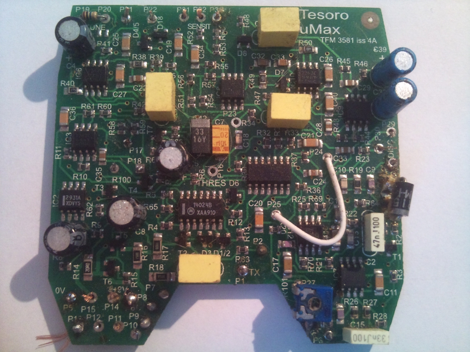

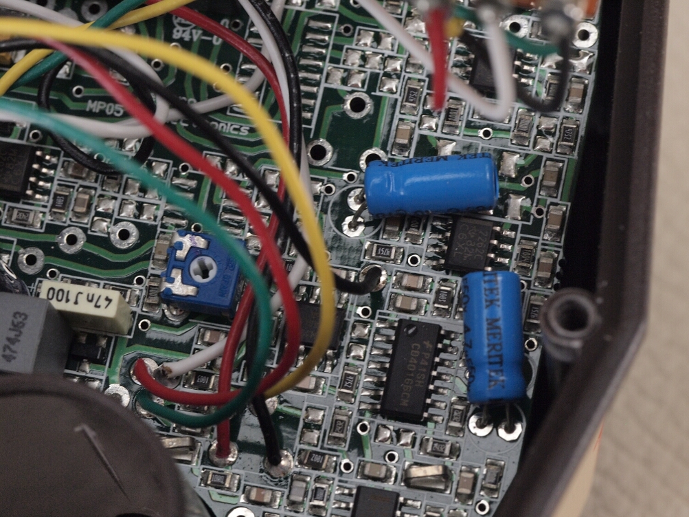

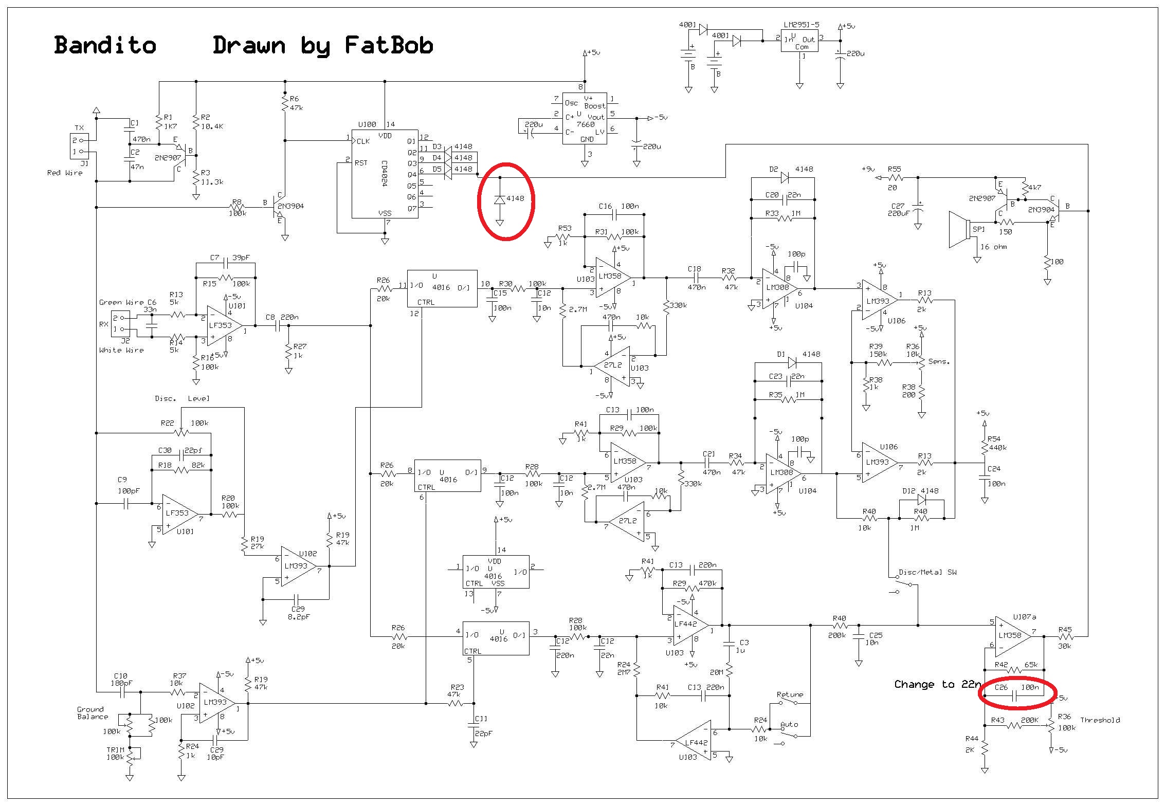

                I messed around with a Bandito for a while and the two things that definitely made a difference were
                adding a diode to the 4024 diodes (this added 1/2" depth) and changing the filter cap on the last LM358
                (better sens). See this schematic;

                  I found test on the Bandido to be insistent with air tests in the house.
                  The auto tune in no motion mode it badly affected by electrical interference in the house and throttles back the threshold with the result of poor depth.
                  In discrimination you can run the sensitivity at 100% and get an extra inch or so by waving a coin at the same speed as chirps and you will get a solid beep every time but you cant't run the detect this hot in the field.
                  In the ground I get the same depth as air tests in the house even though I am running it less hot.

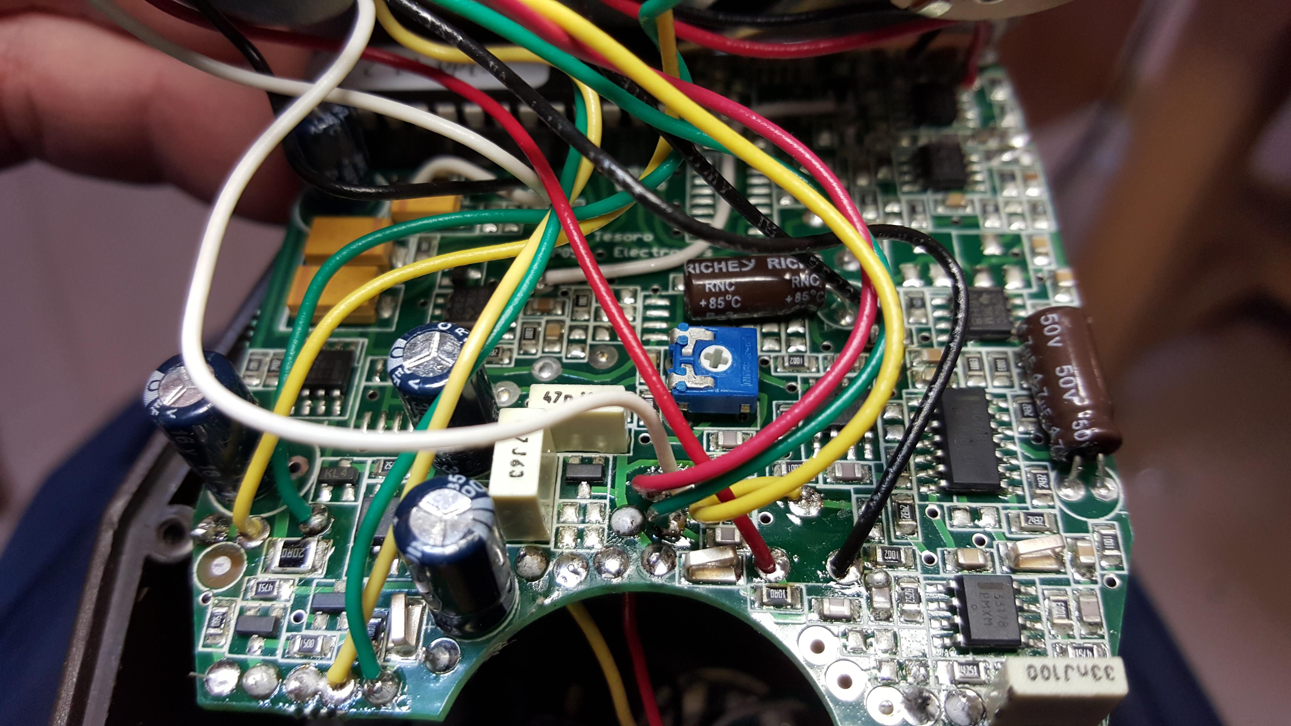

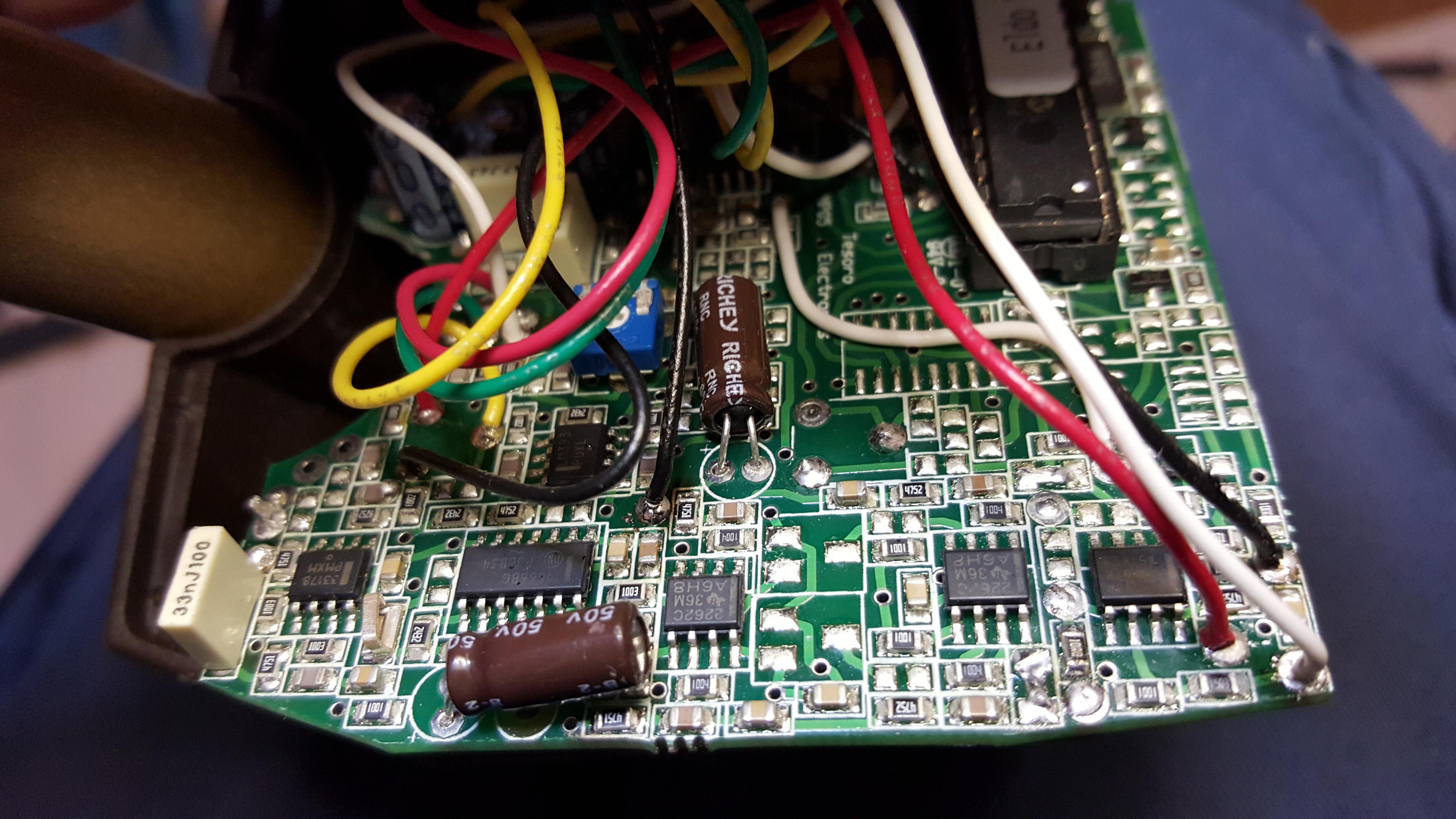

                    Eldorado is the PCB

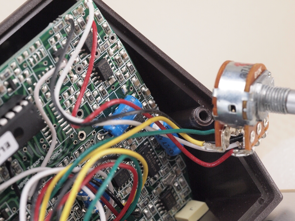

                        Obolo, your pcb looks another than silver umax i did guess. your is u-chip based. kinda of something modern -?

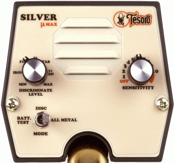

                        so you need in another specs... here my pics on clear analog silver umax.

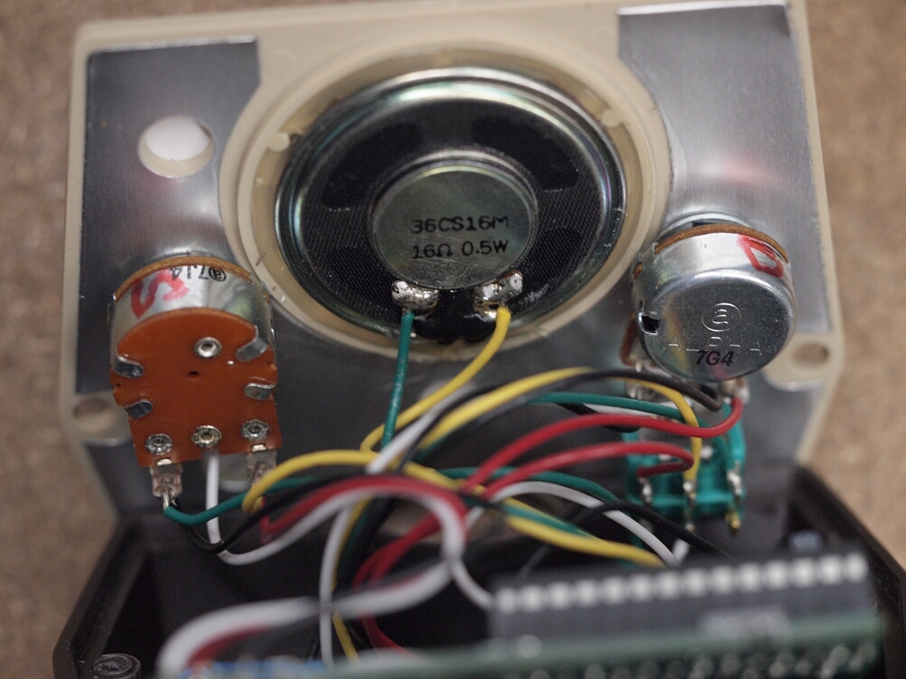

                        can you also upload a front panel pic?
                        TIA

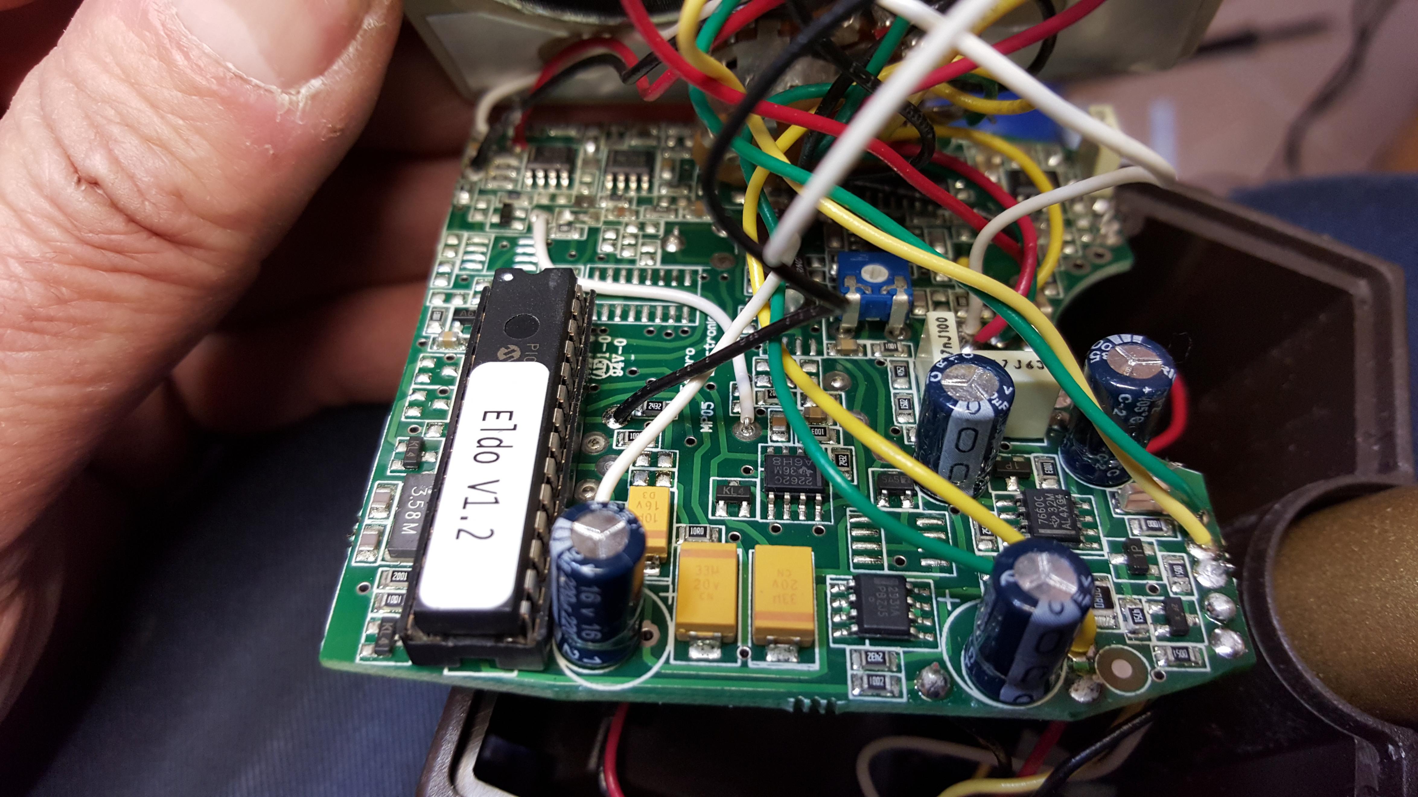

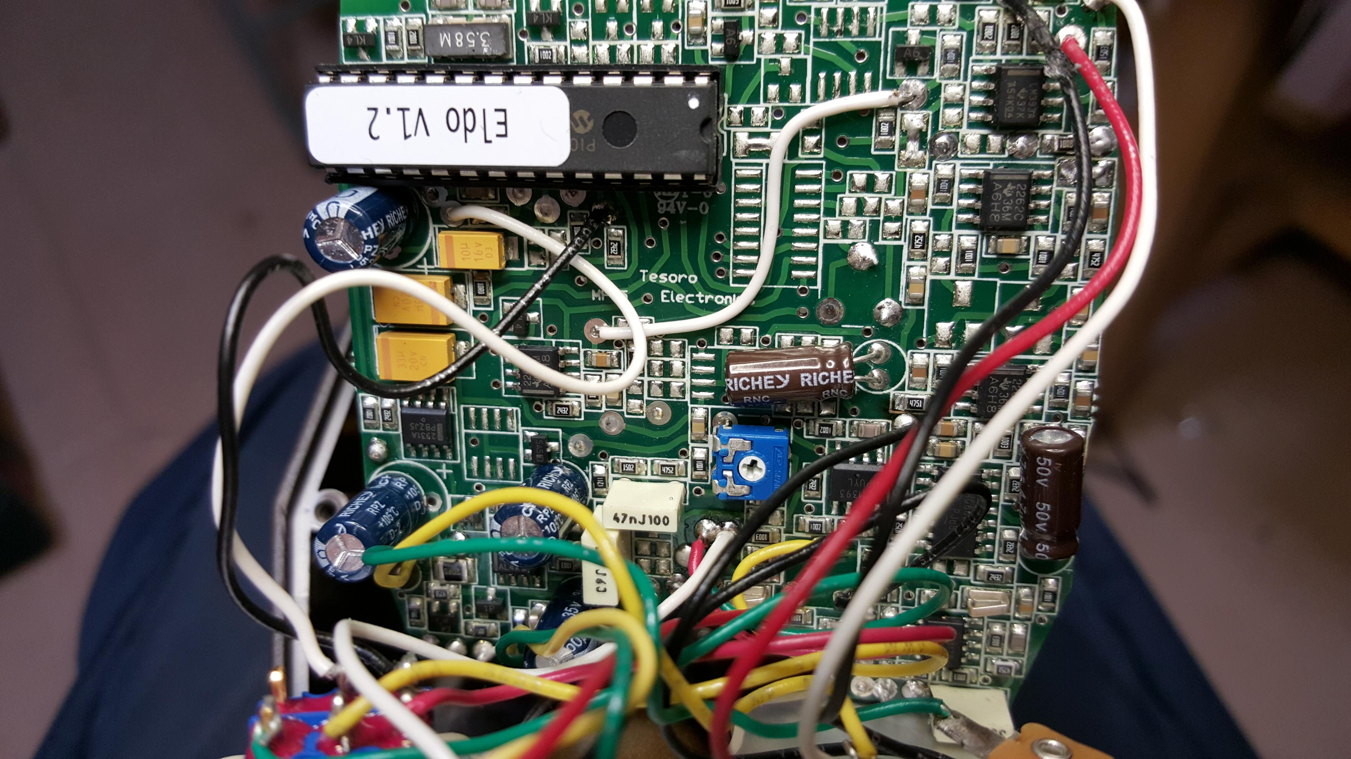

                          You will find the Eldo IC in most of the models.
                          Here's some pix of the current Silver Umax

                              http://www.findmall.com/read.php?44,2266892
                              silver uMax with GB mod.
                              YOUR issue.
