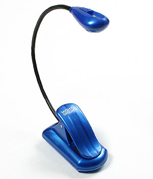

                  an easy way to do it would to be buy a book light or some thing similar and velcro it to the detector.
                    thanks Skippy your a champ think I get it now thanks hey shouldn't be to hard to do just needed to know the ins and outs.
                    thanks Cadmaster375 also.
