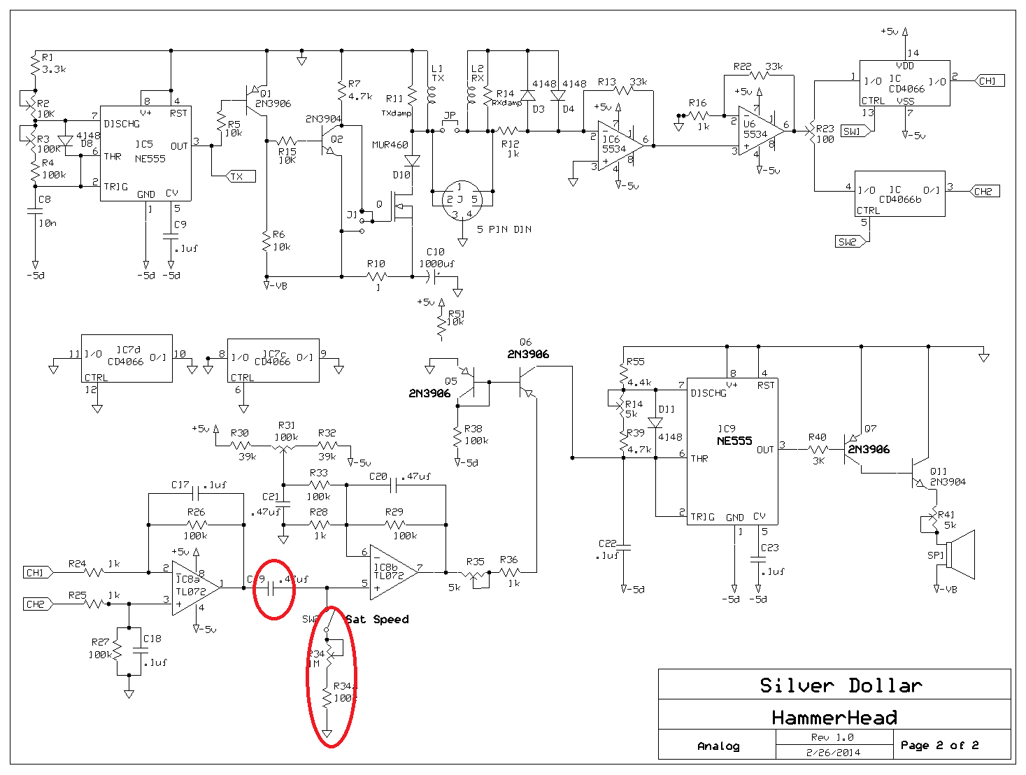

    Can anyone tell me if a VSAT can be added to the Surfpro?
    I realise the SMpro and HH are different animals, but would it be achieved by replacing R21 with a pot??
    Also any suggestions for simple changes for delay/width/sample, like a pot for an R,(or delay pot change) with small gold and a fast coil the goal? This may have been covered, but I'm still searching.
    It is pretty bloody good as is, but all input appreciated.
    How about DD cofiguration? Inductances? Damping? Any starting point suggestions???
    My Tacoma56 DD is great with the ML Commander 10x5DD, but I want to etch another board, not sabotage my good one. I could dismantle it to check, but from memory it is 680 or 390R damping on TX(?) and none on RX.
    Perhaps R8 needs to be variable?...Anyone??

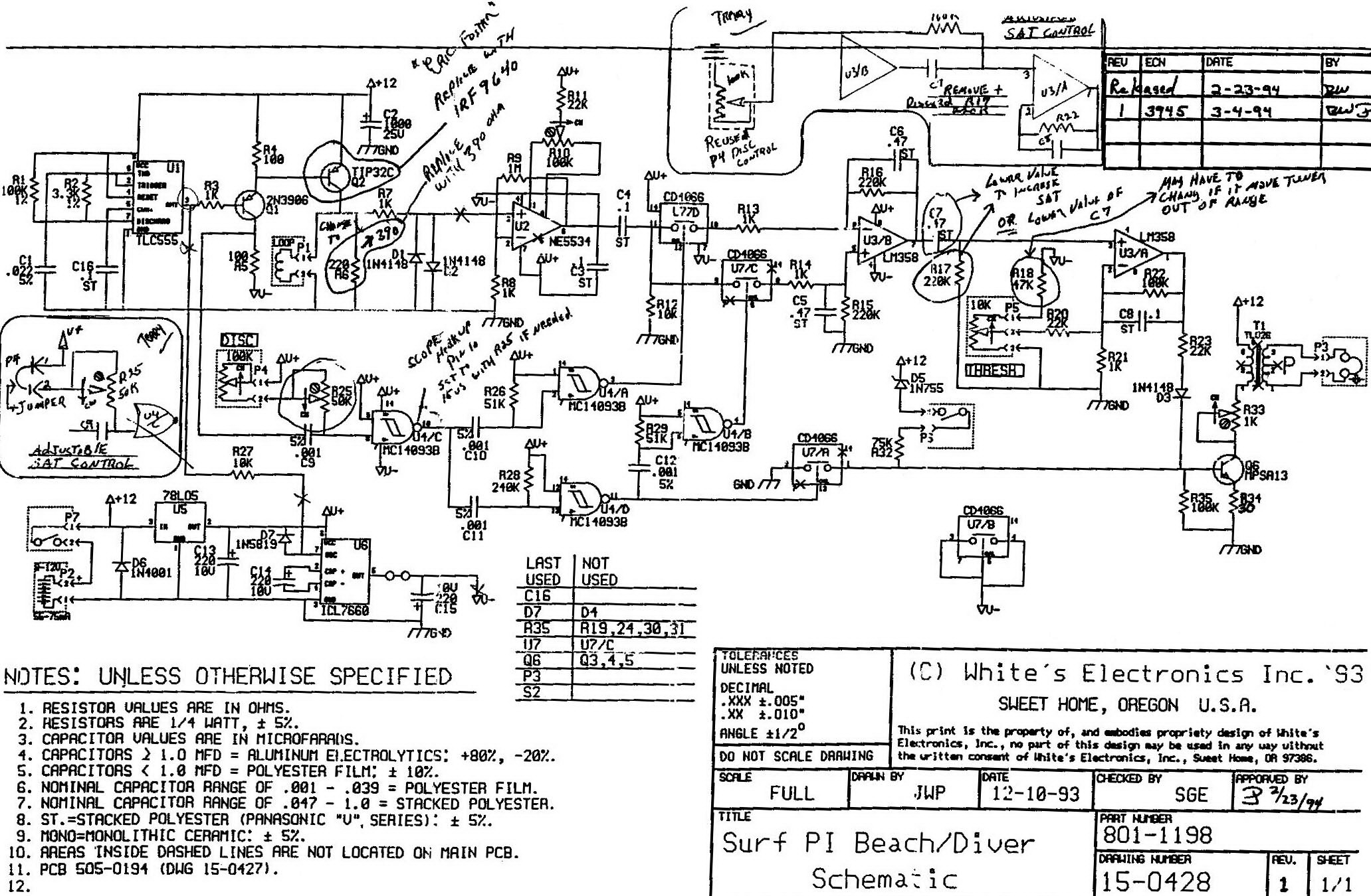

      That schematic is totally wrong. Carl has posted the REAL Whites one. Work from that and you might get a better idea of what is going on
        Thanks Sean. I have several SMPro schematics from here, but never compared them. Perhaps the one I posted came with my Tacoma56 board....? I'll have a gawk now.

          VSAT HAD been added to the circuit HUGE TIME AGO. thats name is 'TERRY' MOD'.

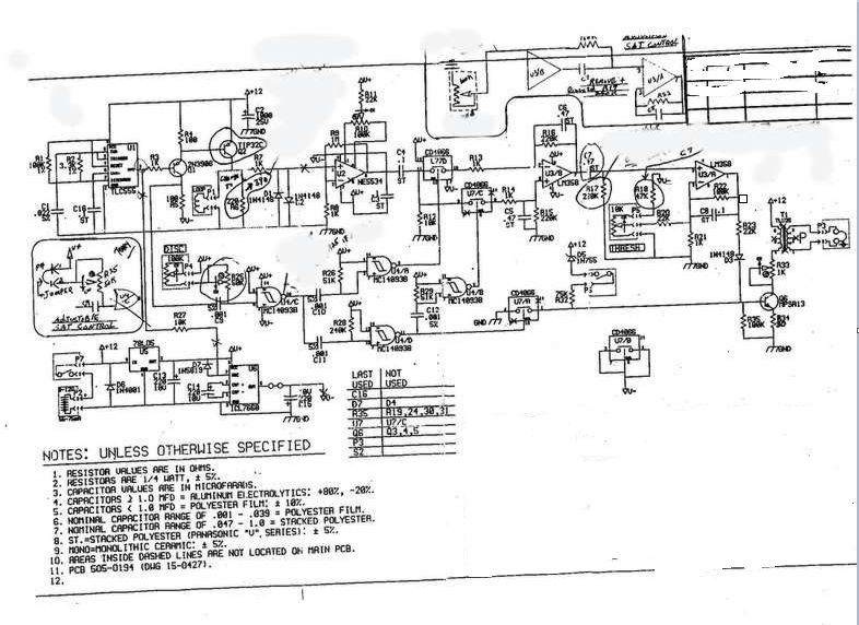

          TWO MODS - Eric Foster's mod and Terry's mod (2 MODS). note that anywhere at wall if you are not able to remember -!
            D'oh! I had this info already! Lots in my SMpro file. Just needed to have a womans look. In answer to my own question-
            Looks like 100K R(?) to a 100K pot, to earth, after C15 on original schem, which is 1uf on original and 470nf on others.
            Do you think this would work Sean?

                Thanks KT-a higher resolution pic than I had.

                    I used the http://www.geotech1.com/forums/attac...0&d=1470742814 VSAT mod you posted, works very well. I also playes with the integrator values to optimise for my style of searching (fast).
