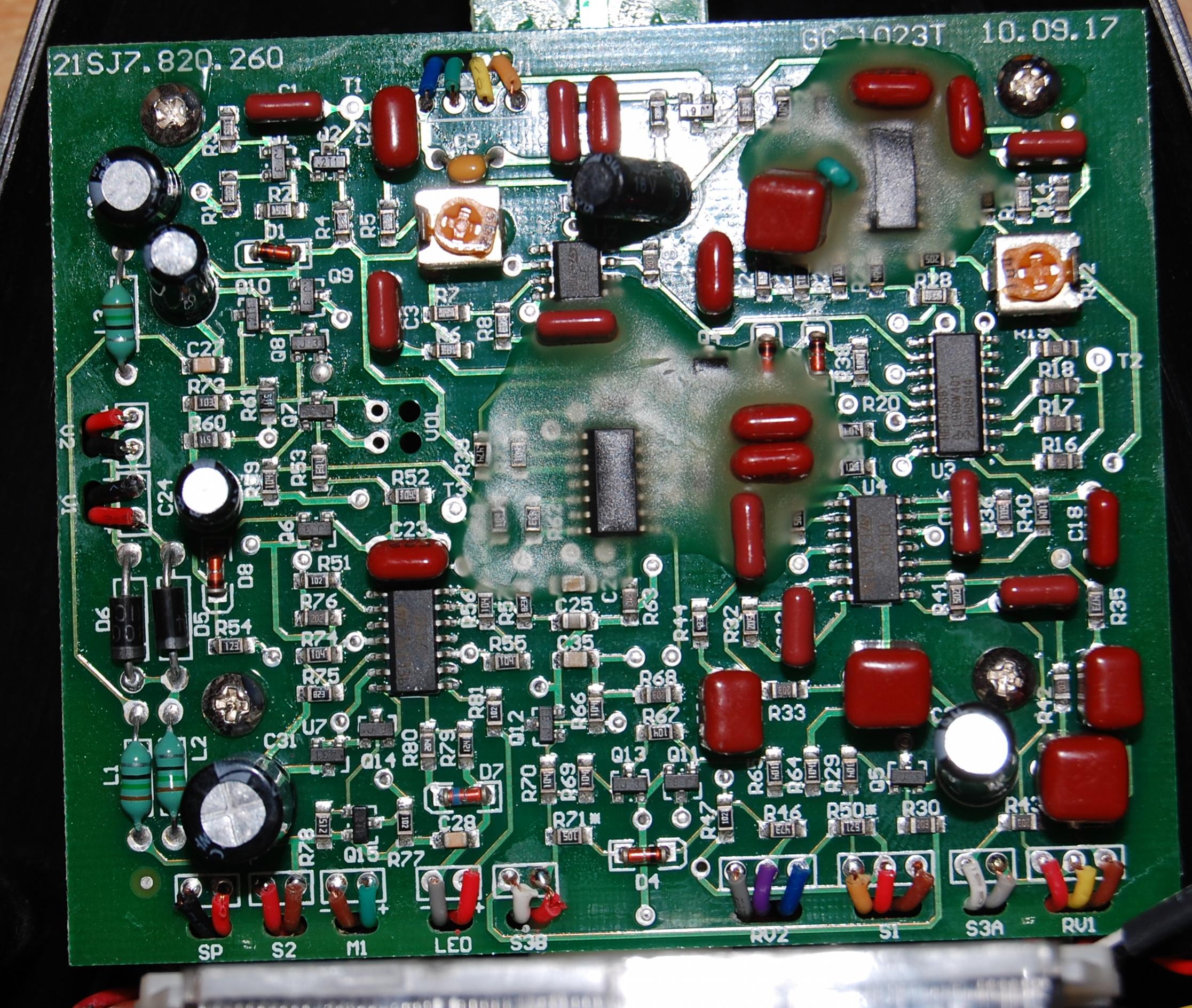

    Greetings to everyone. New to forum. I want to build the GC 1023. Searched for schematic with no luck. I only have pics of PCB from this forum. Does anyone have a schematic of this detector? Top side foil is obscured by components so it is difficult to reverse engineer schematic. I suspect it might be a clone but not able to match it to any schematic. Any ideas would be appreciated.

        dbaner, can you write what chips you see at the board? part list?

            i have a digest of good pics of the board... do not see some ICs mark under a glue...

              The chips are as follows: 3 TL064's, 1 LM339(that's the one obscured by glue), 1 CD4053 and1 LM339. This detector has a tone discrimination notch mode whereby everything to the left of where u set the disc control gives low tone, and everything to the right gives high tone. This is a nice feature. It has the same functionality as tracker 4 but the chips used are different Hence circuit is different. The detection depth is purported to be good, and they are no longer dirt cheap. The price is closer to $200 plus shipping. I happen to have a spair discovery 2 coil that would be perfect fit since it operation at 6.6khz or thereabouts.
                in DIP-8 probably is not LM339? i see 393 there above of pcb. give pls numeration of the chips marking, for example -
                U2 - LM339, U3 - TL064 etc.
                please be more due to electronics general rules if you give the information.

                    OK. U1,U4,U6-TL064, U2-LM393, U5-LM339. These are from through hole board. Then there is U7 which I saw somewhere listed as TL431.
                      U5 cannot be LM393 since this is an 8 pin DIP. It is LM339 which is a 14 pin IC. I have a picture of PCB from this forum with glue removed. It shows U5 as LM339. Anyway, I like building vintage MD circuits. I learn a lot while improving my skills. Right now I am building delta pulse(single side PCB), and a whites 6000/d series 2 on strip board. I have also completed 5 other detectors. So you see I'm relatively new to this as compared to others, but you have to start somewhere. Can't seem to figure out how to upload pictures.

                            It's a (simplified) Fisher copy - best match: 1235
