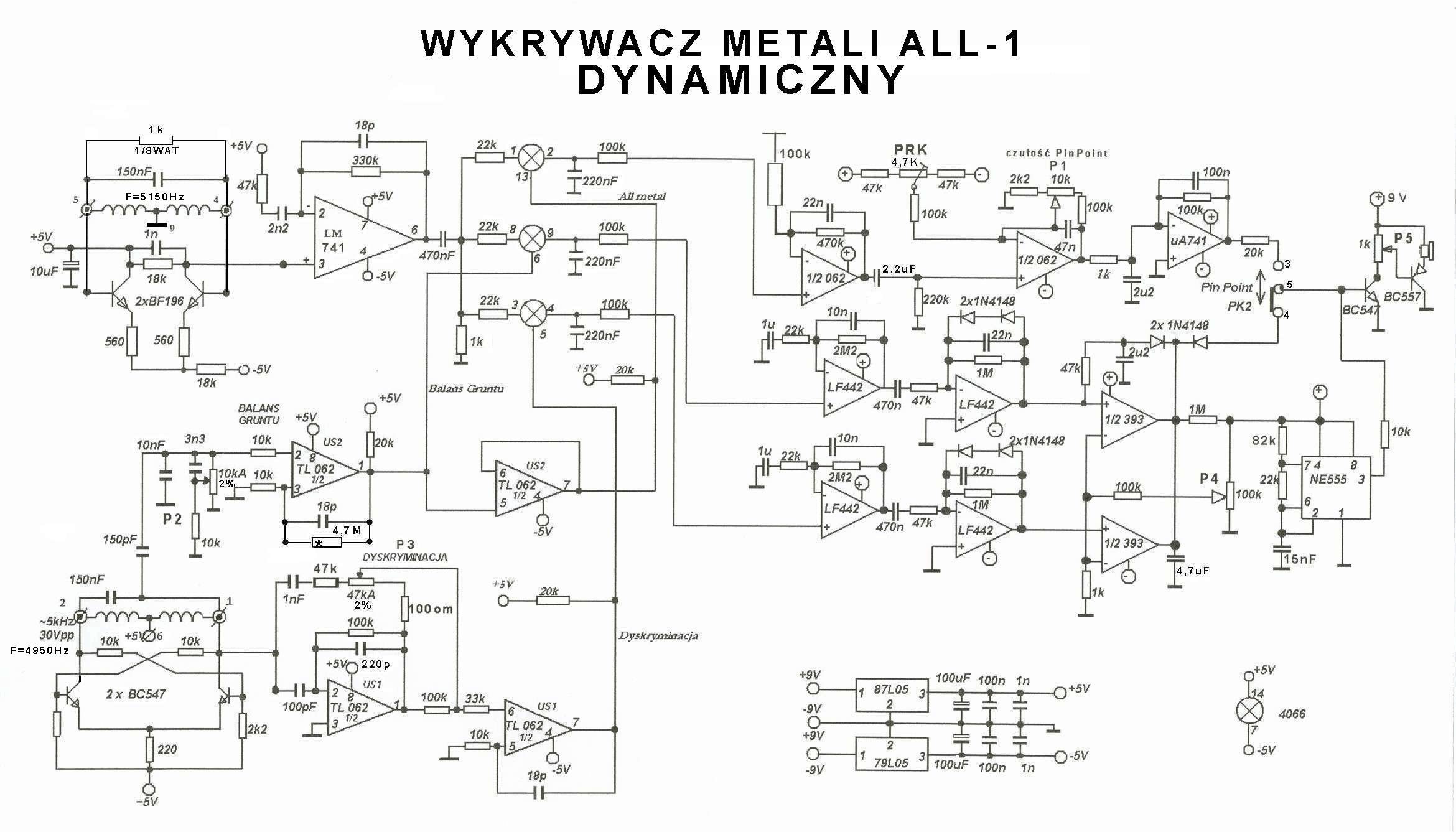

    you have to look to side of ALL-1 detector, it is polish schematic based on 555.
    so without radical board change on new one you will do nothing.
      I thank you for having responded to me, but I did not understand what I should do, you can change the tr \ discriminator circuit to make it work in VLF? tanks

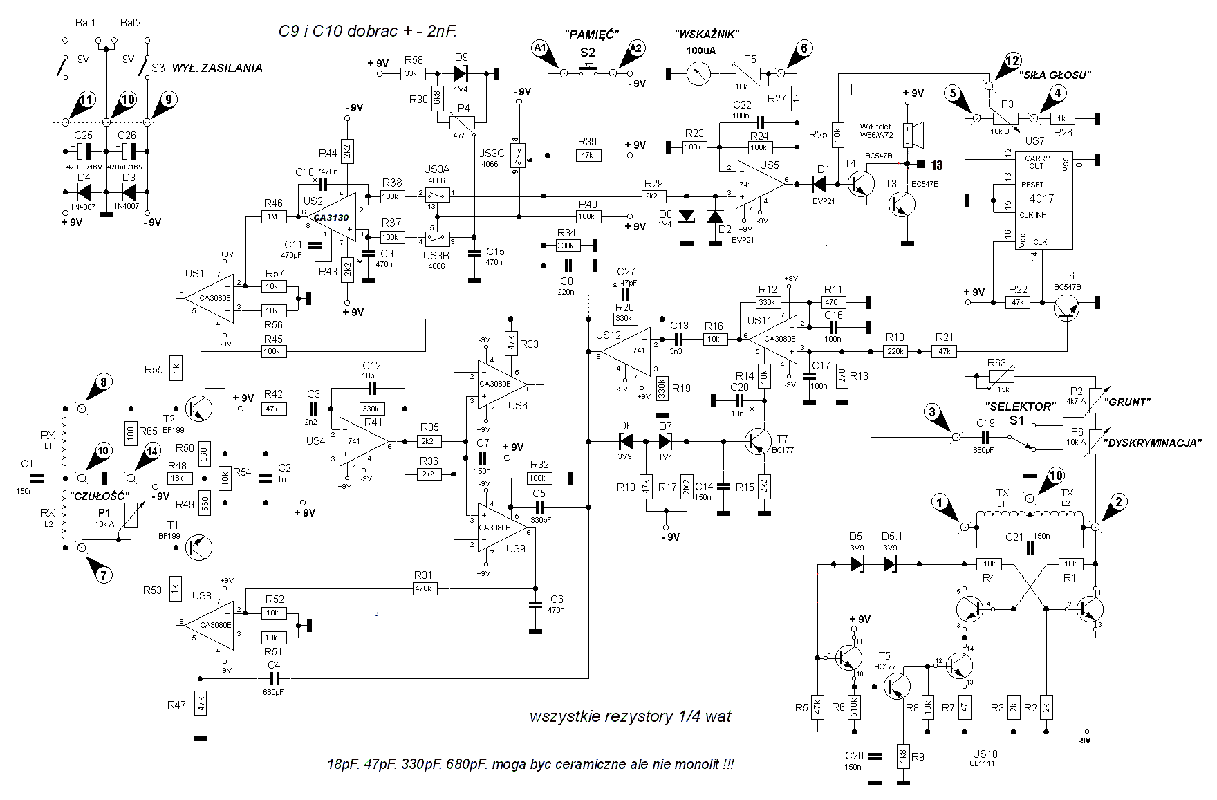

        ok, i give TWO schematics. one is fisher 555, another is modernized 555. you can compare both and
        see what you have to do. by another words, you have to choice your, optimal as you think, way to change 555 on VLF.
