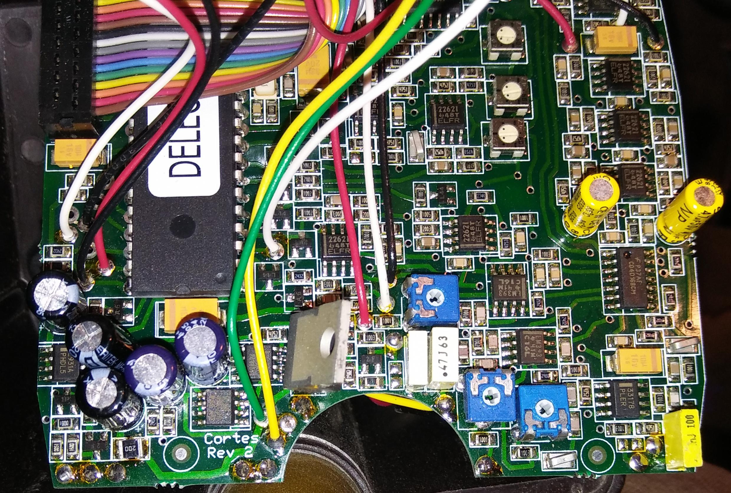

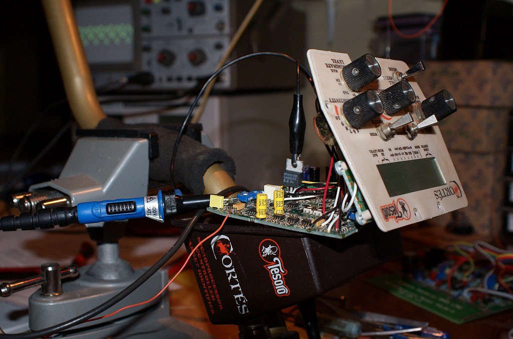

    Was wondering if anyone has pics of where the Cotes connects the back-light to the pcb? The DeLeon obviously has a back-light thats not connected, and despite all the pictures I've seen of the Cortes, none show the connection to the pcb.
    I've see the resistors on the Cortes switch that makes me think its just connected to the on/off knob...?
    Thanks for any help.

      Well it was more a question if someone had the pics of the Cortes which I dont. Here are some that I found that like I said dont show the connection.. Im guessing its just connected to the power switch and a couple resistors knock it down to 5v.
      and I'll got take a picture of my DeLeon pcb to give..

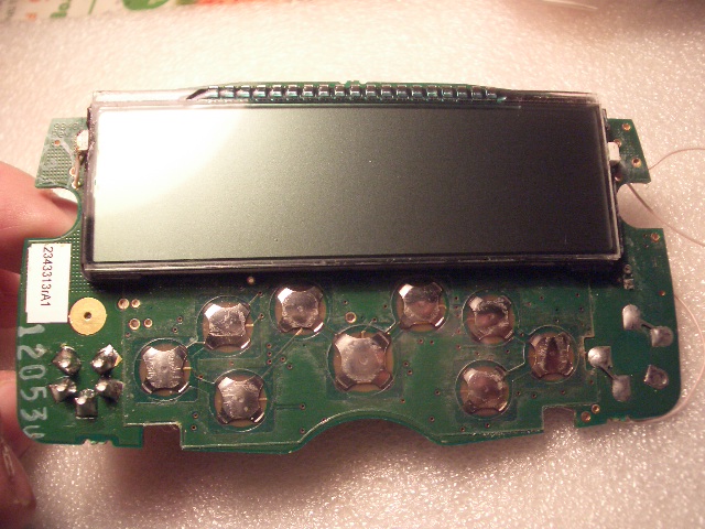

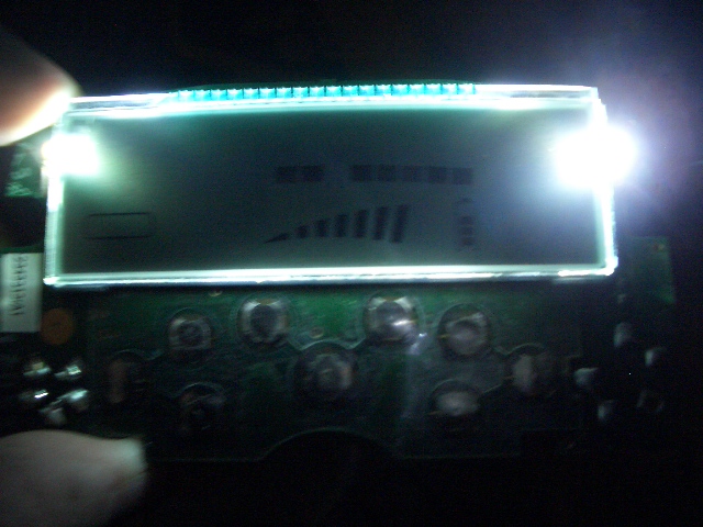

        i made back-light for garrett ace 250... main difficulty i met there is not free place for LEDs...

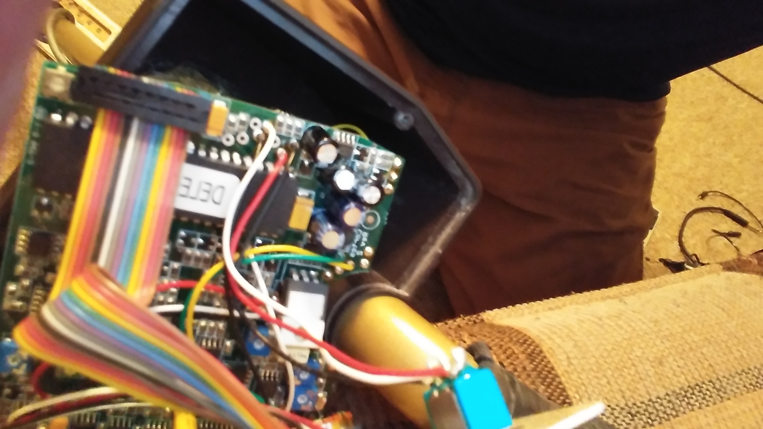

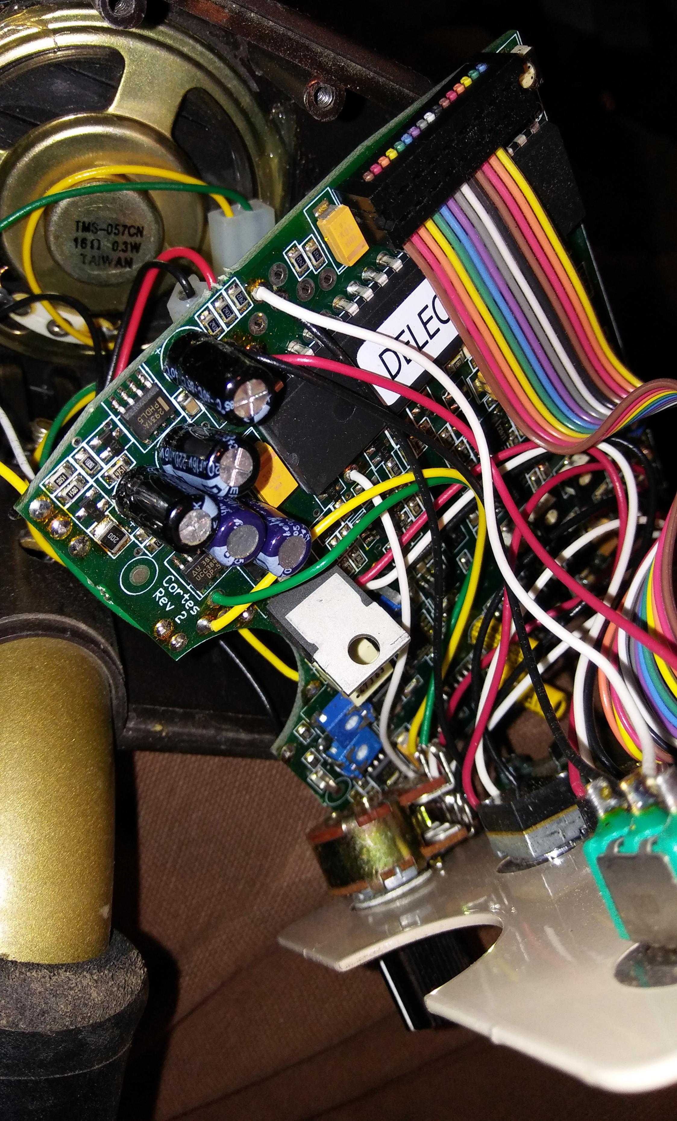

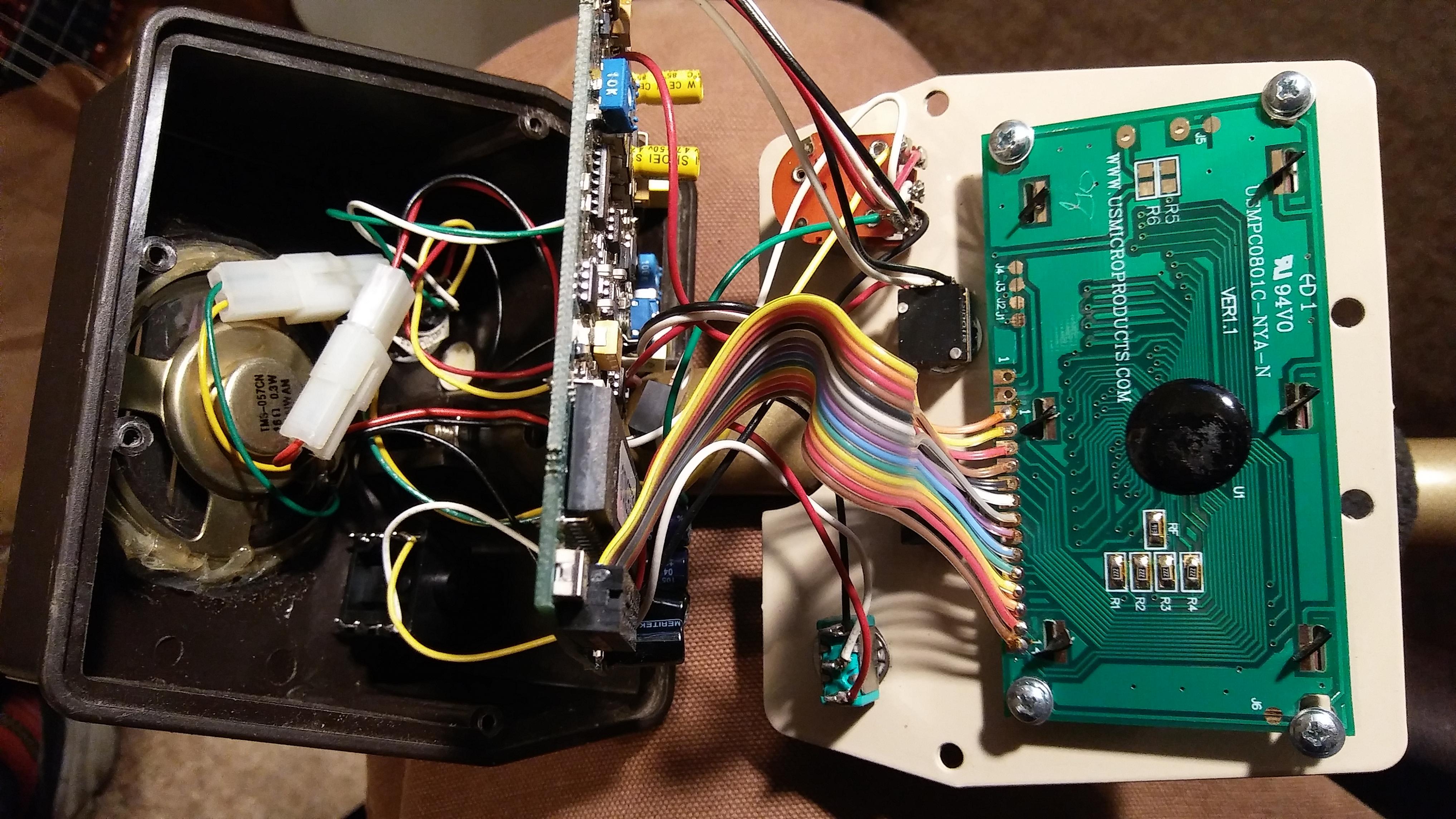

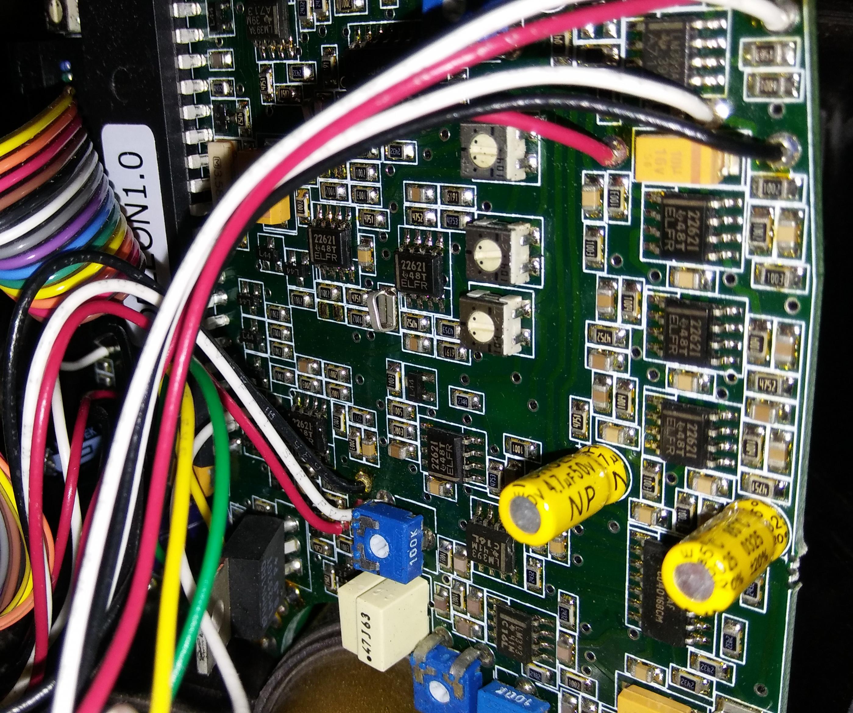

            On your second photo. The lcd module on it's left side has two square unsoldered pads. Labeled "A" and "K", these are the backlight connections. The A goes to the battery plus and the K to minus. Add a series resistor to limit the current.
              For kt315 Click image for larger version
              I have better coming..

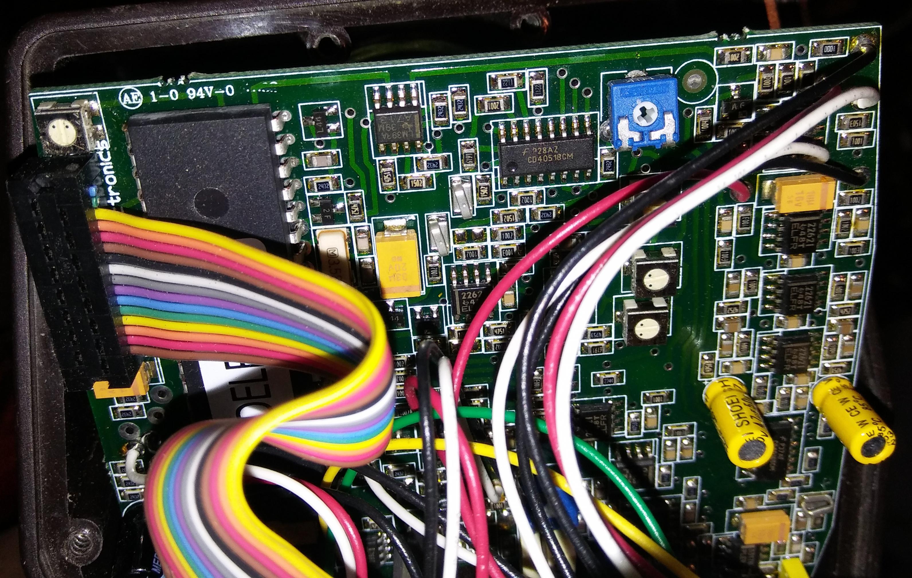

              The lcd on the deleon is a little different but I'm thinking its just pins 1-2 out of the 16 that are in the normal lcd connecter.

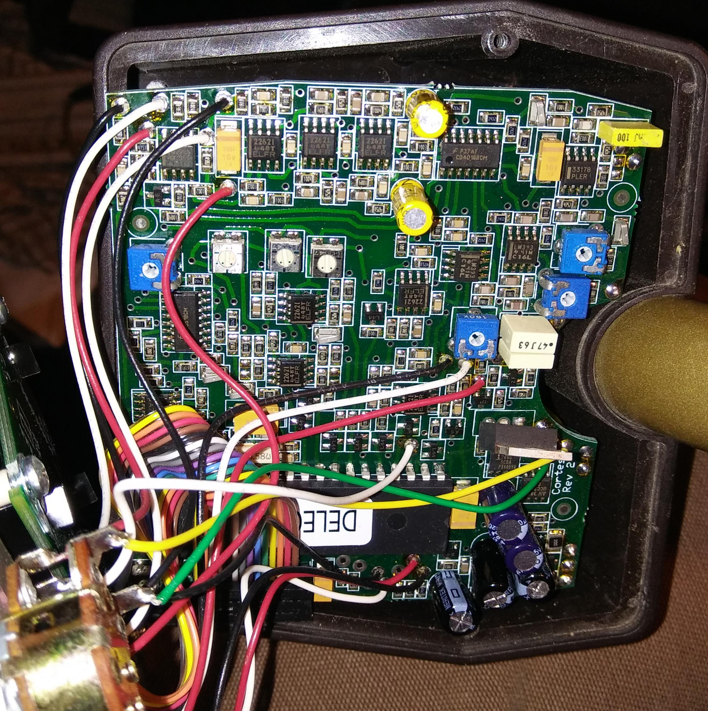

                I give.
                  Thanks will give it a shot this way.
                    [ATTACH]38079[/ATTACH][ATTACH]38080[/ATTACH]
                    I have an ace 250 with backlight too..I used Christmas light leds.. very cheap.

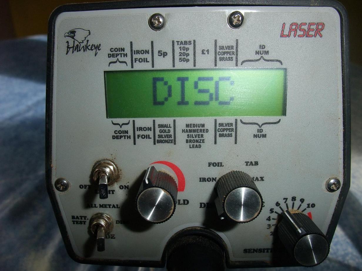

                              Wonder what the Hawkeye has in it?
