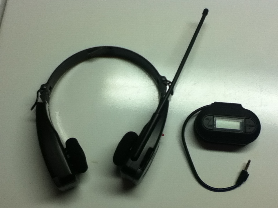

    Well since I cannot detect I have been keeping my interest by researching new locations and last years finds and keeping my eyes open for upgrades for my detector. I finally got a cheap DIY setup for wireless headphones. I bought the FM transmitter on sale for 40% off ($8 at Canadian Tire) and the am/fm radio headset at a second hand store for $4 after some indoor testing on other devices it seems to work really well so far and the only negatives are that the fm transmitter uses AAA batteries and the Headset uses AA and that the volume is a little lower than I would like. hopefully they will work well on the detector

    I've done that before. Worked ok for me.
      Any latency in the audio? Sometimes the digital transmitters lag a little..
      Don
        Could you not do a little engineering and make the headphones run off AAA as well?
        Are the headphones loud when tuned to an FM radio station? If so, the lack of volume may be caused by the transmitter, rather than the capabilities of the headphones.
        I have one of those transmitter units sitting amongst my detecting-related junk, I must get round to having a play with it.
          The Transmitter needs no Battery. You can power it via the Head Phone Voltage. That's what I did. Google line powered phone bug.
            After some time in the field with the wireless setup. I find it works good with little or no lag. getting the right frequency for the FM transmitter and headphones is the biggest pain that and a little static. the waterproof box i used for the circuit board is just large enough to also house the fm transmitter so the whole thing is waterproof.
