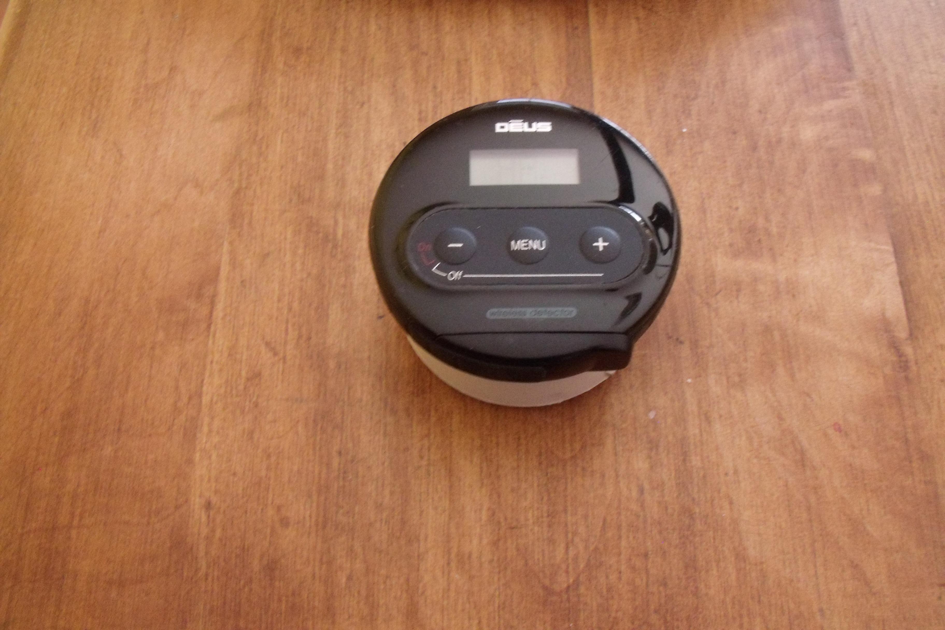

    Since i dont own a Remote, i wanted to use my Ws4 on the pod. I already own a deteknix wireless headphones

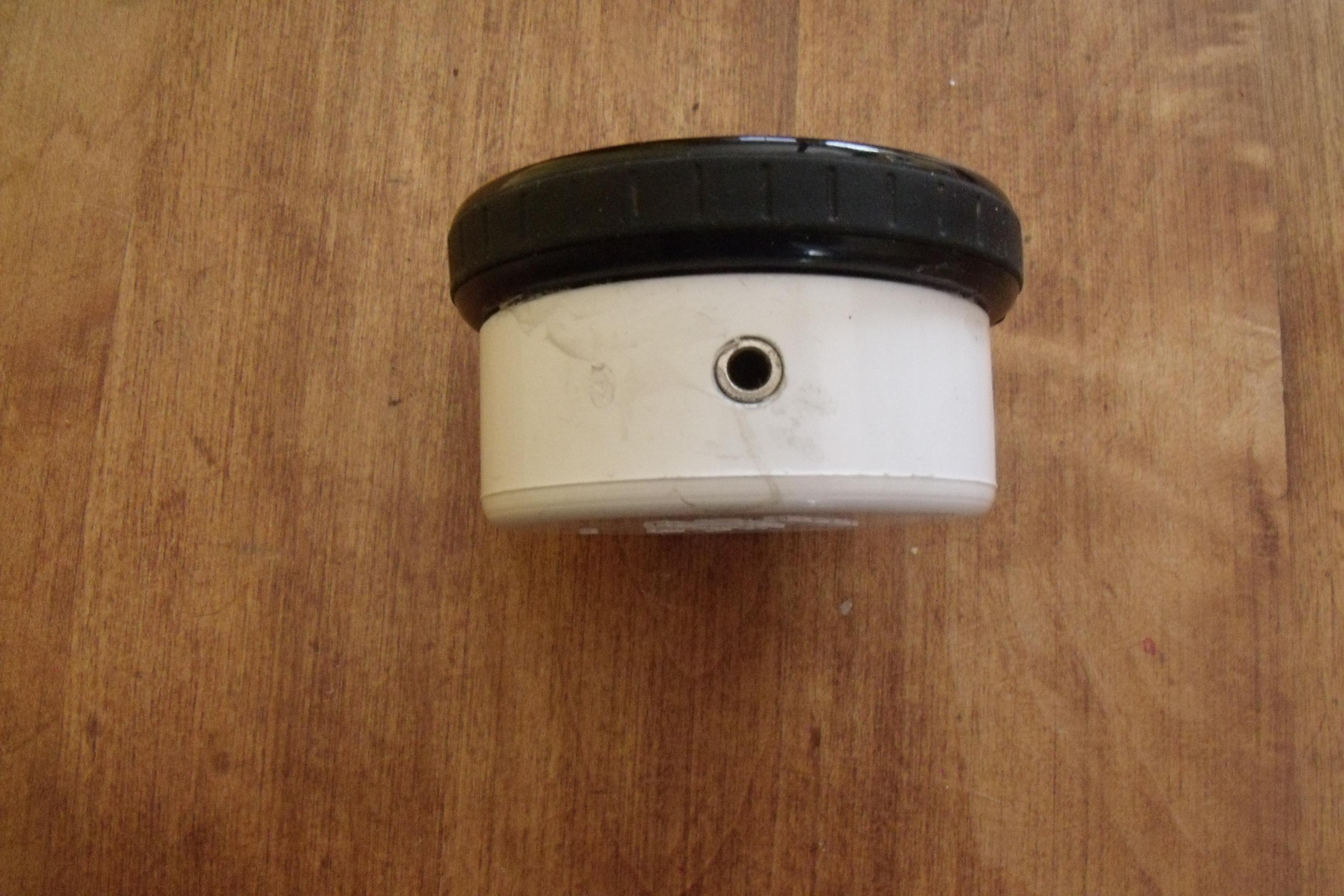

    First i unsoldered the big jack from deteknix to use a 1/4 male instead
    Then i desoldered the wire from the XP headphones and soldered the 2 wire to a female 1/4 audio input.
    Used a PVC caps
    Not shown, i glued with epoxy a supermagnet under the PVC and on the Deus i glued a small metal tin
    This is now my remote so i can see the VDI and have some control without removing the headphones
    nice job, never understood why no-one did this before?.
    for that matter it would not hurt xp to release something like this for lite users on a budget.
      Nice job.
