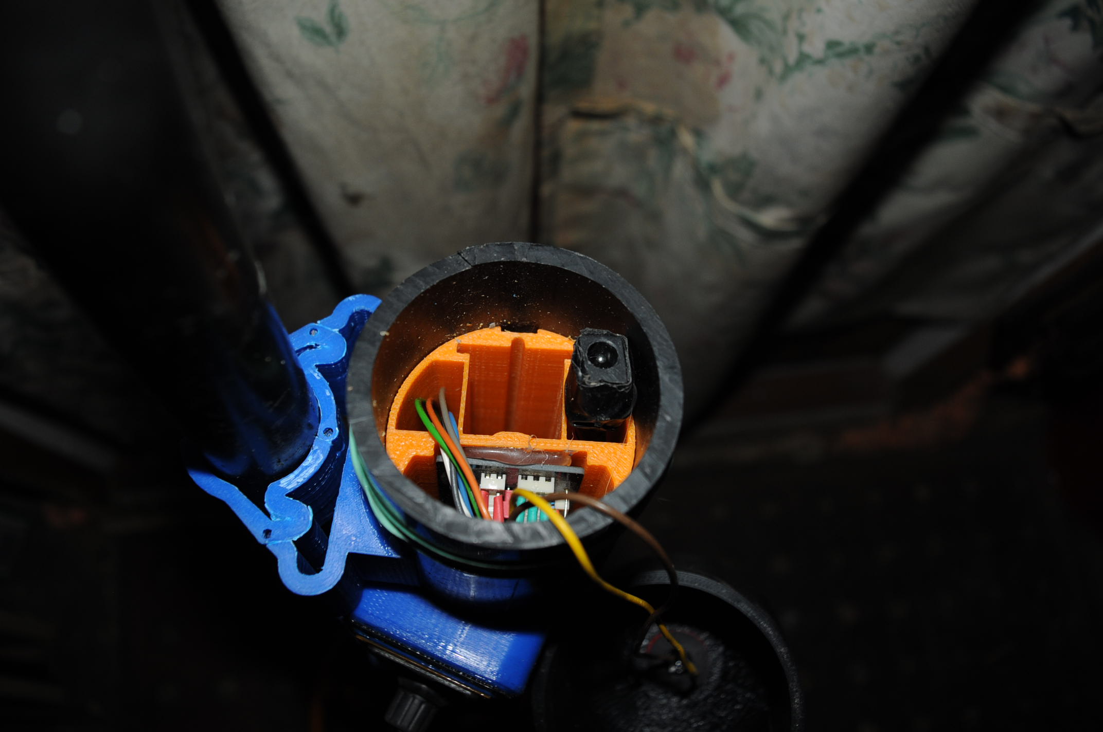

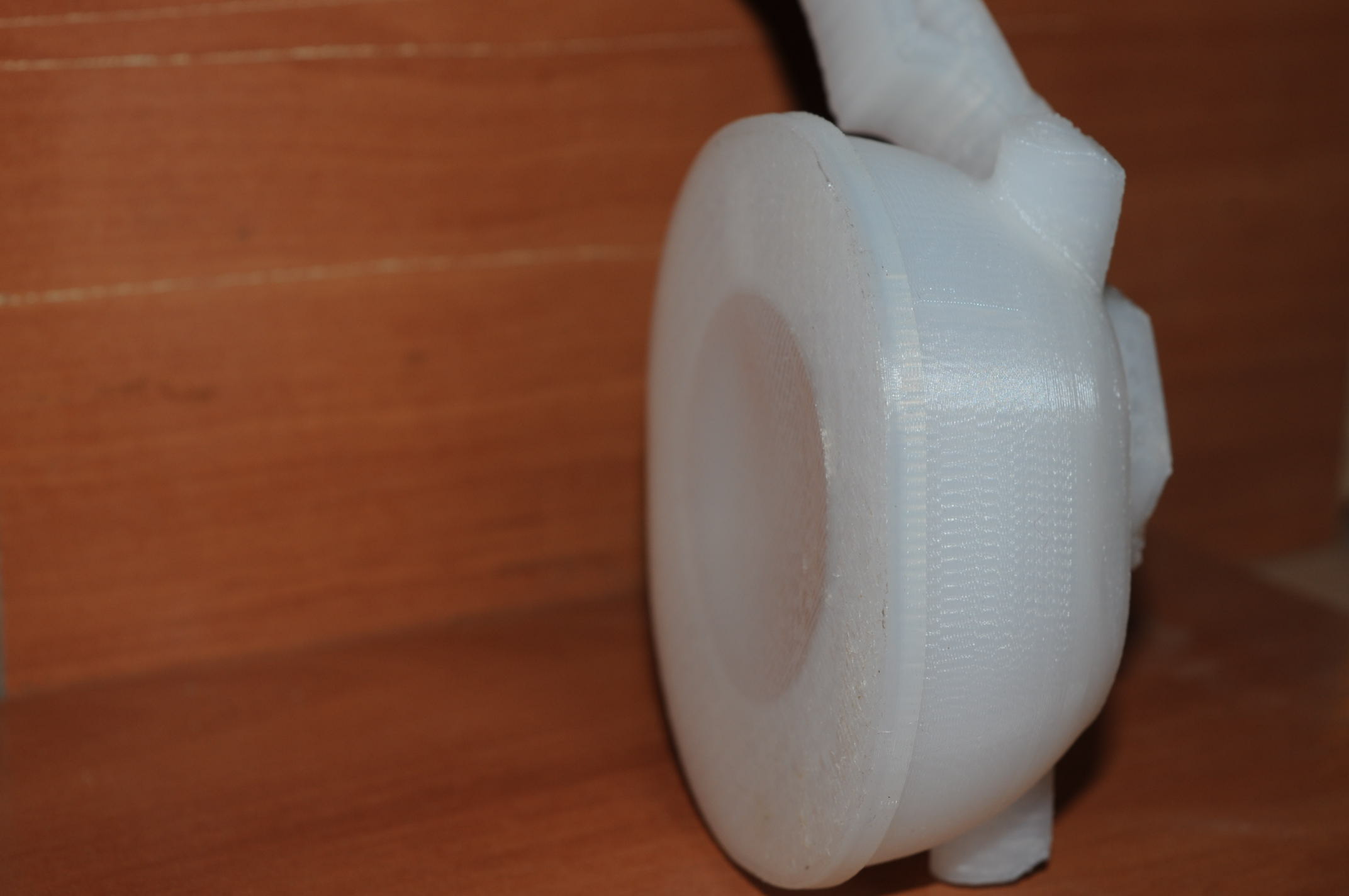

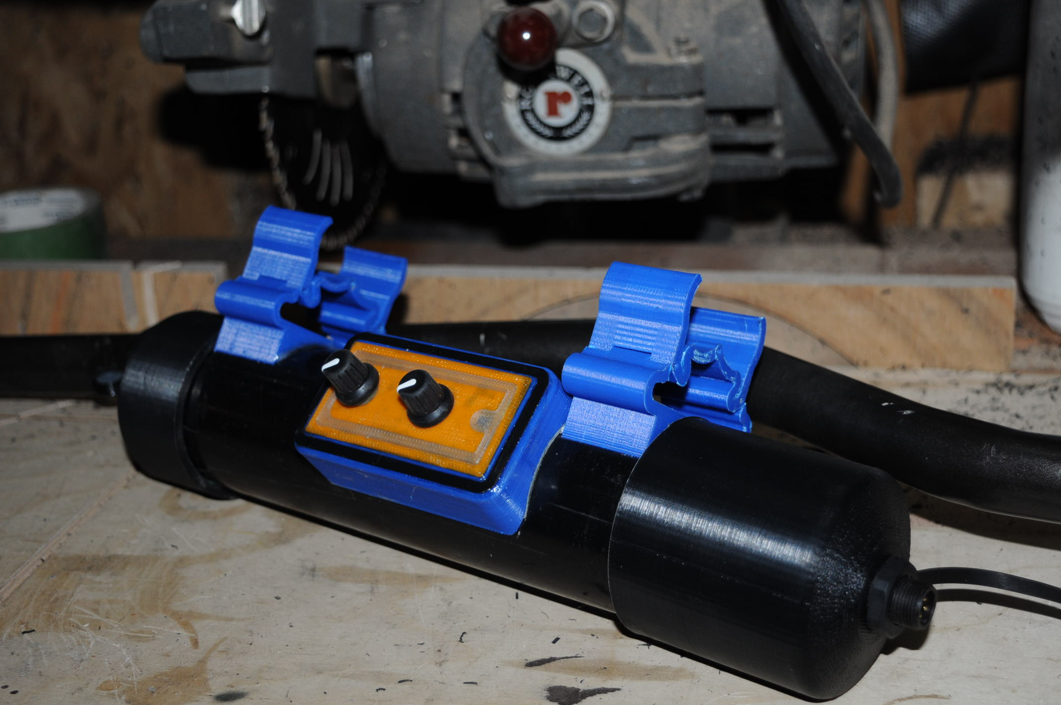

    I design a 3d printable water resistant submersible headset based off an existing 3d model, I wanted to post in here in case it could help someone out. they were printed with a nylon base filament call Bridge which is chemical and heat and water resistant filament made by the fine folks at Taulman which BTW, they have excellent costumer care, you can buy from the direct, just send Tom a email at [email protected] .
    I will provide the STL files that can be found here http://www.thingiverse.com/thing:2131268 everything is all snap together fit, I ended up using 55mm 0.2 watt 32ohms speakers which I salvage from a bunch of old telephones, They are more then loud enough for me.

              Curious how 3d printed box perform as watertight?
                If one was to print a 5 sided box and a face plate with your bottom layers and top layers to match well with your infill the layer bonds will be water tight, If you look at the photos it's PVC Tube with a cap on both ends that were 3d printed out of ABS, i only used a O Ring on the inside of the caps for tight seal but it is fully submersible.
