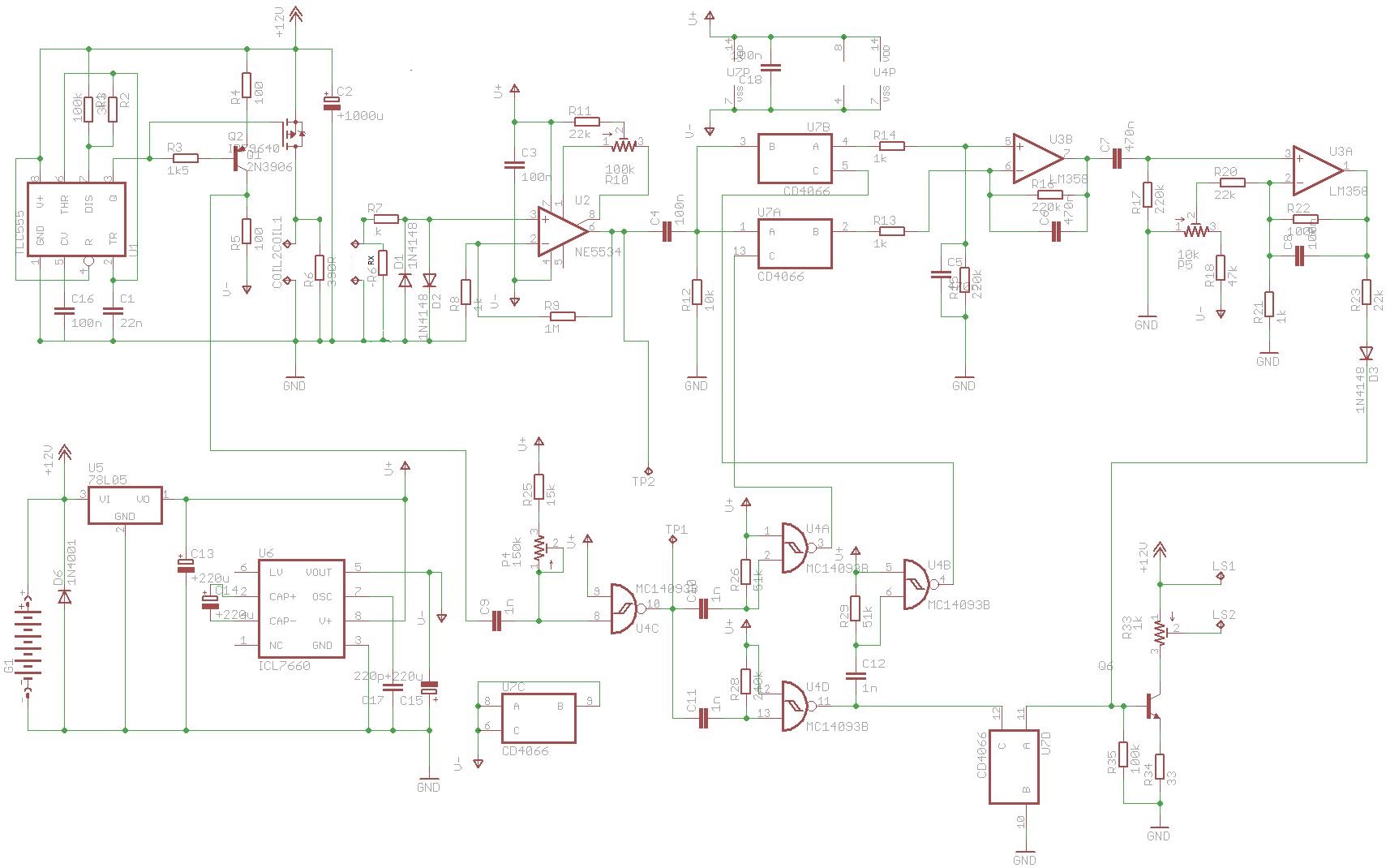

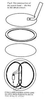

    Does anyone have a schematic or can tell me how to convert my surf pi to use a double d coil and also some info on how to make a double d coil to suit? Thanks
    Surf was never meant to use two coils but something like this would do the job. Using the existing PCB would get ugly.Click image for larger version
Name:	SurfPISilverDogschematic1_2 twocoil.jpg

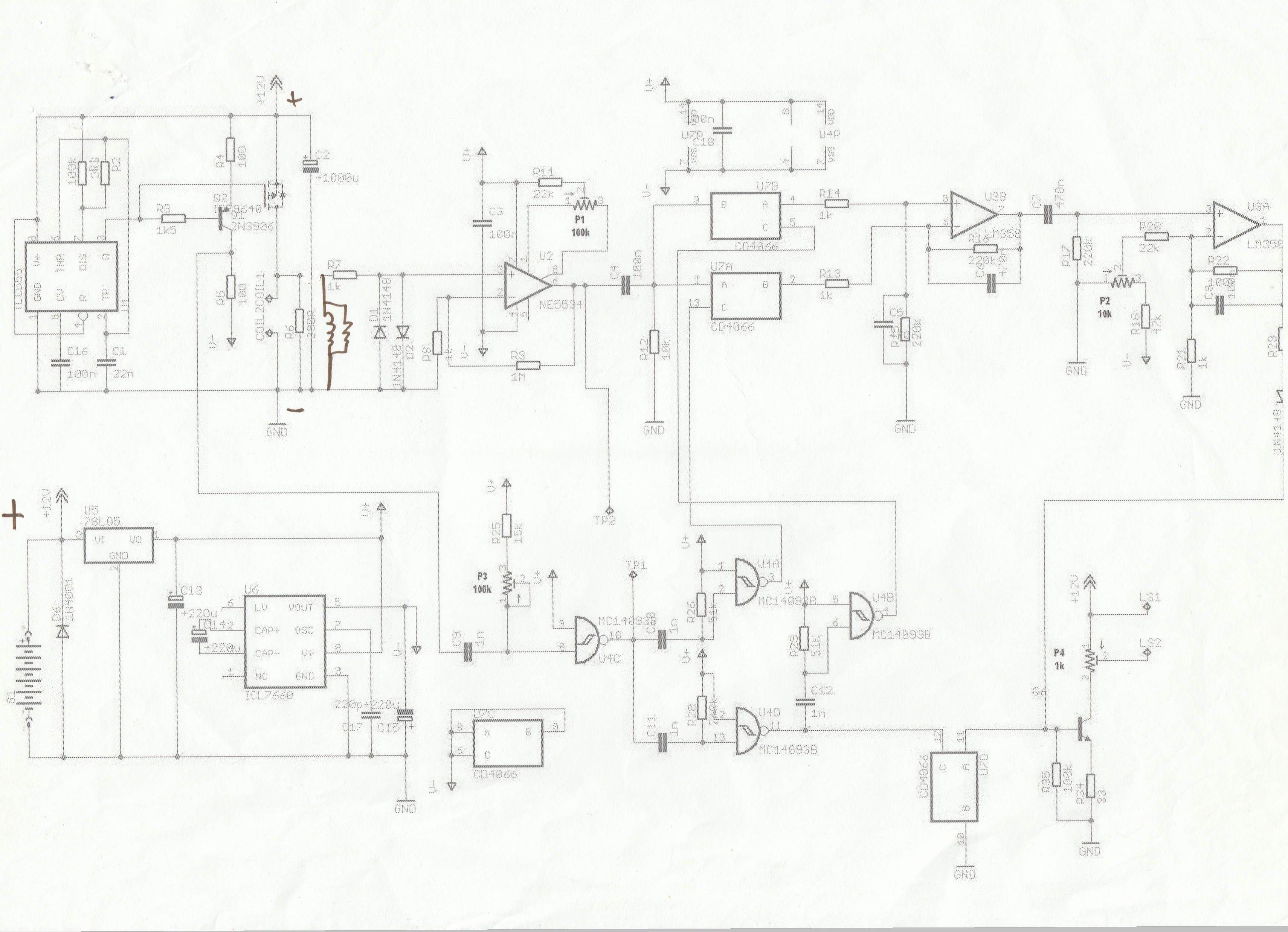

      Easy break the connection at R7 or whatever the resistor is called on your PCB, add new coil and damping resister as shown on cct
        You can make it as simple or complicated as you want it., two 300uH coils is a starting point.
          Is there a way i can amplify the output pulse? If i was to do that im thinking i will upset the pulse timing but if i could adjust that could i run into issues with making ground noise worse? Ive built many amplifier kits etc but this is the first detector kit and i understand some of the circuit but not all 100%. Im trying to mod this for deep nugget search so i might end up having to change some things but i did buy the kit to play around with and to understand how it works . For deep nugget search should i be changing pulse timing and frequency?
            Your not going to realize any gain in depth by adding power to the TX. Just eat more battery time. Look up Diminished Returns. If it's gold your after this is not the right machine. The Minipulse would be better suited because of a number of factors. It's already set up for single or dual coils. With a fast coil sample delay can be down below 10uS were the Gold Lives. The Mini is set up so it also handles ground conditions a bit better. Best you can do for the Surf is Build a Fast Coil and get the sample down in the 10uS range.
            If you have already purchased the Surf build as best you can. Fast Coil and get your samples down as close to 10uS or so. Consider the Mini.
