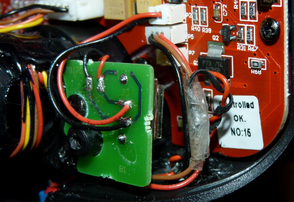

    This modification is perfect for high sensitivity vibration search !!!
    Pinpointing Mode Always On!
    When the switch is set to: "pinpoint always on", the Makro Racer
    or Nokta Impact will senses the weakest signal differences which
    improves the usual motion-mode vibration sensitivity enormous!
    Of course pinpointing is all-metal-mode but for maximum depth
    and highest sensitivity its better to search in this mode anyway.

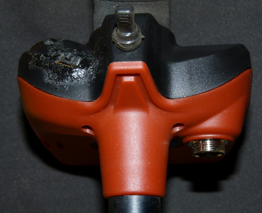

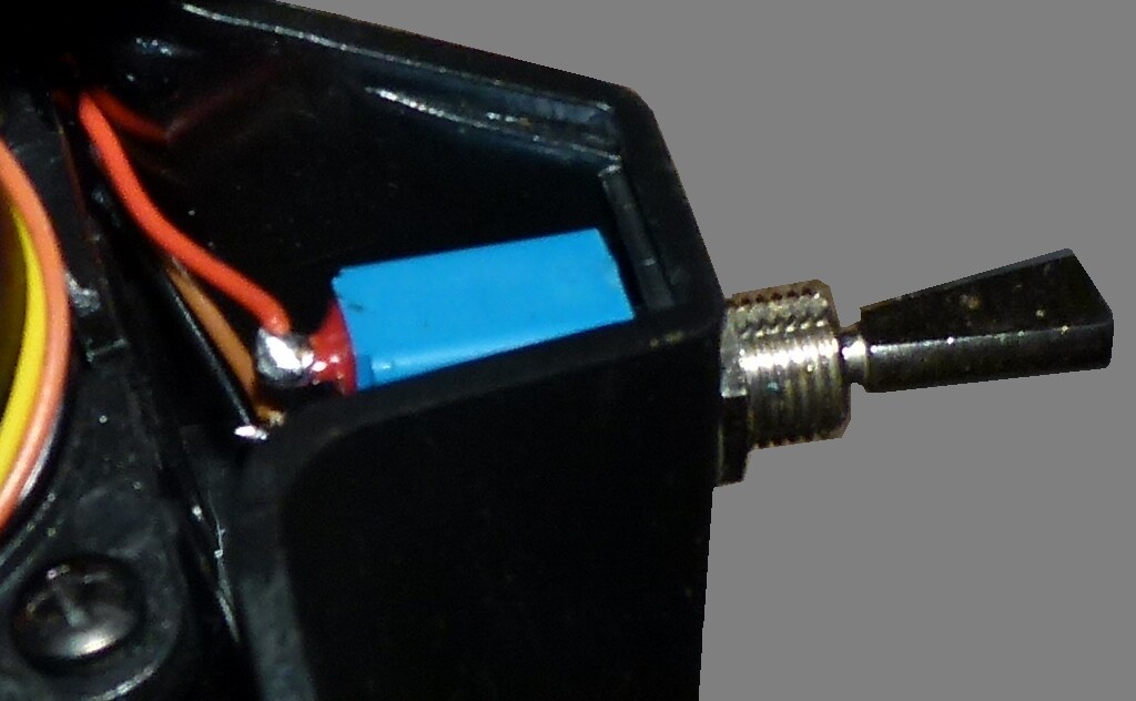

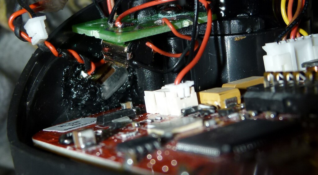

    It adds a little switch to the push-pull trigger (Macro Racer: red & brown cable)
    Untouched this trigger is in motion-mode and it pinpoints while pulled.
    The added switch connects "pinpointing" or leaves the trigger disconnected.
    Its a usual left-right switch with 3 connections.
    Solder the red and brown cable to either the middle and left pin or middle and right pin.
    This way the switch connects - disconnects the 2 cables.
    ( Hell, to what people I'm talking - who reads here surely is no bloody rookie! )
    Nevertheless - there is some safety-warning:
    Don't push the trigger (this sets the Makro Racer or Nokta Impact into ground-balancing-mode)
    while the new added switch is set to pinpointing-mode or it might creates some shortcut or whatever.
    Probably it just causes some harmless error but better don't risk it.
    (with a 6pin switch its possible to disconnect the black cable while
    the red and brown is connected, but this its a little bit more effort)
    And don't switch the detector ON if the switch is set to Pinpointing-Mode.
    Also don't open the device if you like to keep the warranty service intact.
    Anyway - if you wanna hunt with vibration, this is THE absolute perfect modification
    for you because that way your finger must not pull all the time the trigger for

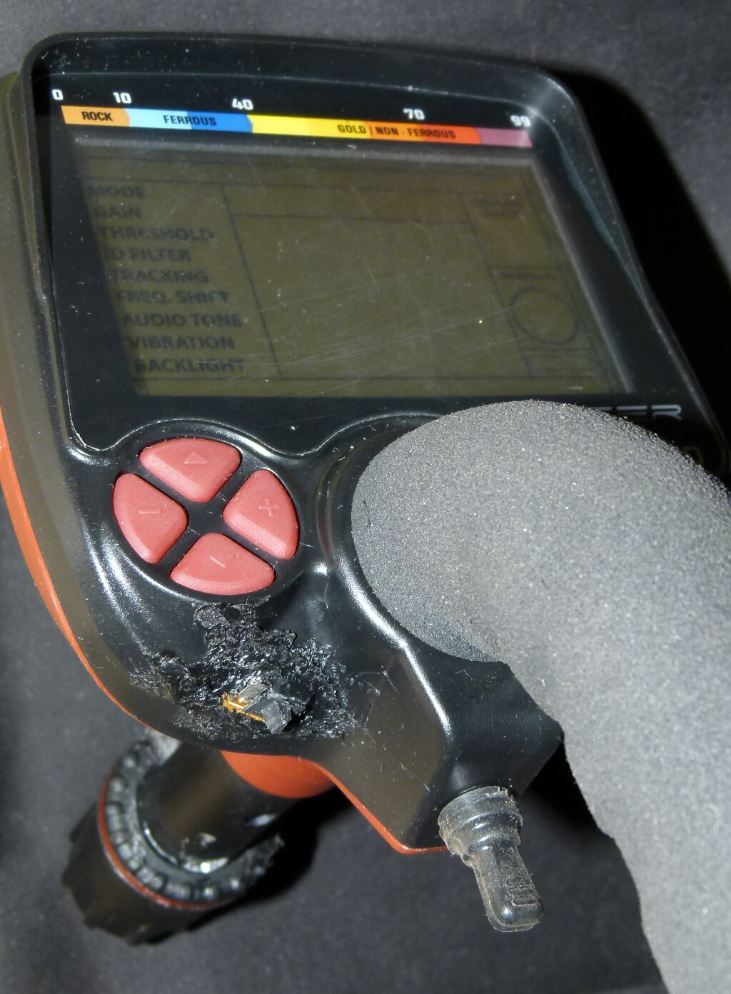

    maximum sensitivity. Just melt some little hole inside the black plastic-housing with
    the soldering-iron to attach the switch there and make it as waterproof as possible.
    For setting the Impact or Racer to maximum pinpoint sensitivity simply lift the coil
    more or less over the ground so the vibration is almost off and pull the trigger.
    Test a bit which is the best distance (= pinpointing sensitivity), but no big deal.
    If you hold the coil into the air and pull the pinpoint-trigger you might get the
    highest sensitivity at all, but this is too high if the coil comes close to the ground.
    However, the detector will remember the signal-ratio-value as long as the trigger
    remains pulled and also if the modification-switch is set to "pinpoint mode on".
    This modification is done within ca. 2 hours and it's easy! Good luck, enjoy the pics!

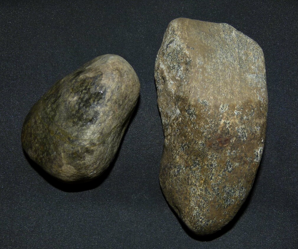

        That mode even is able to detect cavity if the ground-balance changes at "good" enough mineralized soil:
        The weak vibration or pretty quiet audio-threshold vanishes if there is cavity or some meteorites
        (including other special mineralized stones, often grey-blue color) while it raises if there is metal.
        half wet, half dry:
Name:	mineralized stones.jpg
