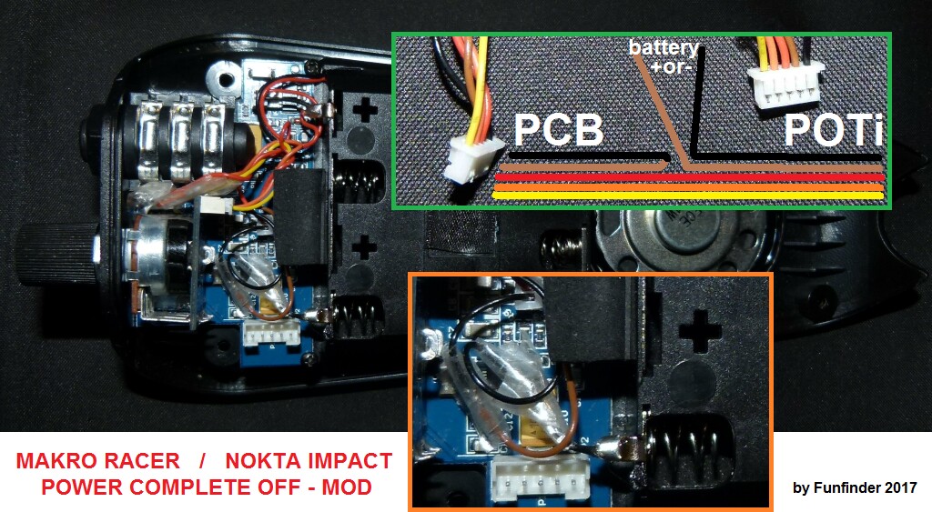

    When I start to improve stuff I often find additional issues, so here's the next mod:
    Its not good when a device still consumes power even while its switched off,
    especially not if accus are in use. Its possible to interrupt the battery-contacts
    with little plastic-sticker but thats stupid work if there is a poti with on-off switch.
    The mod is super simple:
    There is a 5 pin cable from the poti to the PCB (from arm-rest with batteries part):
    1. Remove the batteries and open the detector-housing, get the cable from the poti.
    2. Cut off just the brown and the black cable*, close at the PCB's side plug.
    3. Solder the black with the brown cable and insulate it.
    4. Cut off one of the cables which comes from the battery housing (red or black).
    5. Connect one end of this cable with the brown and the other end with the black cable.
    6. Solder plus insulate it, plug the 5 pin cable correct back in and close the detector.
    Now the Makro Racer or Nokta Impact really is OFF if switched to off and
    no longer wastes any energy. Time for this modification: ca. 15 minutes.
    * The color-codes are for the Makro Racer and also should match for the Nokta Impact.
    Perhaps someone here who has the Impact can test and confirm that there's no difference.
    If in doubt its very easy by multimeter to check out which cables belongs to the on-off switch.

      The Makro Racer keeps its settings also with no batteries inside - per instance if vibration was set to on
      and I guess the Nokta Impact, too. The ca. 0,5v which are to measure at the PCB when the power is "off"
      (the original setup) wouldn't be enough to power the display-part-PCB anyway.
