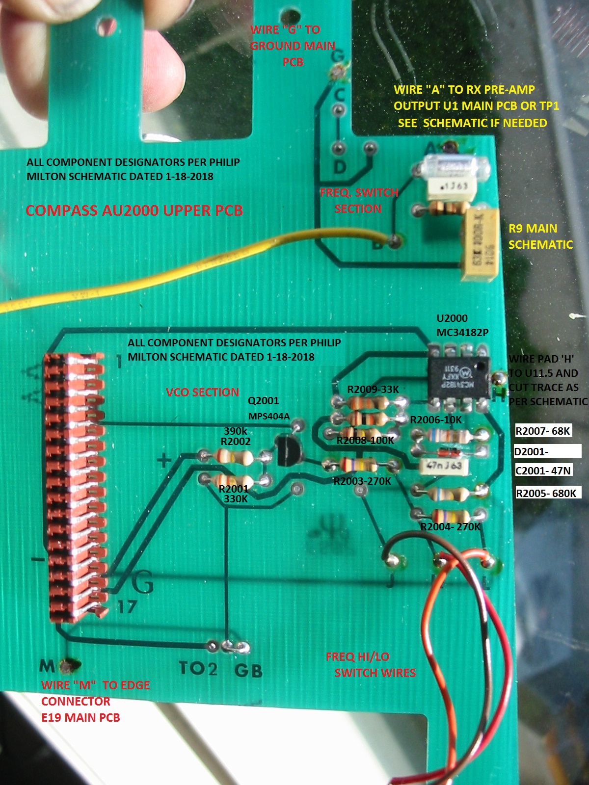

    I've been going through old files, data and pictures of the Compass Scanner series this last few weeks. During the process I've come across a few things to share and an interesting idea .
    One idea I had this last week may be of interest to others and someone may want to try this nice easy mod to the Compass Gold Scanner Pro. It involves using the un-populated section of the upper board to ADD a VCO as the primary Audio . The VCO circuit is copied directly from the Compass Scanner Model AU2000 which has a VCO and uses the same board . It should work perfectly? I am asking for feedback and someone to check my work If there is any interest in trying this out. This VCO circuit was designed by John Earle can be added to any John Earle Scanner model.
    It is important to note that I have not actually built this mod as my GSP is kuput at the moment and so I couldn't test the idea anyway. Just an Idea someone may want to follow through on. But I am able to trace out the un-populated area of the Gold Scanner Pro upper PCB and there is no conflict in using these traces for this new function as best I can tell. (FYI, this un-populated area is used for the Notch on the XP450 model Scanner which also uses the same pcb).

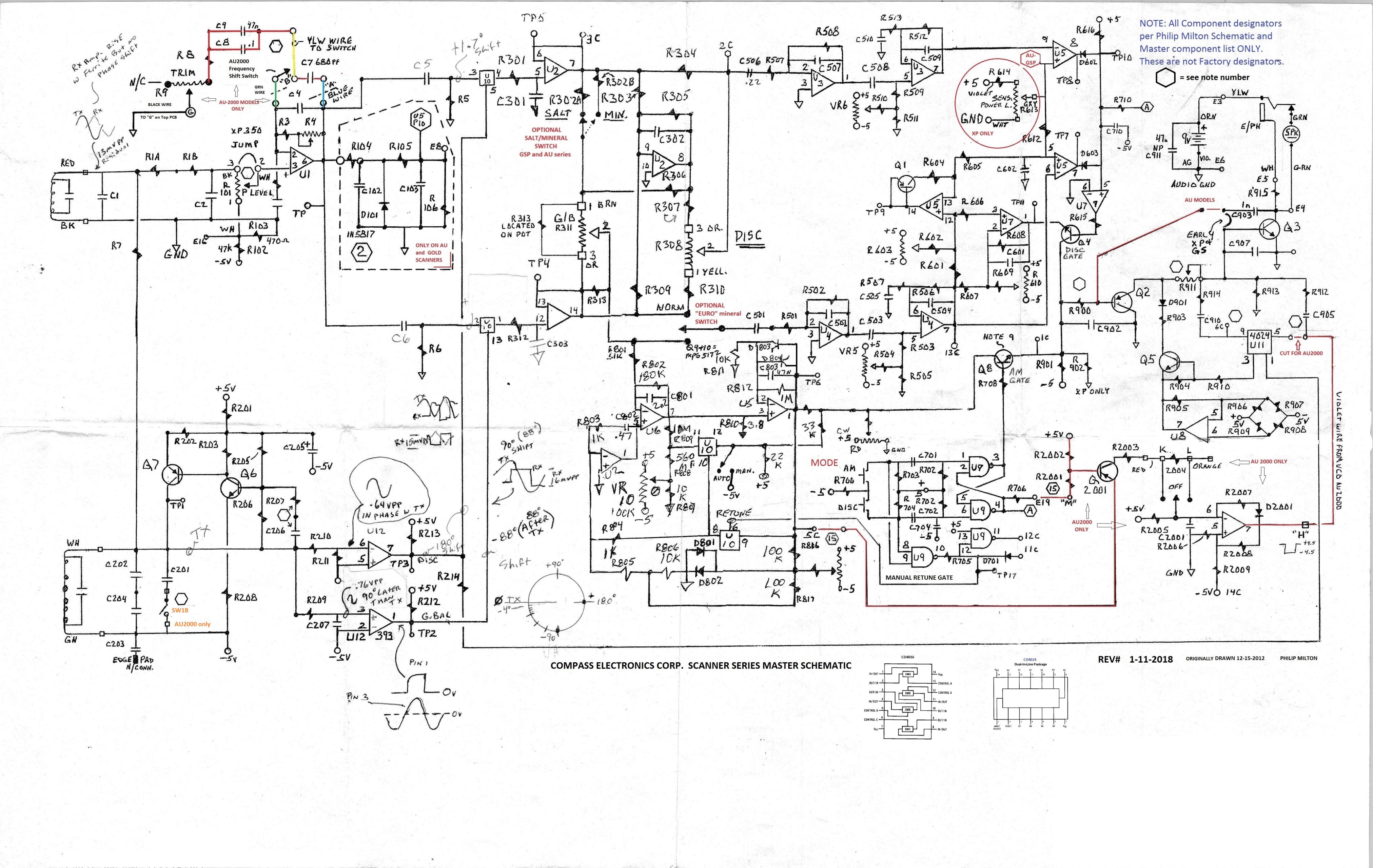

    Check out the Master Scanner Schematic , Philip Milton REV#1-18-2018, posted here and elsewhere on the Geotech forum to see the circuit drawn out and to locate the trace that is cut on the Model AU2000 PCB. It will need to be cut on the GSP as well, (can be re-soldered to restore). Also don't forget to add/change/reroute the Capacitor # C at the Audio as shown on the Master Schematic for model AU2000.
    Attachments: Compass Scanner Master Schematic, P. Milton REV# 1-18-2018
    Gold Scanner Pro TDI PCB Picture with VCO components added
    AU2000 upper PCB showing Component # and Value to go with schematic

      Hi Melbeta,, I saw your question on this VCO Mod elsewhere on the forum and I hope I can give a clearer idea on what this modification to the Gold Scanner does.
      The VCO is used here to drive the Audio Response. The stock Gold Scanner Pro came with a BEEP BEEP/ON/OFF audio response to targets. The VCO Audio Mod proposed here changes pitch as an indicator to a target. The human ear detects this change in pitch better on deep targets especially and makes pinpointing easier as well.
      I think the idea and circuit for the Modification is solid because it was designed by John Earle for the Scanner circuit. Unless I am missing something. It was marketed on the AU2000 Model and simply transfered to this Model as a mod.
      The only original idea I had was fitting the circuit into the vacated Notch Component locations on the Gold Scanner Pro circuit board. Since I do not have a working Gold Scanner anymore I was hoping someone would double check the work I did creating the LAY file for the mod and testing an actual build. Was just wanting to hear results if anyone try's it. I can think of two guys that will probably try it when they get a minute.
      You will need to have a program to view LAY files to see the actual PHOTO of the Gold Scanner PCB I attached showing the Mod.
      So,,, I ain't got much to teach friend. Just presenting an idea to try for fun.
      Alternately, building a simple PCB for the 11 parts needed would allow this VCO to be added to any of the other Scanners or XP.
      HH, Phil
        COMPASS AU2000 VCO COMPONENT LIST
        This is a mod to add a VCO to the Compass Gold Scanner Pro.
        All details Details at: http://www.geotech1.com/forums/showt...oldScanner-Pro
        Please look for answers there first.
        R2001- 330k
        R2002- 390k
        R2003- 270k
        R2004- 270k
        R2005- 680k
        R2006- 10k
        R2007- 68k
        R2008- 100k
        R2009- 33k
        U2000- MC34182P low power dual Jfet OR TLC2262
        Q2001- MPS404A
        C2001- 47n
        MOD Notes:
        1. On the schematic you will see a switch used to choose the pitch range of the VCO and turn it on or off.
        Here a guy can choose to customize and simplify the mod by eliminating the switch and choosing either R2003 or R2004 to populate the slot. OR Alternately use the two holes to attach the switch for selecting resistors and on off as the original design does.
        2. Bend out pins 1,2,3 of U2000 so they do not contact pads 1,2,3 on the PCB. U2000 Pins 1,2,3 are not used and can be grounded. Letting these pins contact the pads may cause a conflict with Q2001? so just make it simple and disable them as they are not used.
        3. Altho I have spent several hours checking this idea out and am confident it will work nicely please Remember this is untested so proceed accordingly.
        4. If you have any more questions please ask as I have an interest in seeing this built and any bugs worked out.
        Phil
