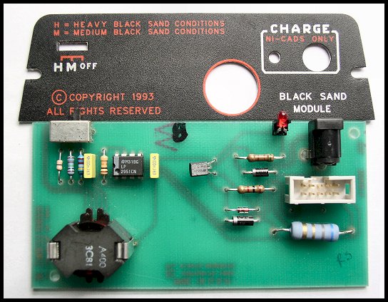

                    I am going to make your day. I knew that Oz had heavy minerals called mafic conditions, and George Payne, when he was with Discovery Electronics, came out with a base unit Discovery metal detector. With a Pro Hunter Module, you can stick into the rear of it, what George called a Black Sand Module. Now if you can find one, with the base Discovery Baron unit, plus a Pro Hunter Module, and the Black Sand Module, just use it and hope it takes care of everything.
                    Now it did not have a meter, but you had a slide switch, which selected either medium black sands or heavy black sands. If you manage to draw out the schematic, send me a copy would you?

                          There is a schematic for a BASE BARON floating around the internet, but remember this, Discovery Electronics had the father of the VLF, GEORGE PAYNE working there as the Chief Engineer, and he created the mother of all metal detectors at that time, employing a microprocessor chip as the microcontroller unit, and with a boost on the motherboard, and without the code for the large chip, you are in the ship without the engine. I have not seen any schematic for the Black Sand Module so far.
                          My suggestion, pick up the pieces, and put them together, the Bass Unit is the main detector, stick in the Pro Hunter in the front, stick in the Black Sand Module on the rear, and you are running with the chip program version that was programmed into the microprocessor at the time.
                          Beyond that, I have never seen any schematic for any black sand module or black sand anything.

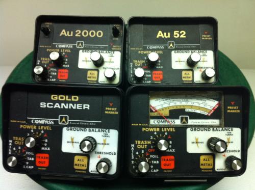

                          And here is the family of the four Gold metal detectors, and the one on the lower right is the Gold Scanner Pro model...

                              And for your Australian knowledge, this information that Phil is referencing about, came from Compass Electronics representative telling how the Australian AU52 and AU2000 were changed from the American versions, to cope with the highly mineralized ground. Compass at the time had a Australian Compass Service Center, which experimented with various Compass models to see if this worked or if that worked, and they found what did work.... So if you can find an Australian Compass AU52 or AU2000, it will find the gold nuggets, maybe some mineralized areas might be a bit too hot or not.
                              MELBETA
