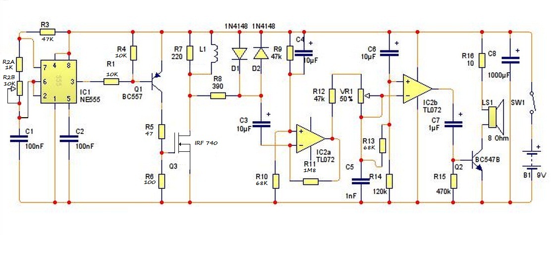

    I built this detector called "Pirate" or something, it's a Russian designed PI device, the process was fun and the results are very good, especially after several trials and errors with coil designs it showed amazing potentials compared to it's simplicity.
    Now I'm looking for a way to add a LEDs vu meter, or at least just one LED to help in noisy environment. I believe I can use a LM3914 for the vu meter but I don't know how!! I also tried to play with a 2N2222 to trigger the signal right from the buzzer to a single LED also with no luck. And adding a 3.5 plug support for headphone attachment is far beyond my knowledge, as I'm still learning!!
    Calling all gurus here for help, and please consider that I'm still learning

              If the schematic in the first post of this thread is correct then there is NO DC level indicating Target Detected. Therefore, one can not simply connect a VU meter circuit of an LED to indicate a target.
              This is due to the TX pulsing is also the Audio tone generator which then simply gets louder with a target.
              I would need to see the output with an O'scope (post scope pictures) without and with target to determine how to do a VU meter or LED.
              My guess is a rectifier circuit and amp to produce a DC LEVEL needs to be added.

                    Ok Mike, When you get your scope start with the simpler points like the output of the 555 timer on pin 3.
                    This will be a pulse train with an amplitude close to the battery Voltage.
                    Once you can adjust to see this then go check the two outputs of U2.
                    Post back here findings and questions.

                        The audio is a fixed frequency, when it detects metal the audio volume increases but frequency stays the same. Right?
                        The Scope will verify this.
                        Therefore, you need to rectify and filter.
                        From the audio go to a diode ->|- then a resistor (~2k) and cap (~470nF) to ground. This should then produce a DC Voltage level that increases when metal is detected. The VU meter chip can then be used. Be sure to set output Voltage level needed by the VU chip's input.
                        Again, scope will verify rectification and filtering. A Voltmeter can be used to check levels needed.

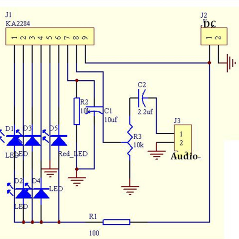

                              And I thought I was slack, might work
                              guess this is the schematic
