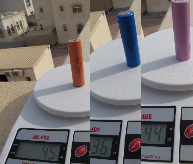

    T2 have a separated from the control box battery container which includes small board DC-DC converter(at least as per me;-). The first part of the project was to measure the weight of the 4xAA vs 1x18650 or 2x18650.
    Here the results:
    1x Overrated Chinese LiIon claiming 3800mAh - 36grams;
    1x Samsung Lion unknown capacity(probably 2600mAh) - 45grams;
    1x HP laptop battery element Lion rated 2600mAh - 45grams;
    Let's average the weight to 40 grams.

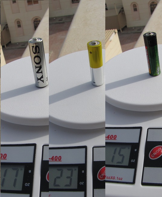

    1xAA Sony Ultra - 17G;
    1xAA Ikea Alkaline - 23grams;
    1xAA Camelion super heavy duty - 14 grams;
    For now those are the only types i have and let's average the weight to 20grams per piece. Exchanging the 4x2AA with one 18650 reduces the weight by half(40 grams - not a big deal). If replaced by two 18650 we have the same or a bit more weight but increased capacity.
    The conclusion is not very bright - in fact the only benefit from the MOD is the cost cutting of the batteries price, especially if you use elements from failed laptop battery as i do.They are free:-).
    The weight and capacity benefits are either neglect able or must be checked/measured to prove and depend on the type of LIion you are using. That will come at later stage.
