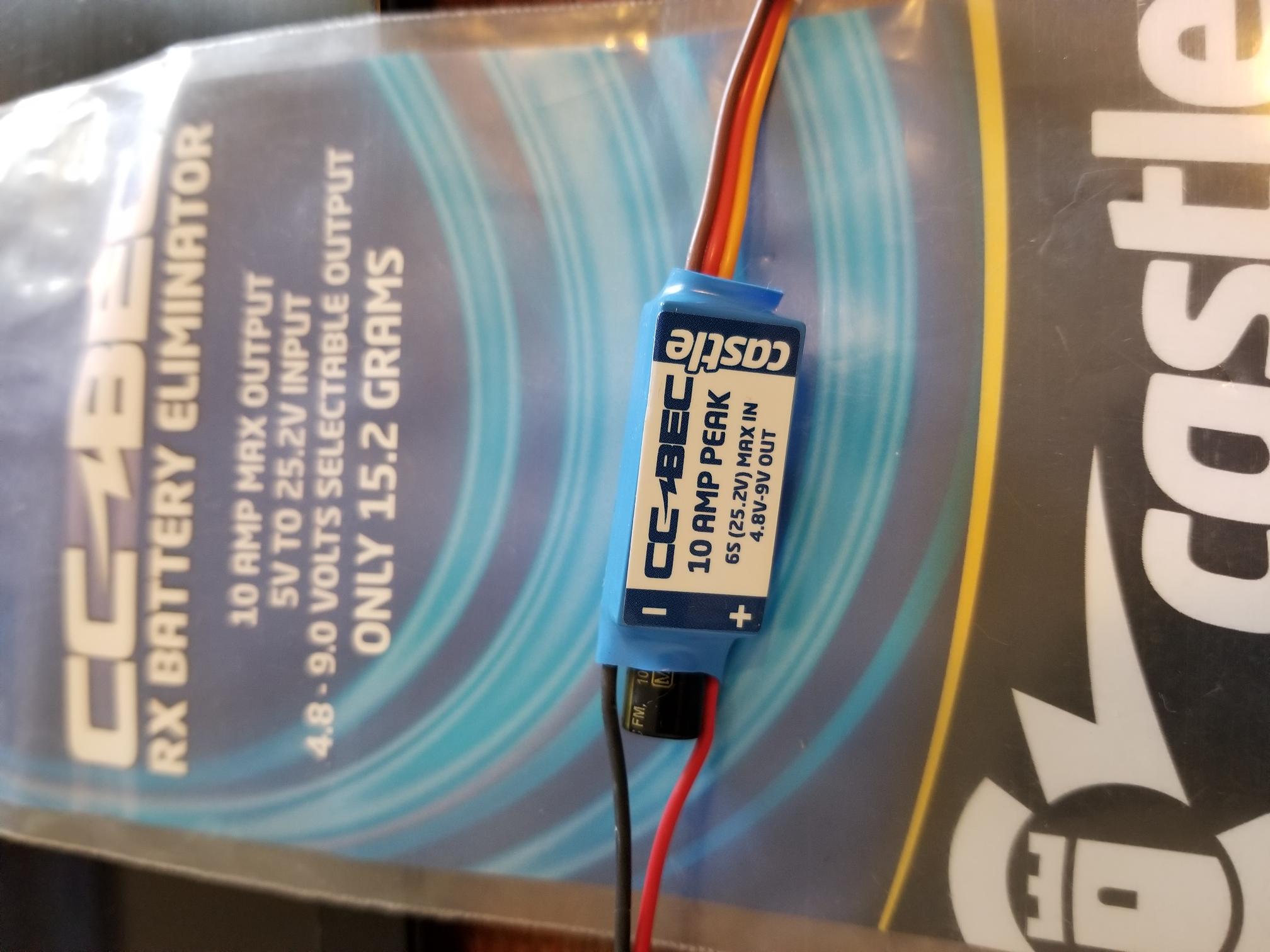

These are suposed to be for RC flight controllers to avoid noise from the battery. I have not tried one on a detector yet. programmable in 1/10 v increments. Was thinking it would also be a good power source for a TD3x.
Should be good clean power.
Has anyone here had experiance with these in a detector circuit?
