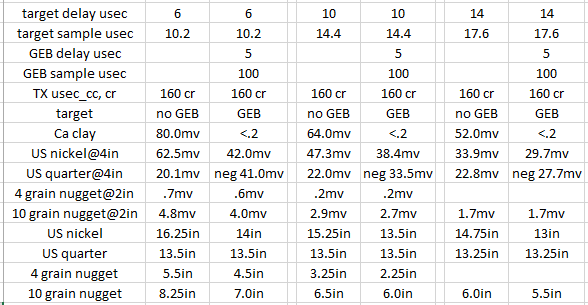

Any know modifications to increase depth of the White's TDI SL manufacturing date 2014?
I've always heard that running this machine GB off gave a huge depth increase, but not this one.
| White's TDI SL, manufactured 2014, pulse delay 10 |
| Air Test | Freshly Charged Battery Pack | |||||||||
| GB OFF | GB OFF | GB ON MINIMUM | GB ON MAXIMUM | |||||||
| GAIN MAX | GAIN 8 | GAIN MAX | GAIN 8 | |||||||
| 7 1/2" Dual Field Coil | 7 1/2" |
7 1/2" | 7 1/2" | 7 1/2" | ||||||
| Super Pulse 350 | 11 1/2" | 11 1/2" | 11 1/2" | 11 1/2" | ||||||
| 12" Dual Field Coil | 13" | 13" | 13" | 13" | ||||||
| To be honest I'm kind of disappointed | ||||||||||
| Very smooth threshold In ground performance may be different |
