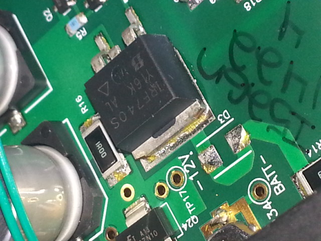

              Mark, besides R9 the main FET (Q4) and the damping resistor (R14?) are also subject to running hotter. You might want to measure the total supply current with the 14V pack... with the coil it should be around 500mA. Also measure without the coil. This will tell you the total TX current. Then do it again at 16V, see what the increased current looks like. I designed the circuit to fundamentally work at 18V (maybe more, I don't remember now) but that doesn't include the extra heat.

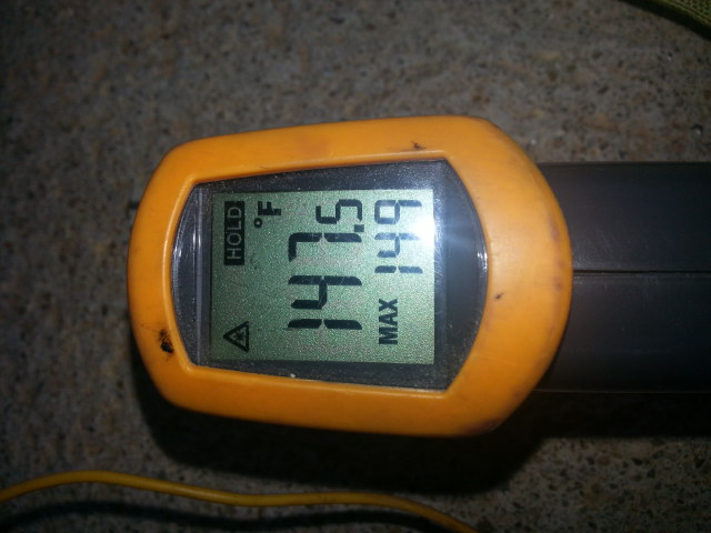

              As usual, Carl was correct. Q4 is the source of all the extra heat in my SL. Measure the transistor with an IR thermometer and it was 150+ degrees. Enough to burn a finger. Appears to be soldered to a heat sink attached to the main board. The board all around the FET was also hot, most places 125 degrees. One good thing, R9 was hovering around 101 degrees, not bad. What has me concerned is the heat built up inside the box. Now on the positive side, when the battery voltages drops below 15 volts the heat seems to be quite a bit lower, but the performance stays about constant.
                Q4 is soldered to a thermal pad, which isn't a very good heat sink. You could replace it with a stand-up TO220 version and put a real heat sink on it, that would help.
                The reason Q4 gets hot is because it hits avalanche during flyback. You could replace it with a higher voltage FET so it doesn't avalanche and that would reduce the heat tremendously. However, you have to carefully test for one that doesn't ruin the recovery speed.

                      If you have an oscope, you look at the output of the preamp and make sure it still settles in 10us.
                      If you don't have an oscope, test a small low-conductive target at 10us before & after replacing Q4 and see if sensitivity is maintained.
