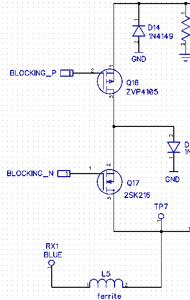

      SD2200 has SMT ferrite bead in the RX soldered on the board.

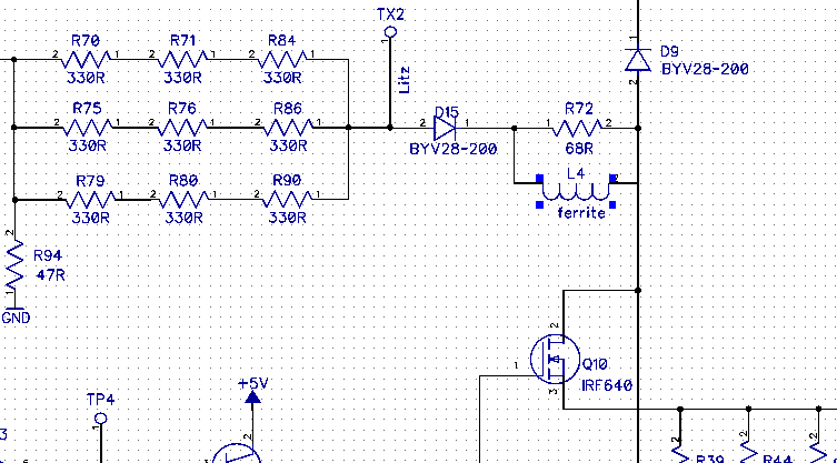

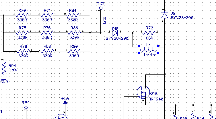

          Hi, thanks, would you know what part of the circuit they have added the bead ?
            There are 2 ferrite choke emi filters in the circuit (+2 more in the power supply).
              Thank you for posting the circuits .
