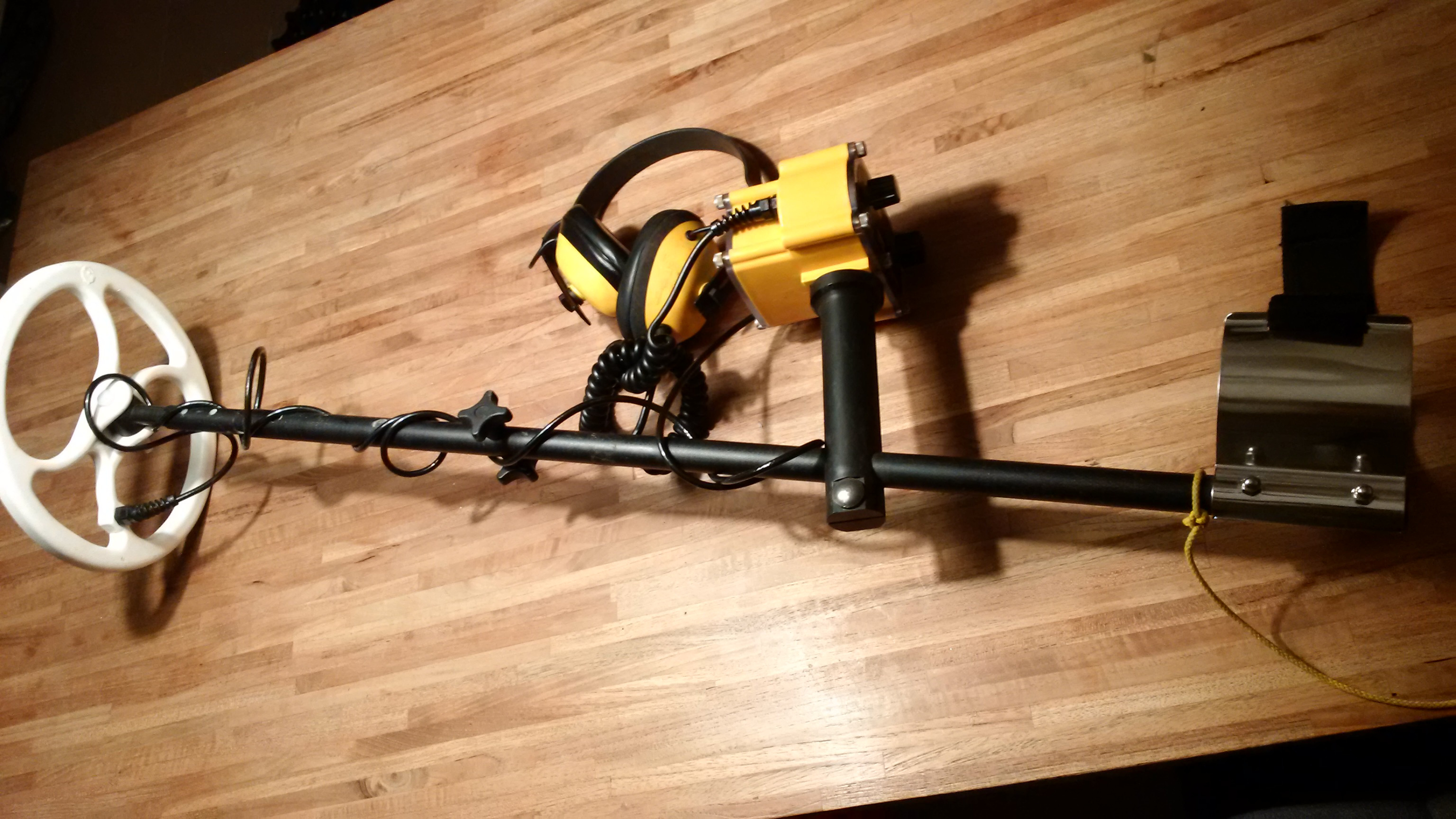

are there any known modifications for the C-SCOPE CS-7 PI detector?

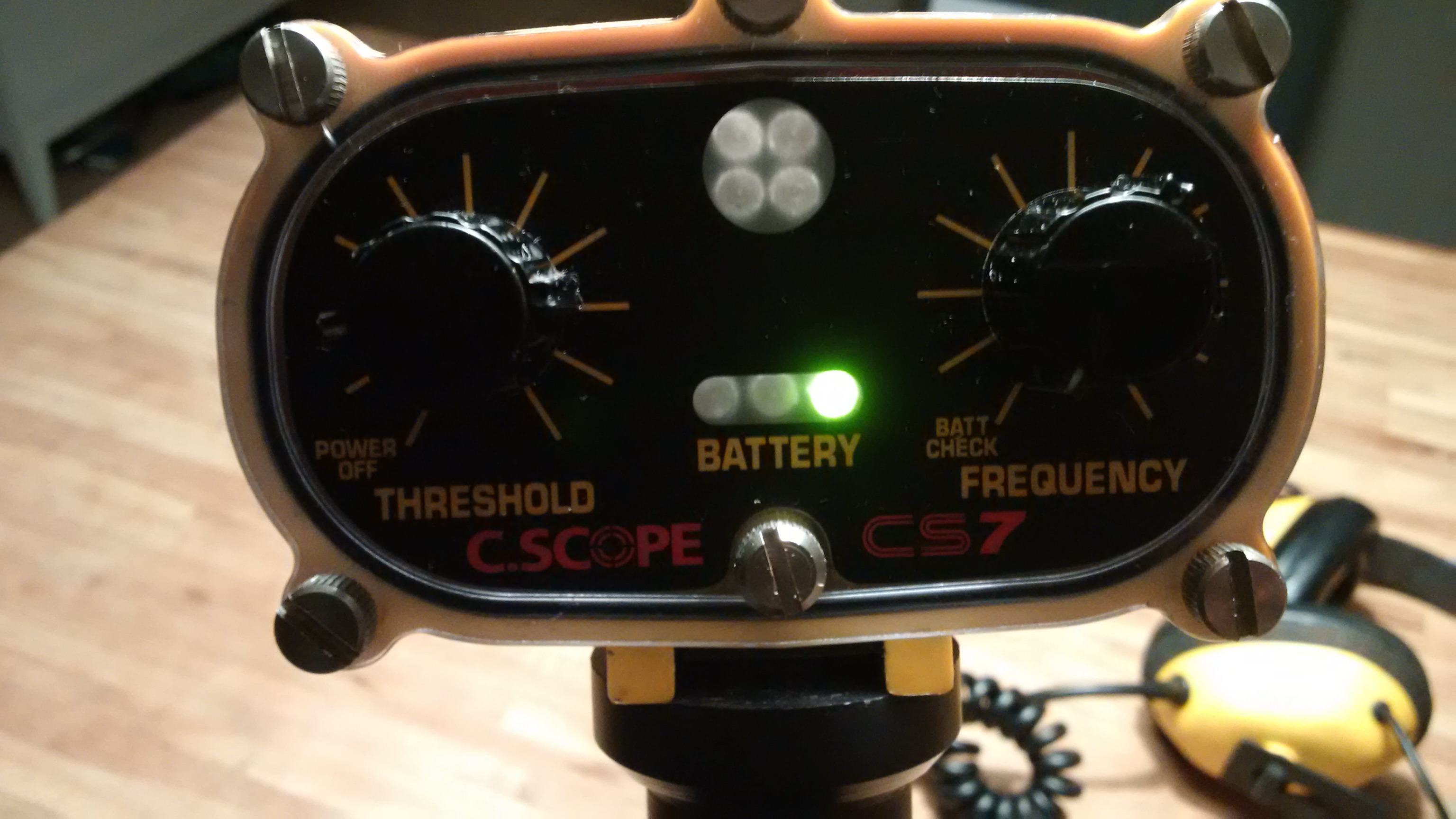

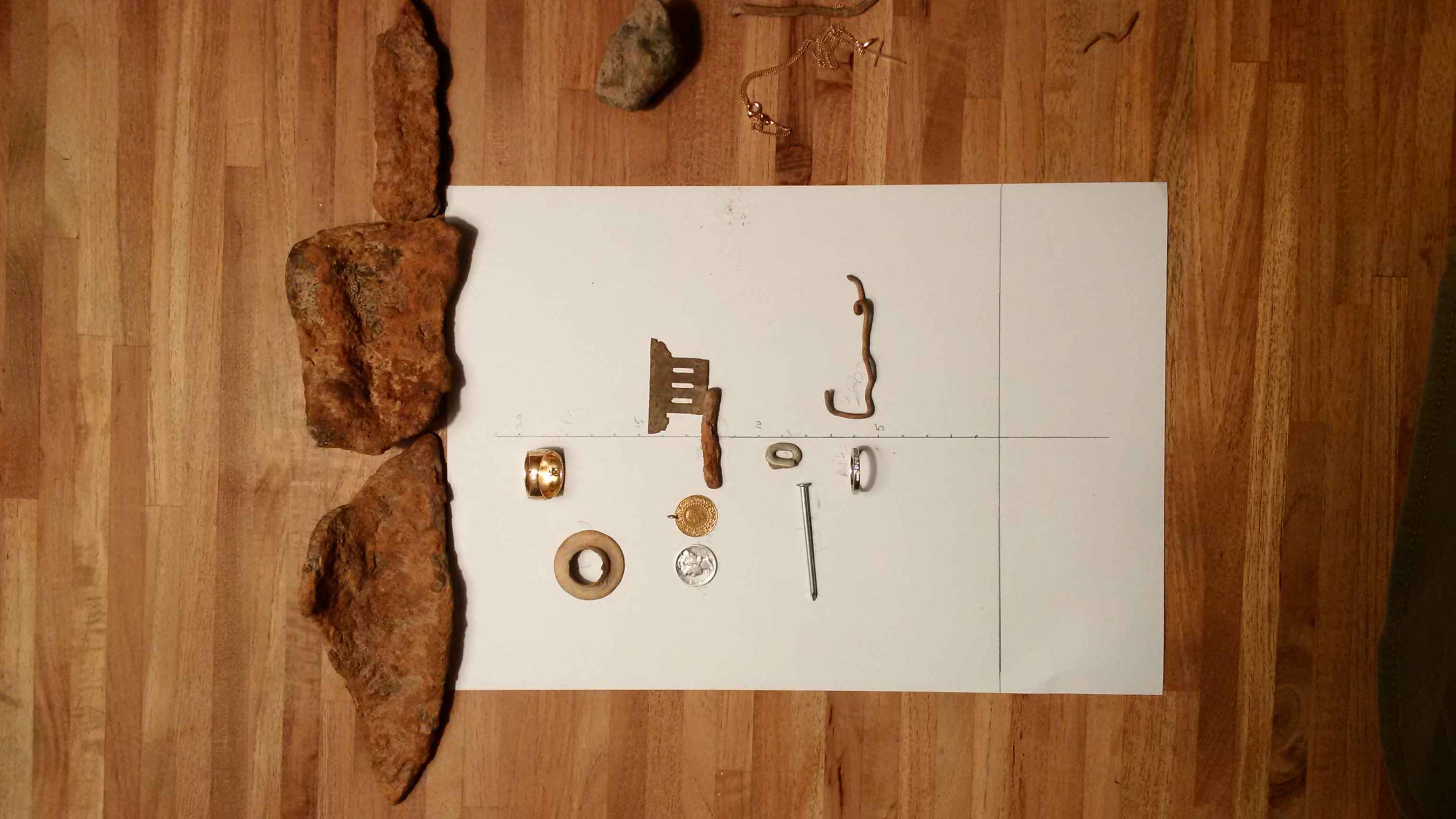

I did an air test with a horizontal coil, but wasn't impressed with the depth of various metal coins/objects. Turning the frequency knob clockwise increased the sensitivity for gold, but a thin gold necklace had to be virtually in the coil to give a signal.
What kind of depth should one expect for a low powerd PI detector?

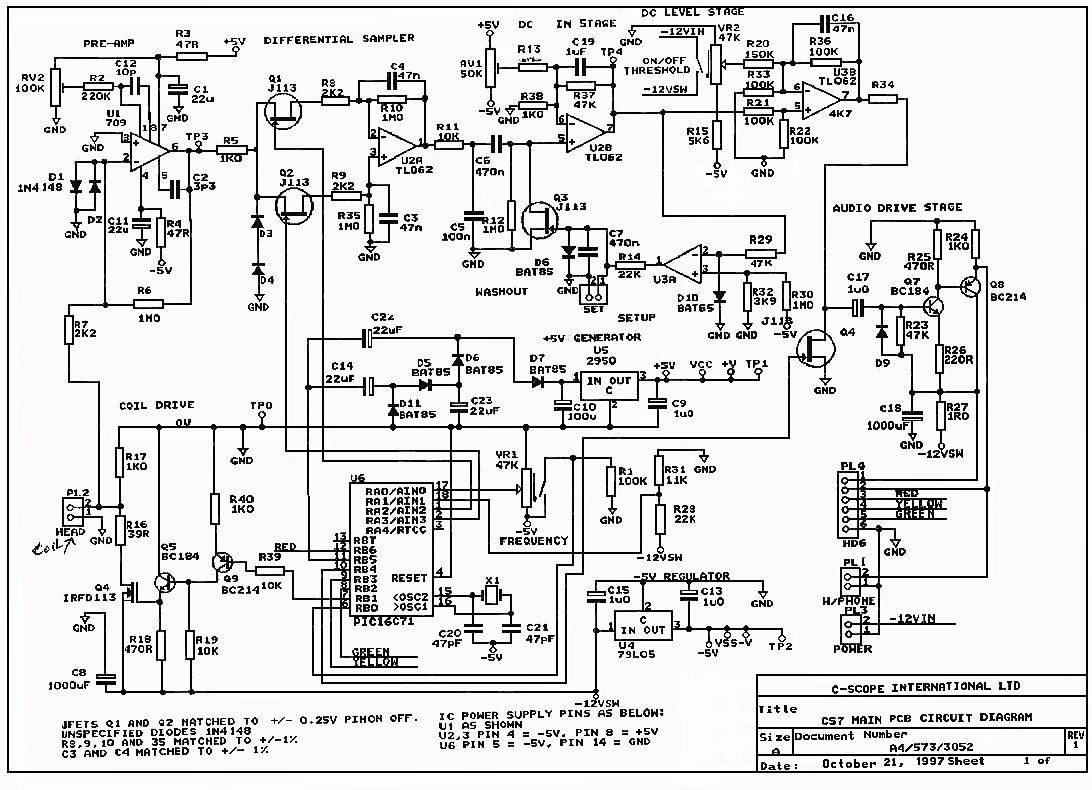

According to the manual the volume of the waterproof headphones could be managed with a potentiometer on a seperate pcb in the casing. However in the casing there is no seperate pcb for the headphones available. On the PCB for the detector there are 2 potentiometers; RV1 and RV2. Does anybody know what they manage?
Also there is a 2 pin header/jumper on the pcb. Does anybody have a clue what the function of it is?
kind regards, bleep.
