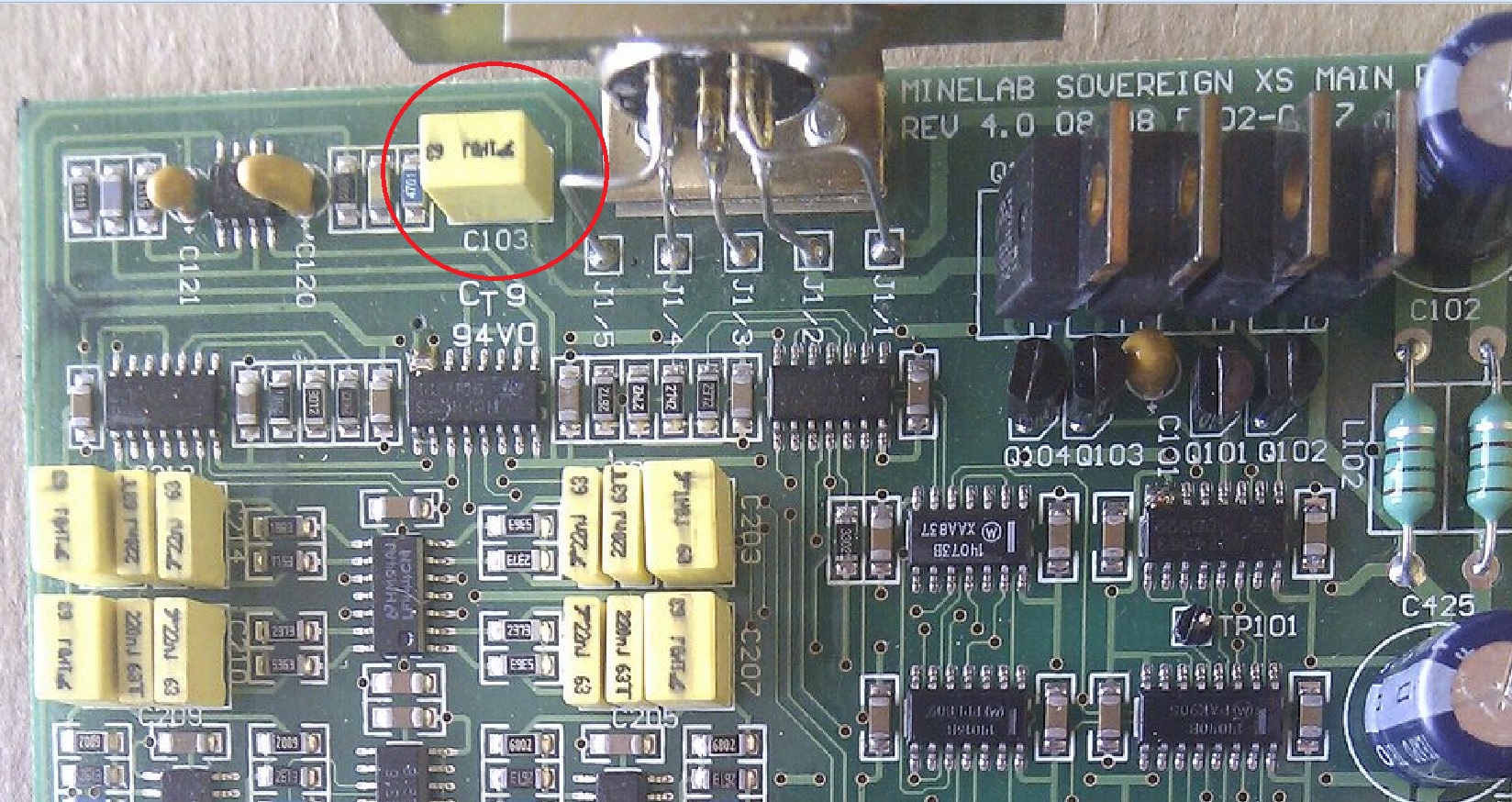

      Hello again ive had a think about reducing noise on the Sovereigns
      I did build a similar multi frequency design using a quieter TX drive
      and found noise is greatly reduced at the RX front end by using a
      smaller capacitor for C1 which is 1uF standard.. its the first one left of
      the coil wires to the board usually blue and is connected to coil pin 4..
      marked J1-P4 thats the 2nd pin wire to pcb along from it.. to the right
      thats looking down the board as if to your coil..
      Other side of C1 goes to 4K7 resistor joined to pin6 of the LM833 RX amp (IC1)
      I think its capacitor C103 on the old XS and not sure what its numbered on the GT
      Ive not tried this on my XS but i will test it out shortly..
      If your using an aftermarket coil without the coil preamp in youll be able
      to reduce this capacitor lower than if your using a Minelab coil.. you may
      get it down to below 100nF

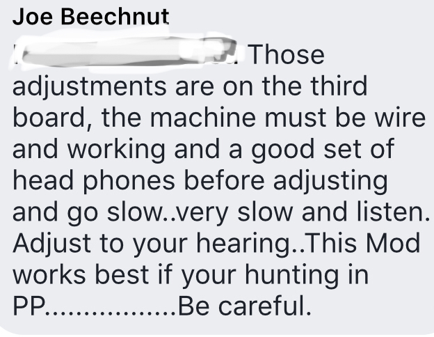

        I asked on minelab bbs owners on fb but no one answer regardind the msr mod. Only joe beechnut gave some advice on excal, which i think is the same with sov.

          Hi Math, would you like to take some pictures. Thank you!
            c103 on old xs and also on gt

              Hi, yes thats the one thanks, ill have this mod done on mine by tomorrow eve and will post some pics of the scopes then.

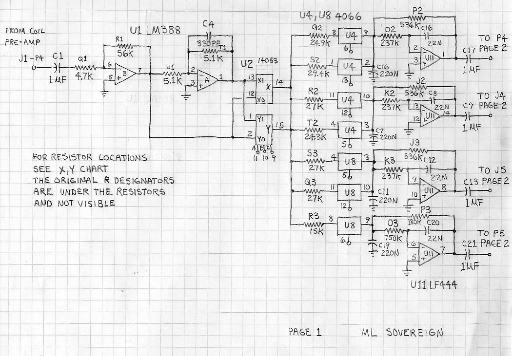

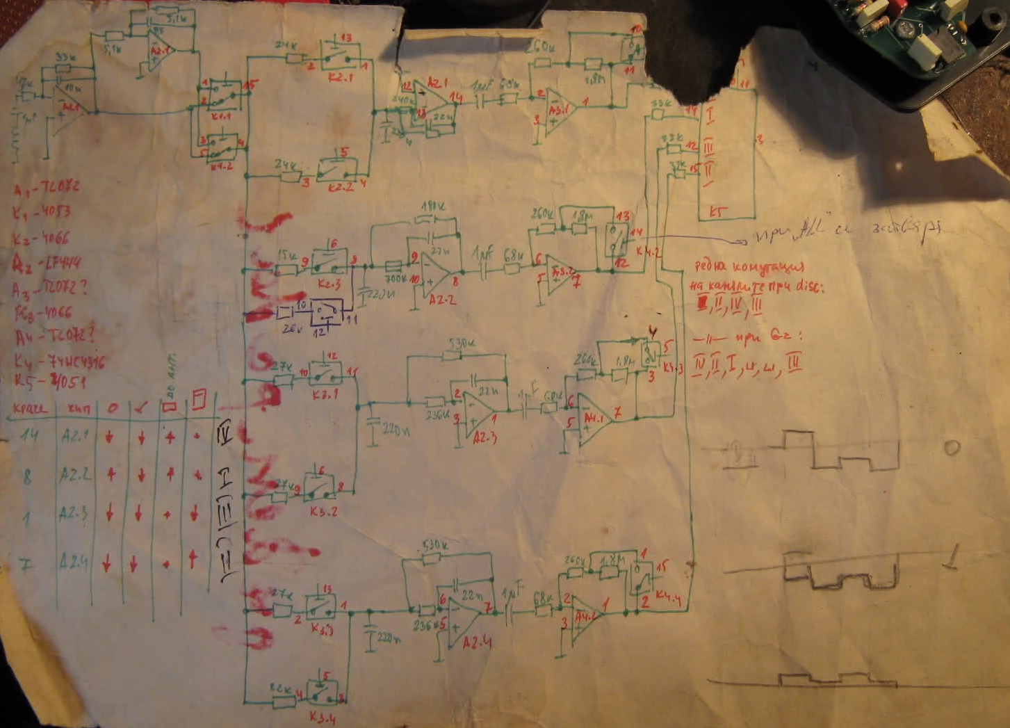

                        This is schematics i have but not sure what kind of sovereign it is.
                          soweregin TX output stage is wrong. The schema in the web does not work incorrectly. I would be glad if you draw the correct one.
