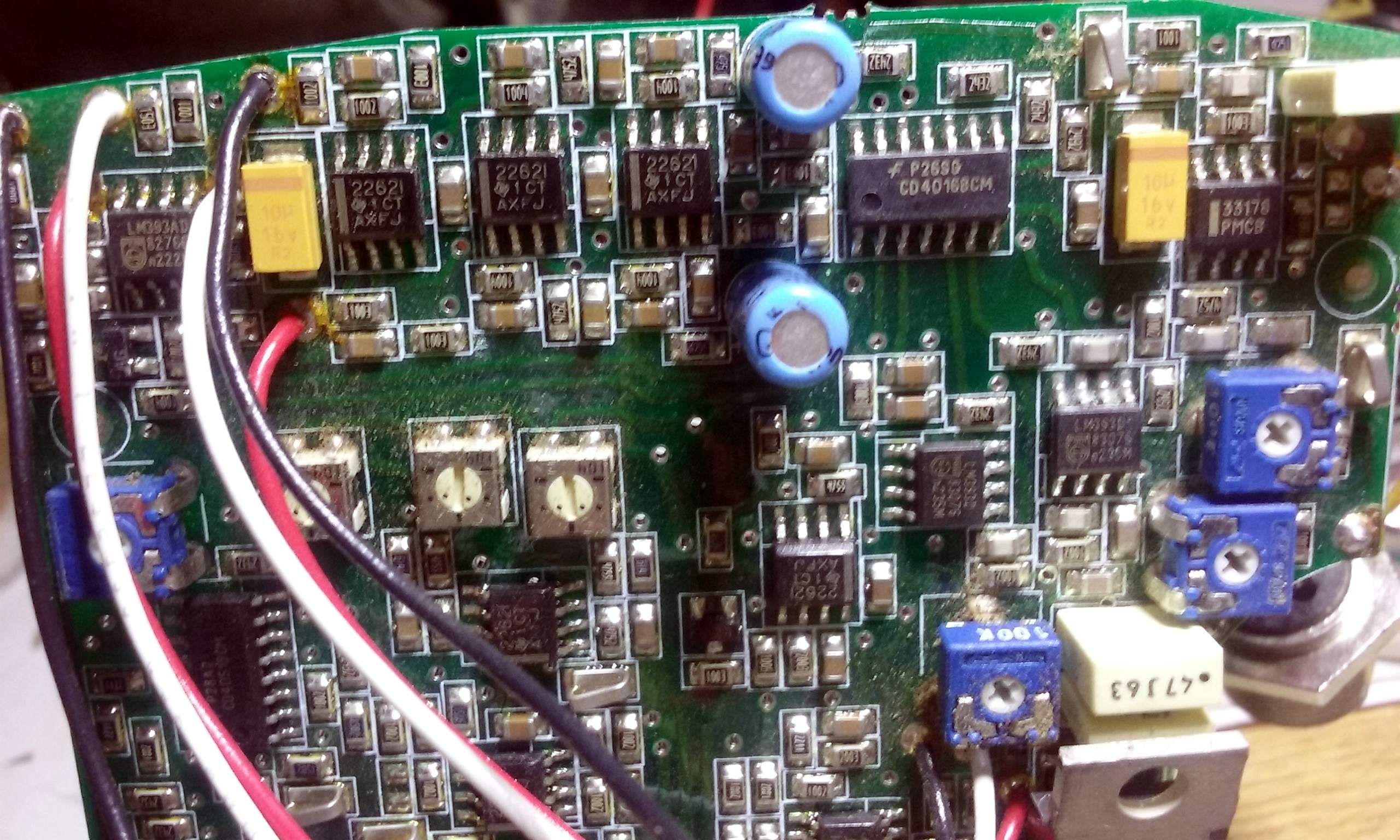

    Don't know... something is fishy in this behavior.
    Seems like picking up too much noise.
    From time to time seems erratic.
    No GEB on front panel.
    I am afraid that a lot of labor is waiting for me here...

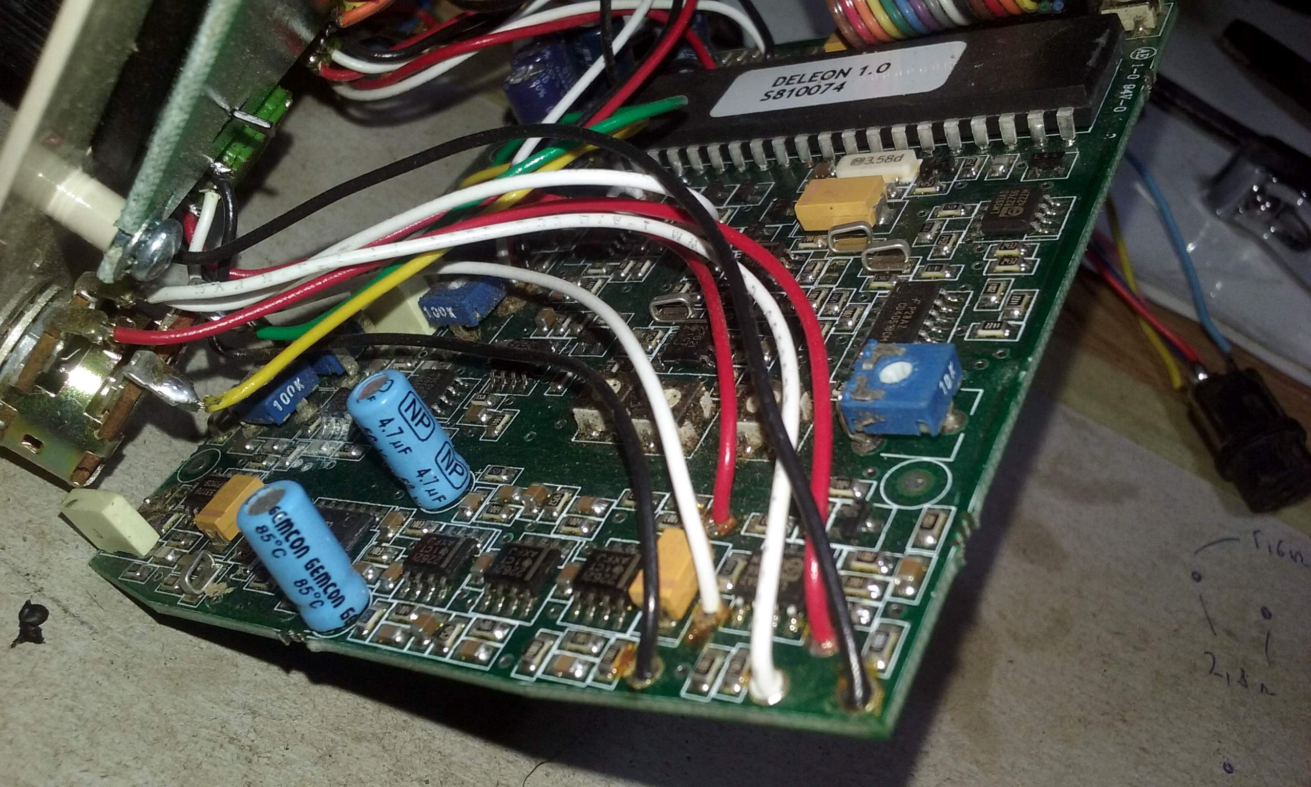

      Maybe some leakage on PCB, by dust and dirty collected over time.

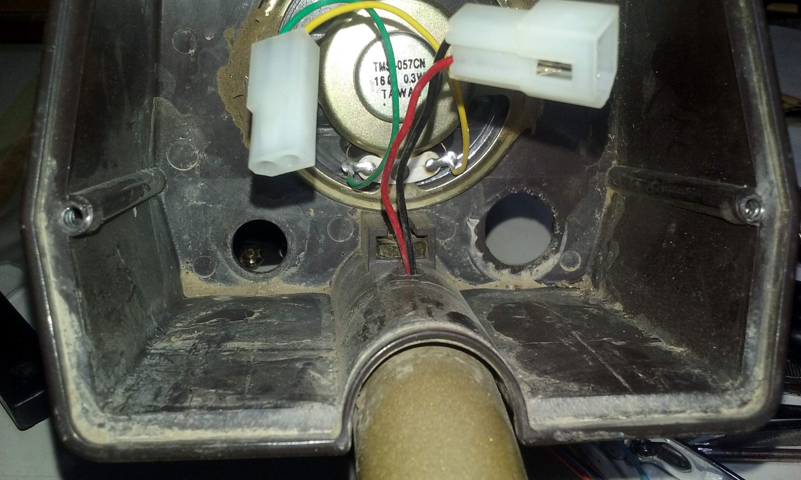

        Lot of dust inside.
        Dry mud at corners of box!?
        Like it was sunk into a mud!
        I cleaned all with nitro, washed good.

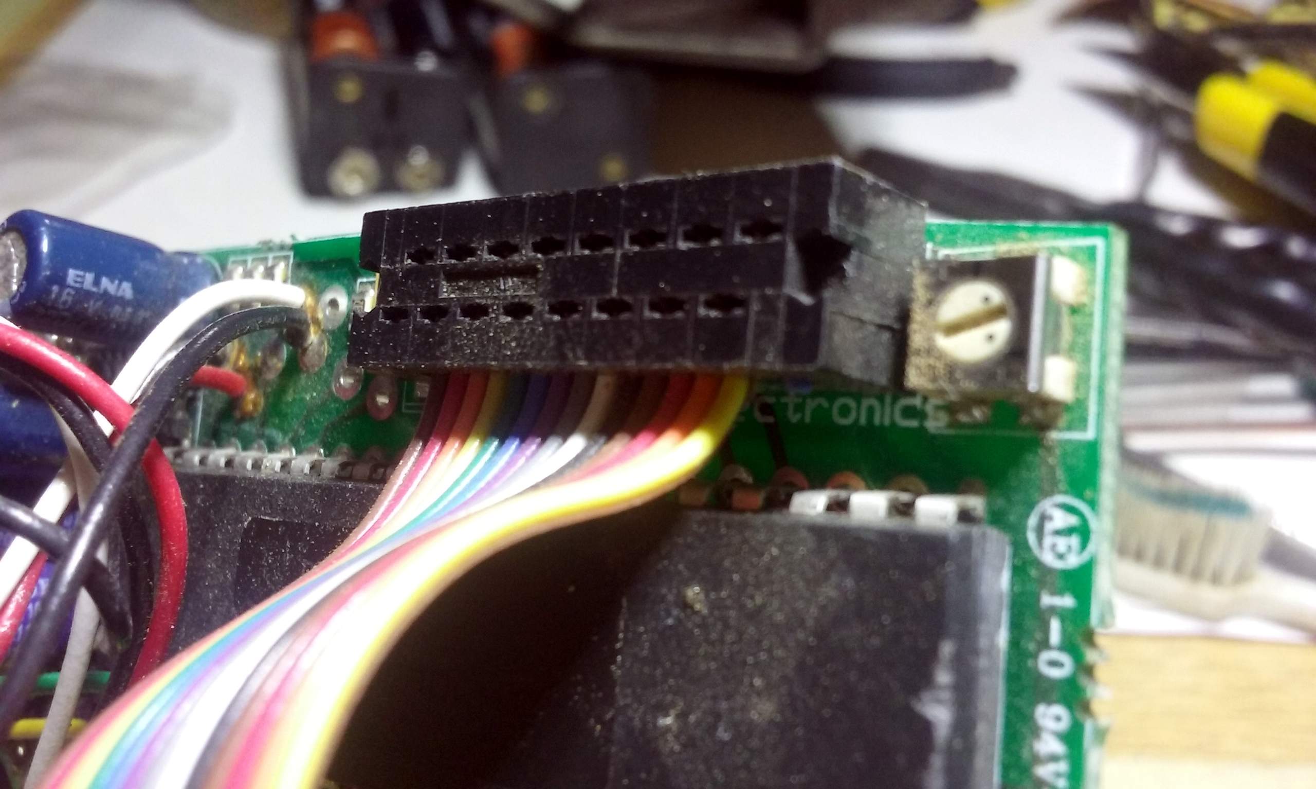

          Lot of dust inside.
          As i thinked. Even laquer didnt help... Nice fotos.
            Seems so. Last photo shows the mud.
            Now is kinda working more stable.
            Or is just my imagination under the influence of what i saw inside?
            I let it be and test it again tomorrow.

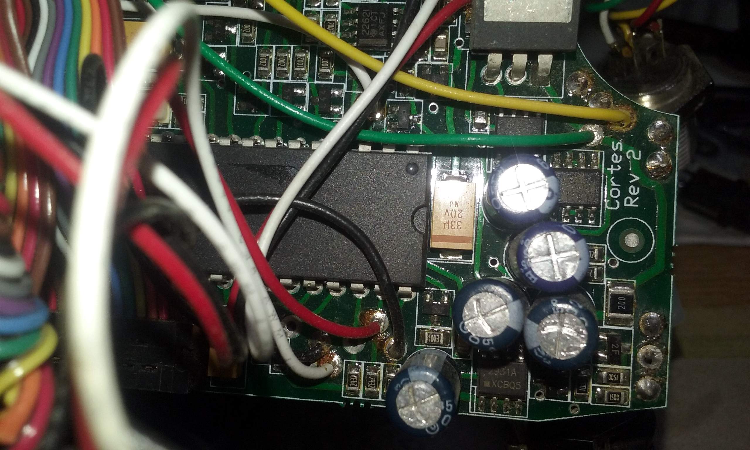

            But what really surprises me is the coil.
            TX= 21.1 ohms / 6.38mH
            RX= 22.9 ohms / 6.20mH

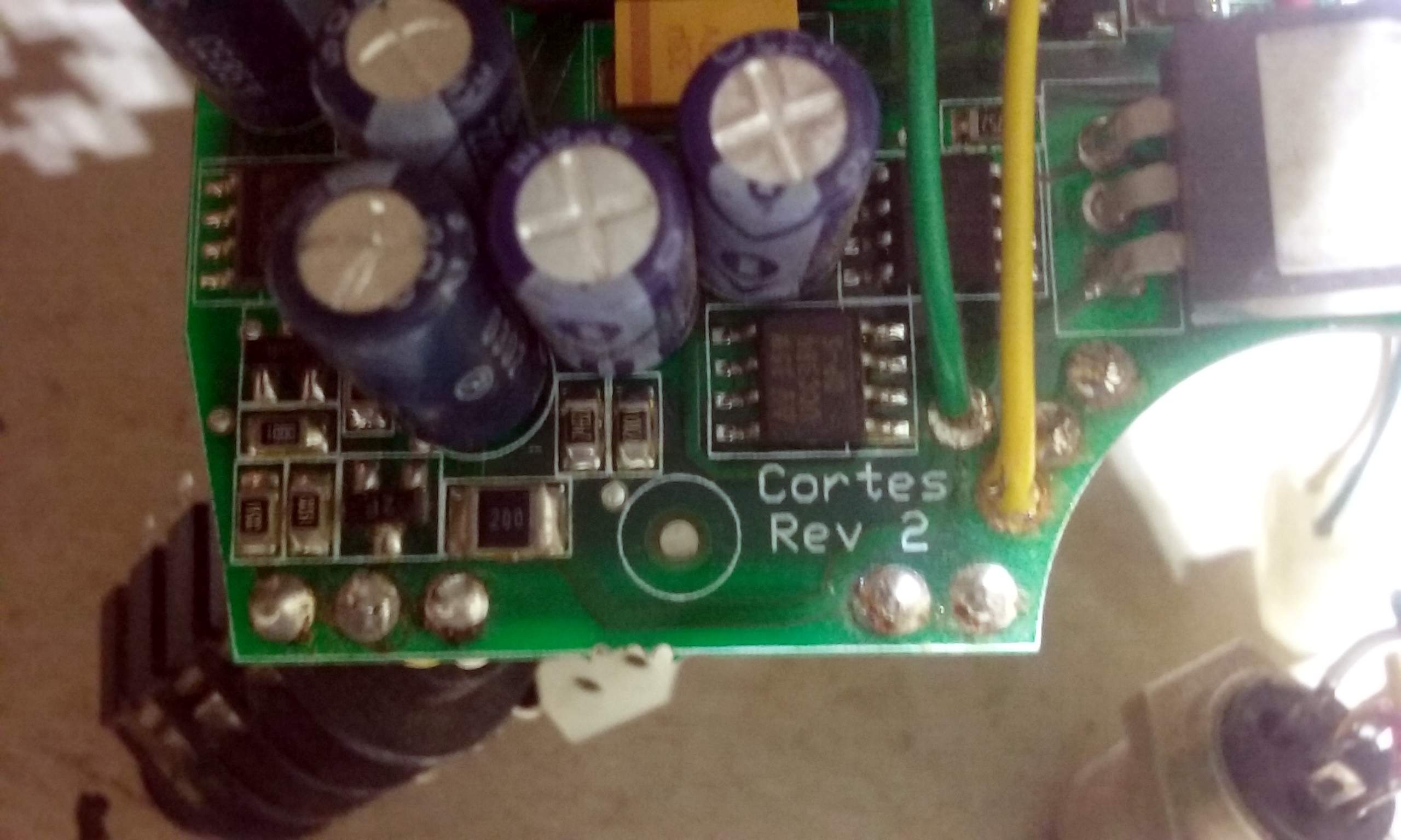

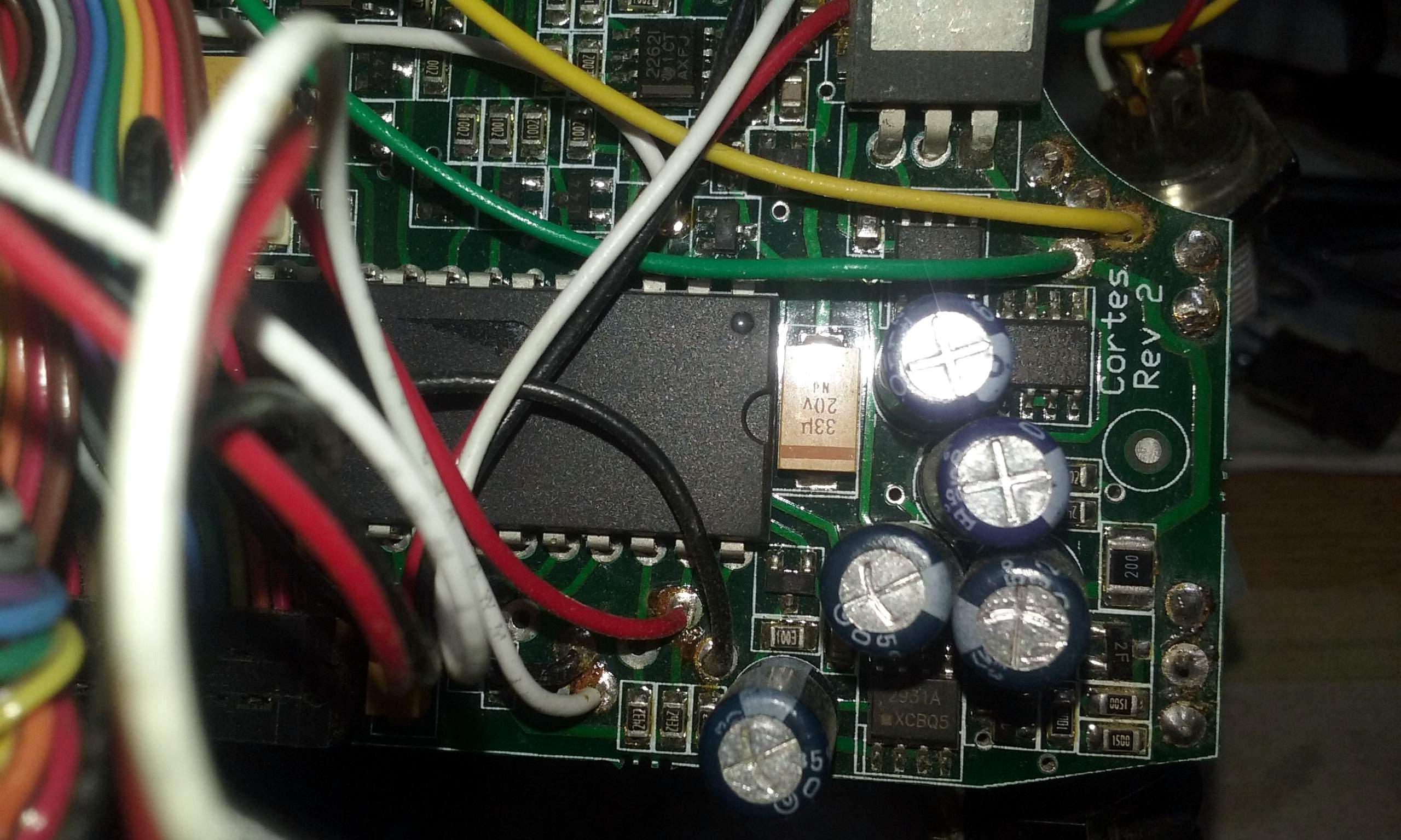

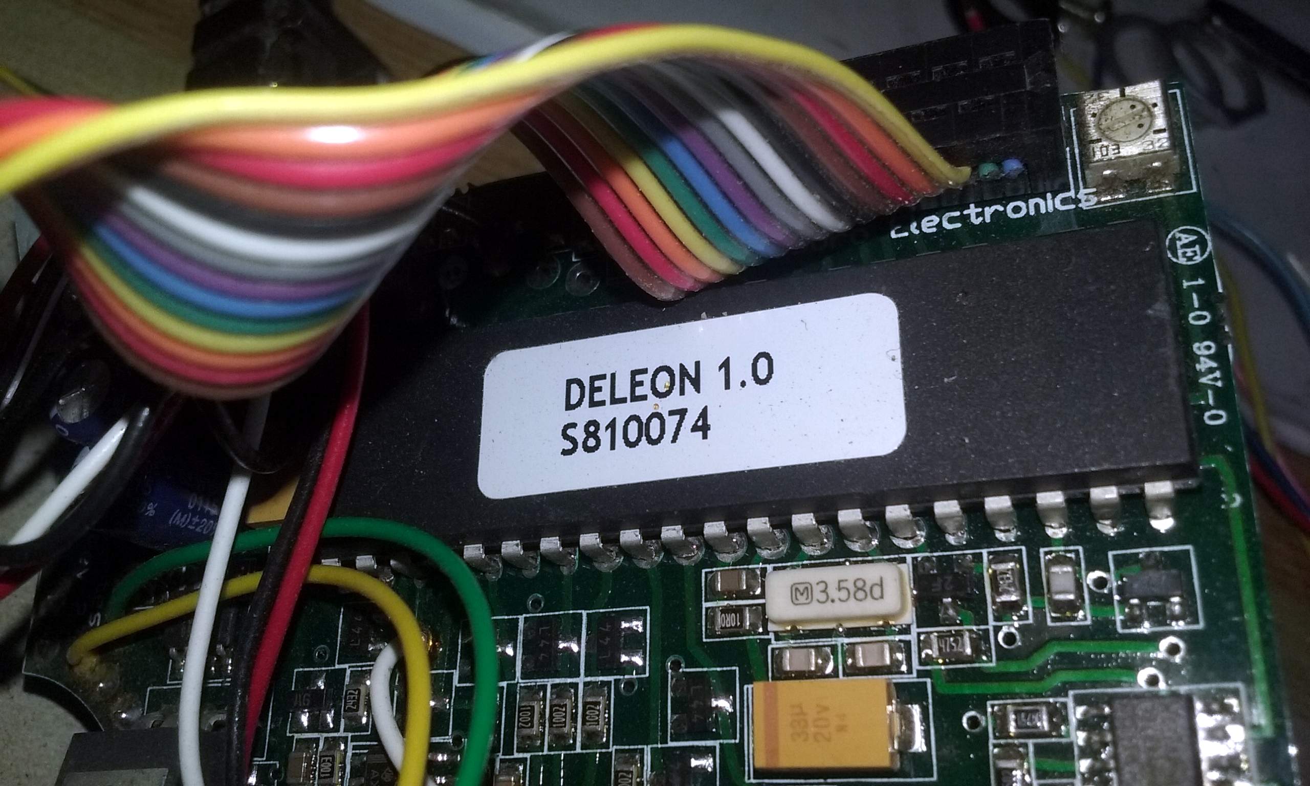

            uPC is PIC16C74B-04/p, crystal is 3.58MHz.
            It says "Cortes Rev 2" on a pcb.
            Funny! Lot of news for me!

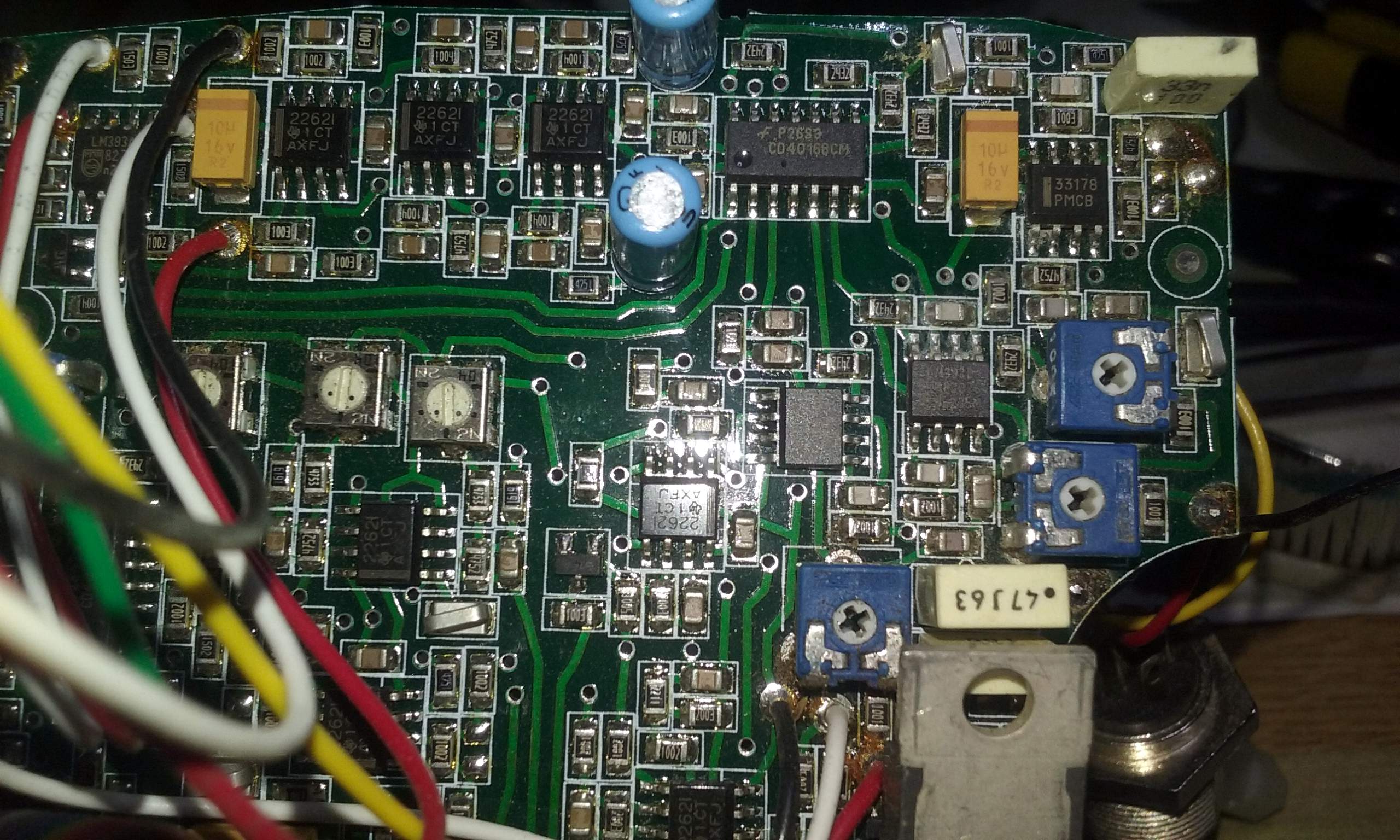

                Will have to dig out which one from those trimmers is GEB.
                It is hard to trace this, too many wild wires around, looks viable to crack and move from a soldering spot.
                This needs labor. To draw each wire place on paper. Just in any case.
                I hate this!
                Too much mileage under my hood... kinda tired of such things.

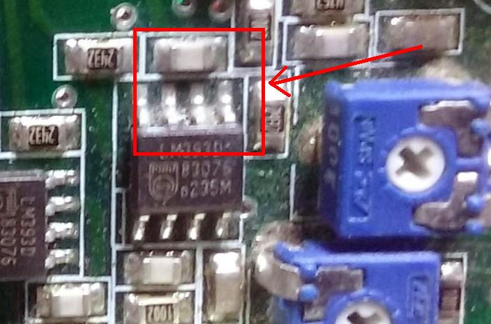

                  I think i solved the problem.
                  All 4 pins on one side of LM393 were covered with dry acid salty layers.
                  As well as SMD capacitor above it, totally covered and "masked" by "salt".
                  So i washed that area good, with nitro. Now is shiny and clean.
                  By now detector behaves correct.
                  Will see tomorrow.
                  Photo:
