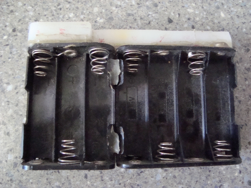

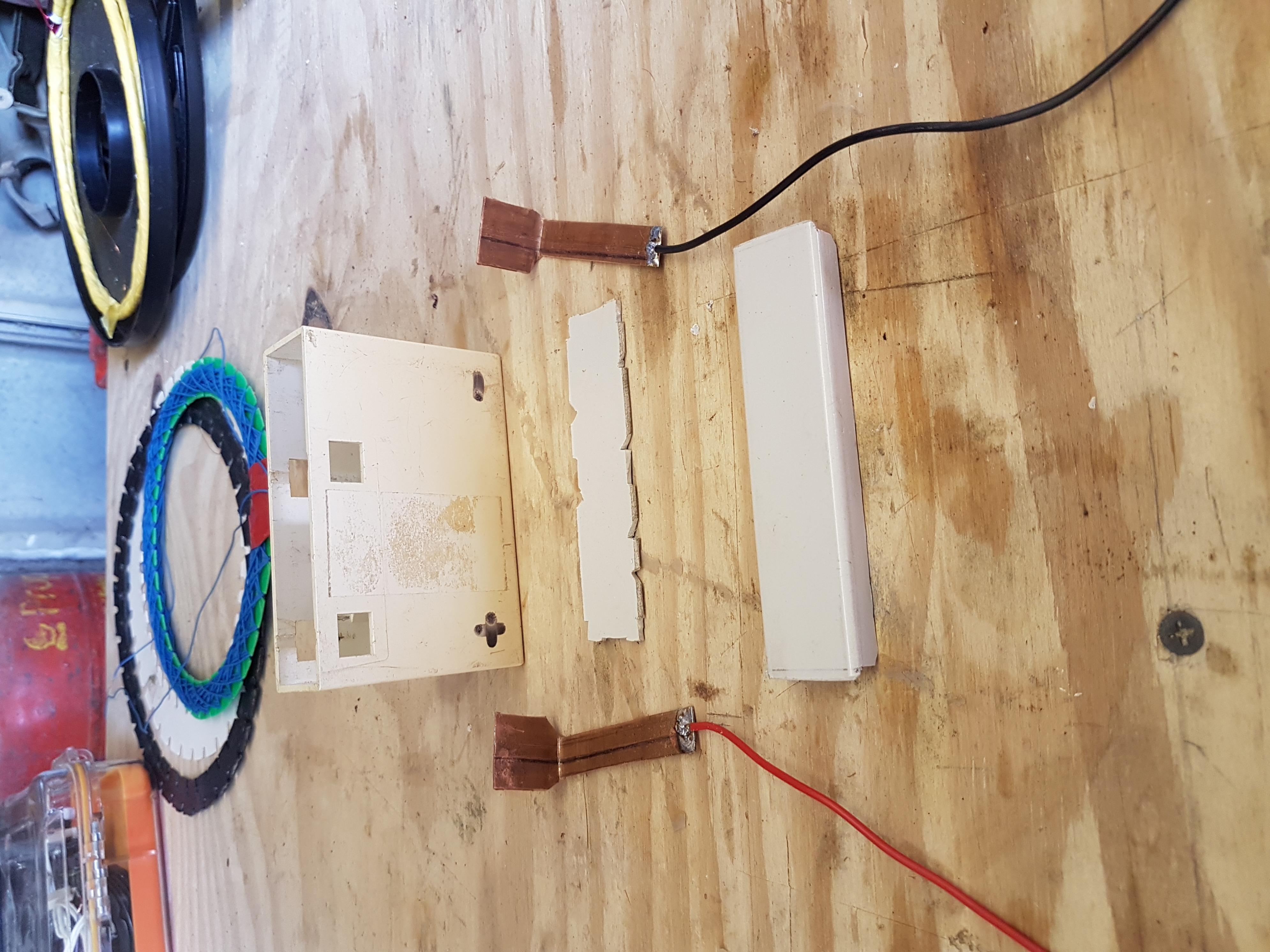

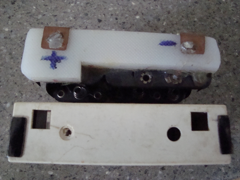

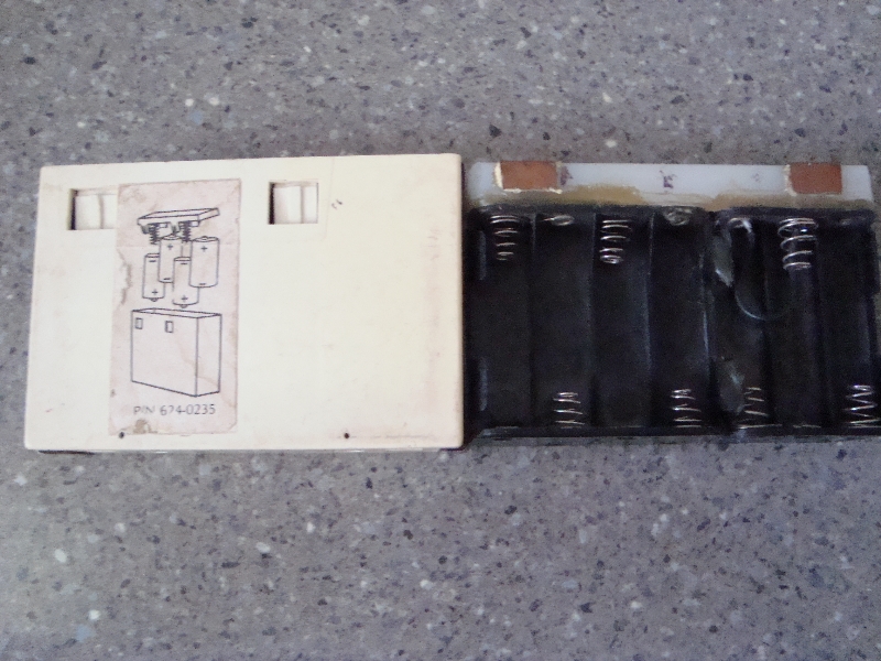

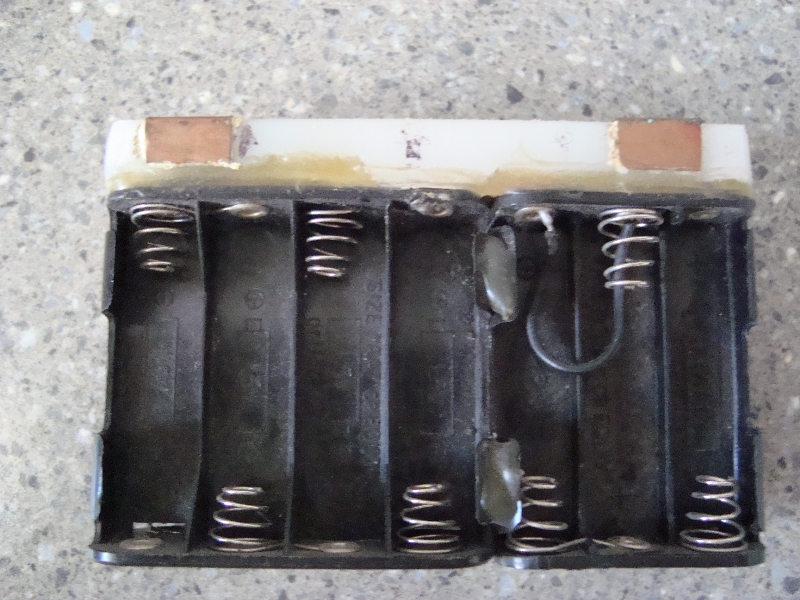

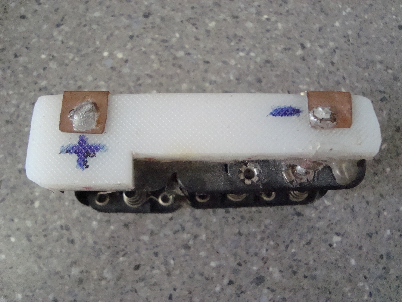

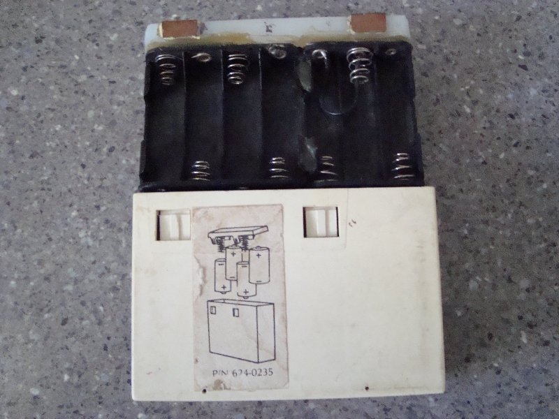

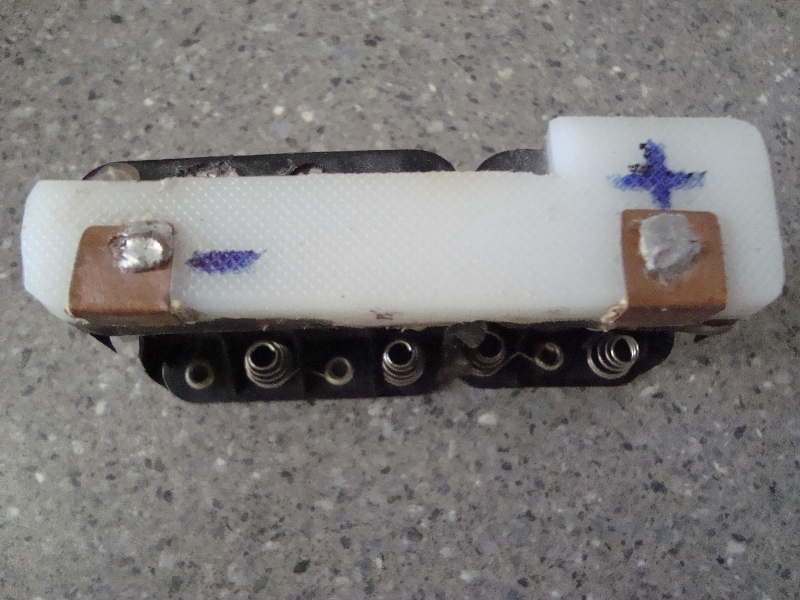

              I solve the battery problem by using 3 sets of 4 AA 2200 mAh rechargeable batteries in parallel.
              I hot glue together an 8 and a 6 cell aa battery holders and rewire it.
              it fits perfectly in the spectrum's battery spot.
              look at the photos.
              you get hours of power with this set up
                good idea nickel n good job looks like i have a few options, got a few rechargables kicking about i have had the spectrum (rainbow coil) over 15 years had ace 250 but still prefer the spectrum, thanks very much for sharing your fix.

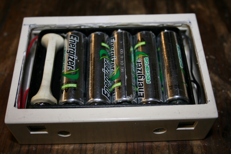

                  Attached is a photo of the battery pack mod I did to keep my Eagle Spectrum going. I removed all four contact springs cemented the access cover on. Then, cut a hole in it’s top and nested in a battery holder from Mouser secured with VHB tape (the leads of which are soldered to the original terminals of the pack).

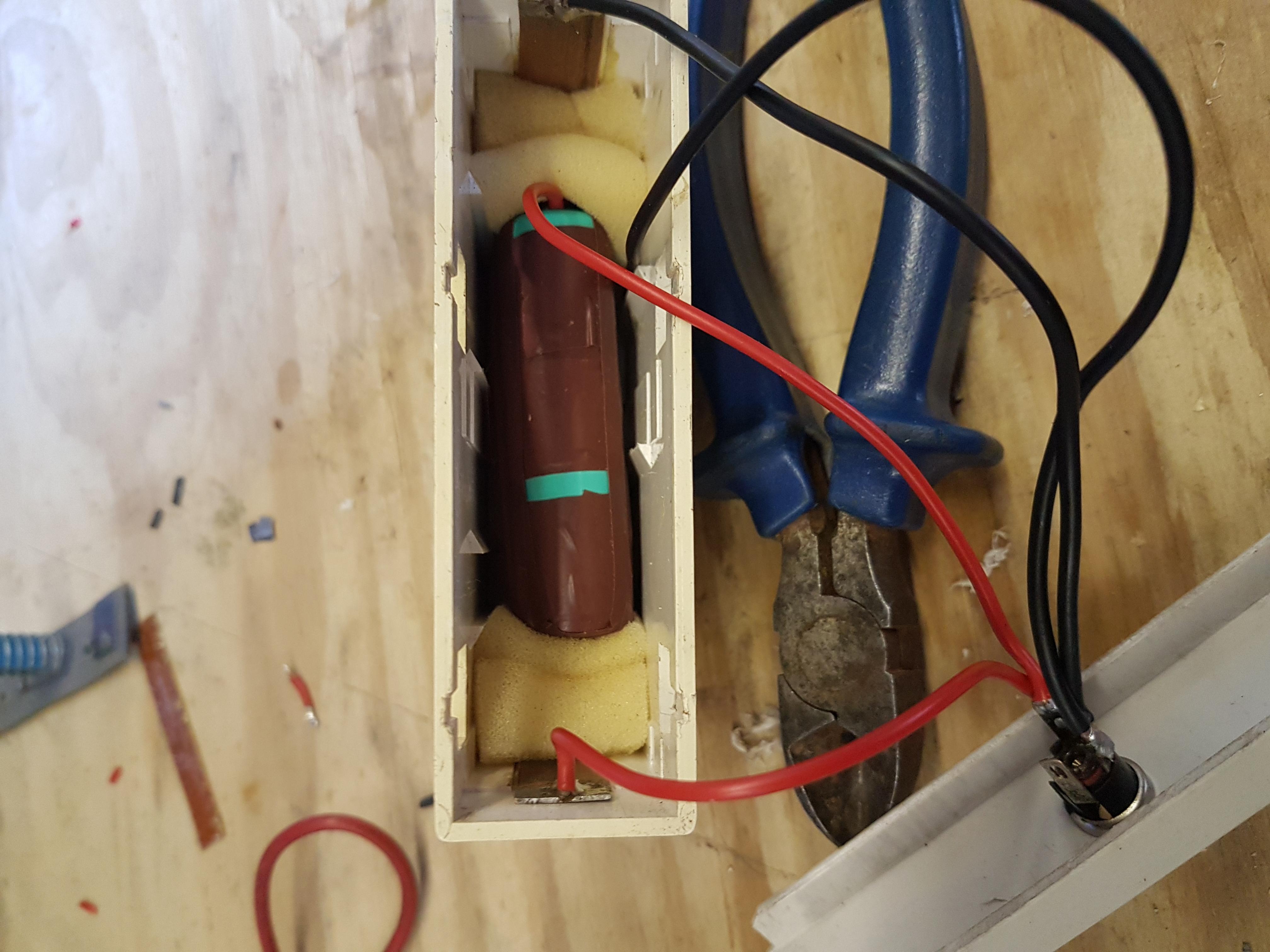

                    hi TH'r excellent job, spoiled for choice at the moment im grafting 2 1850 li-lon tried 4 but just to tight will post when done, yours uses 5 batteries or 10 at 6v sorry dont know what a mouser is, many thanks for your post.

                          hi skippy, do you mean link the batteries with the 1n4001 dose that apply to li-lon batteries to, i have just linked mine, 7.4v but in reality it ended up at 8.2v for some reason tried the pack it works well dont know how long it will last not tried it in the field yet should be better than crappy niClick image for larger version

                            dont know what happened to the pics i will try again Click image for larger version
ID:	357340Click image for larger version
                              "Do you mean link the batteries with the 1N4001 diode?"
                              No, the diode goes from + to - on each cell in the pack.
                              "Does that apply to Li-lon batteries too?"
                              No, if you've reverse charged a Li cell, you've clearly done something wrong. This is what battery protection circuits are for.
                              "I have just linked mine, 7.4v, but in reality it ended up at 8.2v for some reason"
                              3.6 Volts or 3.7 Volts is the typical cell voltage when you are discharging it. When you charge it, most standard chargers charge up to 4.2 Volt per cell, making the two-cell pack have 8.4 V direct from the charger. I suggested ( in an earlier post ) deliberately under-charging the Lithium battery to 4.0 Volt per cell. But if you are using a standard commercial charger, you cannot normally do that.
                              "I tried the pack, it works well"
                              Good.
