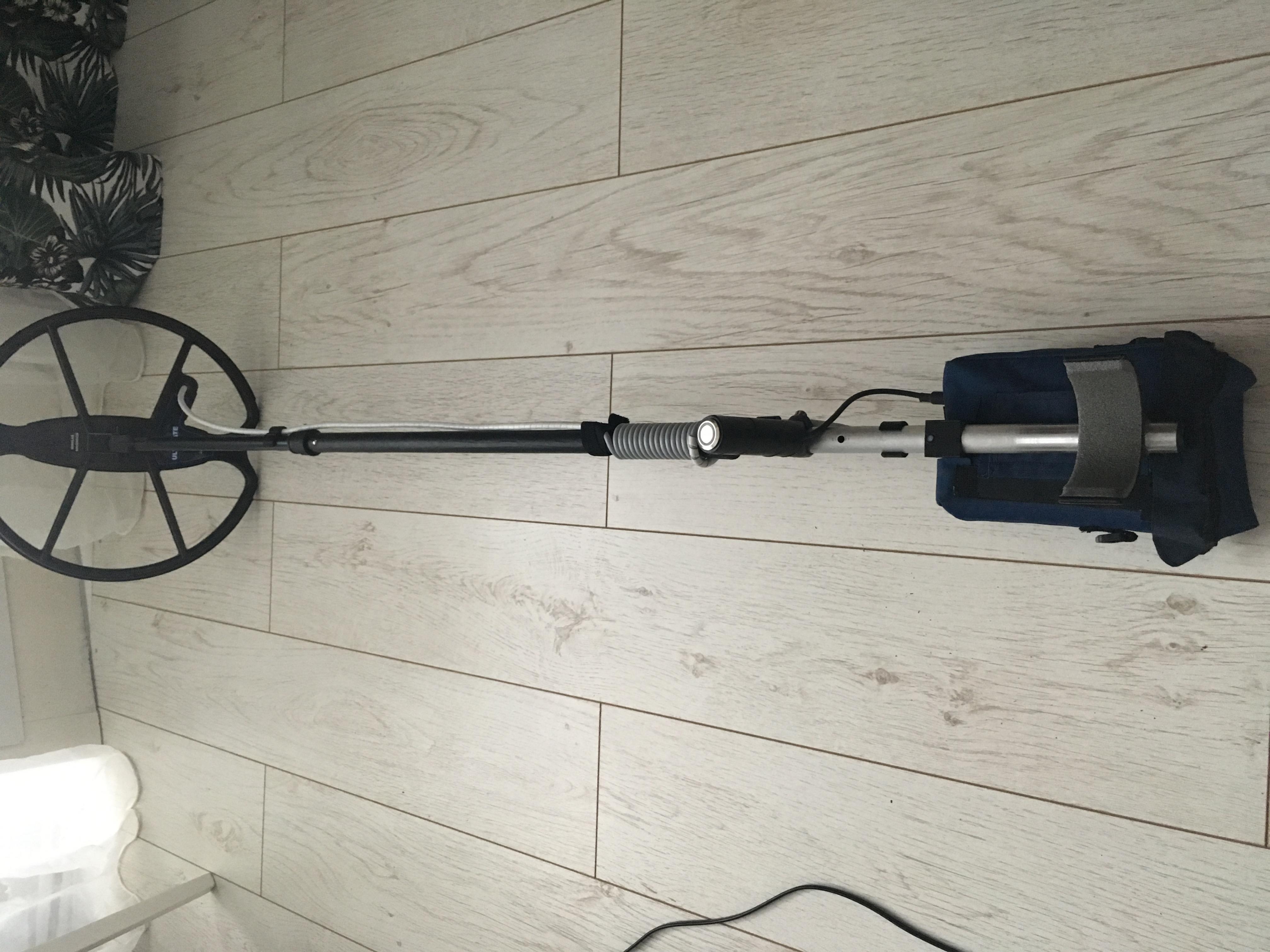

    Evening to all i was wondering if it was possible to realise an AM/Discri mod using a wireless push button(on the handle)?????Does it exist is it easy to make ,would love to put something like that on my future sovereign.

    Possible but really not worth the effort.

      Agree, i just use a pur insulated cable with a 3.5mm jack& socket.

            I know this is an old post, but I had to put my 2 cents.
            I used a 3 terminal, momentary button, that had a N.C. (normally closed) and wired it to all metal/disc switch, using a 3.5mm stereo jack and cable.
            The result, when connected, would switch the Sov to the opposite of its setting. If it was set to pin point, it would got to disc. If it was on disc, it would switch to pin point. But when you pressed the button, it would switch to the opposite. It still a beautiful system.
            The 3.5mm jack that was used, had a switch in it to make the circuit normal when nothing is plugged into it.
