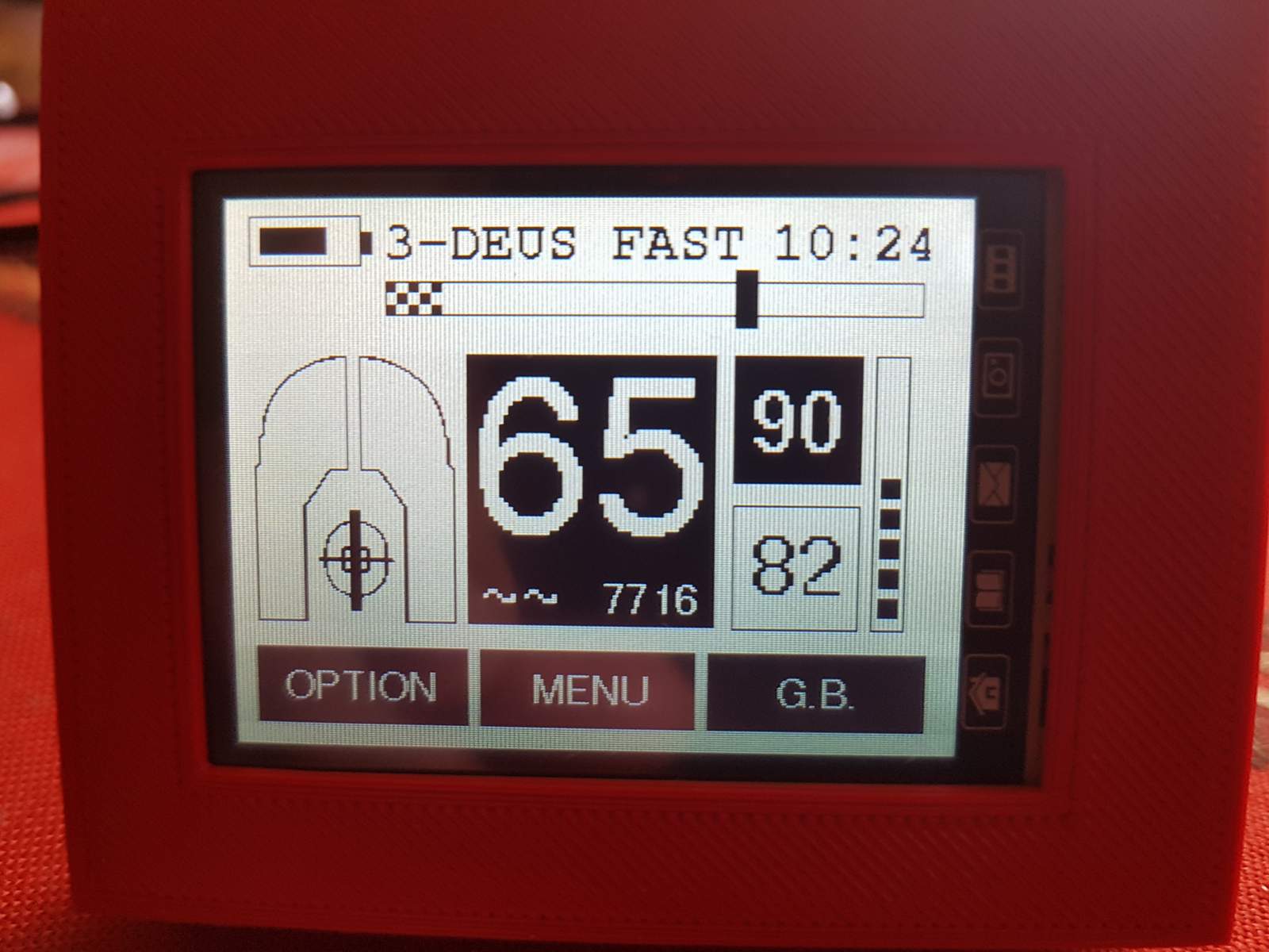

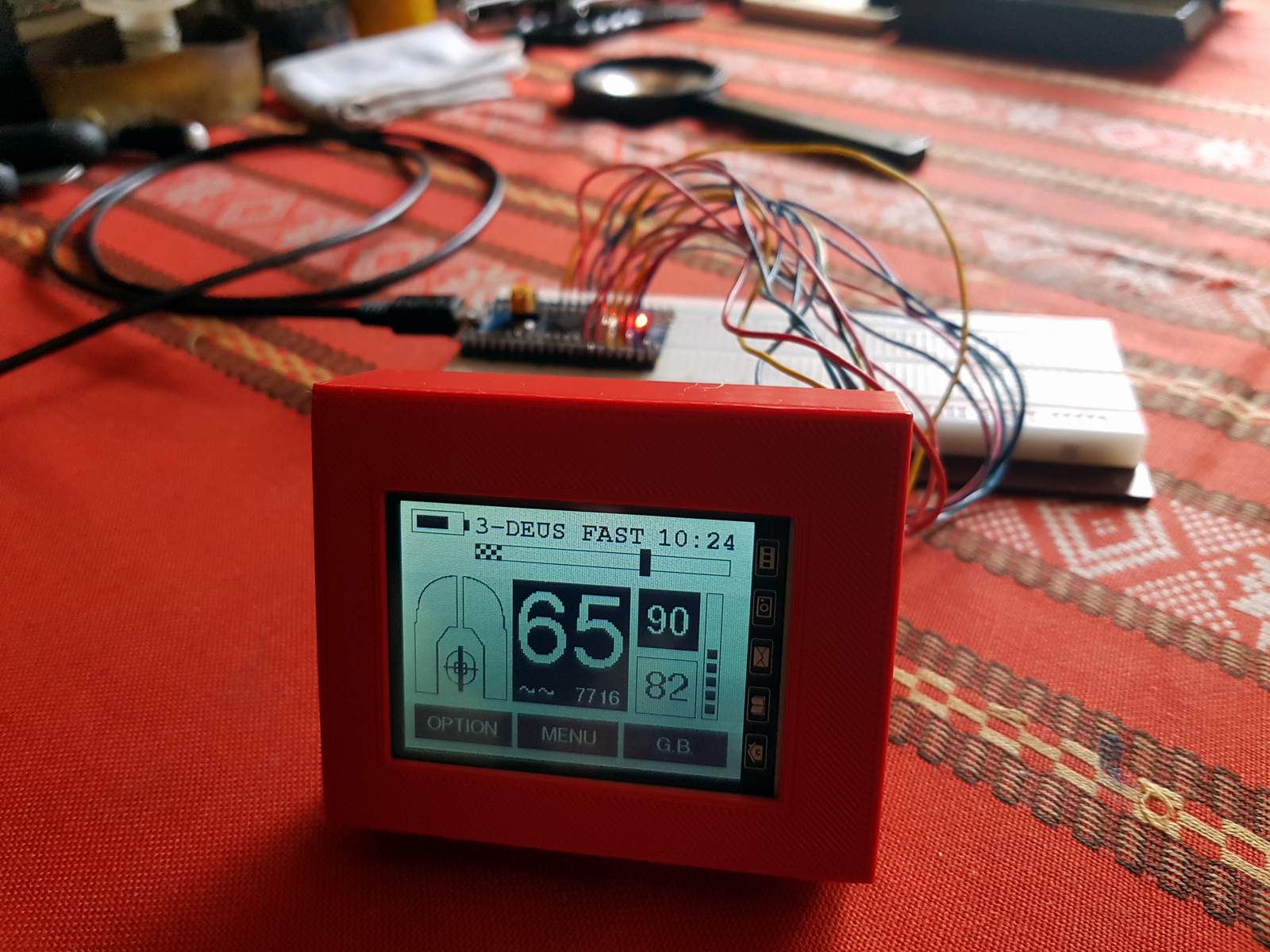

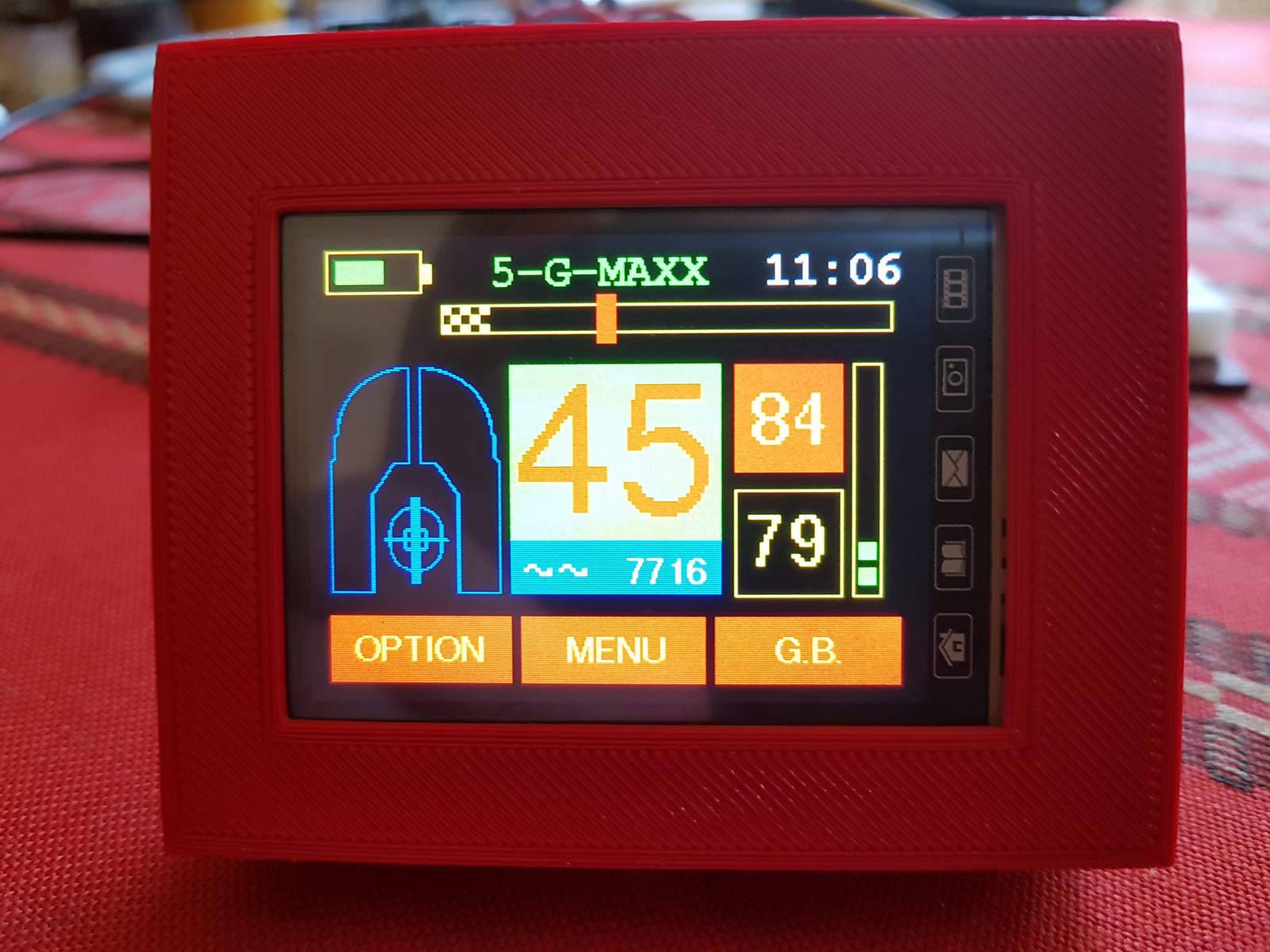

            Still nothing finished. Working on GUI still.
            After that will do some serious processing.
            I don't see the STM32 as most brilliant choice for this, it is just temporary solution.
            Until my newest EPSP32 development board arrives.
            But 320x240 will always be 320x240, so GUI made for it will remain actual on ESP32 too.
            All the screen elements are separate objects. Not a simple bitmap. But separate active objects.
            And that's what makes it indeed hard and tedious to do.
            I used bitmap only for a "horse shoe" lookalike graphic at the left side of the screen.
            It eats the memory so i will expel it from final solution.
            Goal is not actually to replicate the Deus, what's benefit from that?
            Goal was to start from scratches and during the process to build up something new.
            Deus GUI was just starting template.

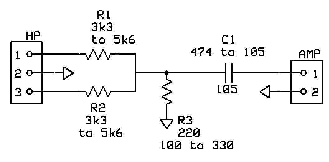

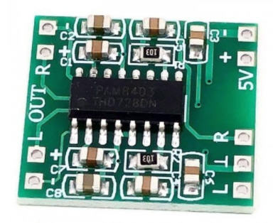

                  Coca Cola lookalike can perfectly match as possible enclosure for the active side of the phones.
                  Also can be 3D printed anyway you like.
                  As for amplifier; beware to match properly the audio signal levels.
                  Plenty low consumption integrated amplifiers.
                  D-Class especially. Work for hours on 3.8v.
                  For example PAM8403, 2x3W, 2.5-5v working voltage.
                  Beware when connecting a speaker, don't use common ground but only dedicated output pins.
                  Once in the past i had Minelab GP3000 and was annoyed by its headphones, so i added small box with LM386 (at the time cheap D-Class modules didn't exist on market) and small sort of a bootstrap level matching.
                  It worked like a charm.
                  You may try to experiment with the values to perfectly match the levels.

                  On second thought... such D-class amps are horrible source of any possible noise and may disturb the Deus BT transmission, so it is maybe better to use good old LM386 with 20x gain, should be enough.
                  I have several BT battery operated speakers. Almost a rule that there is a D-class amplifier inside, small consumption and high amplification level. Usually works crystal clear, no noise at all.
                  And BT is not distrubed.
                  So i don't know how they did it?! My attempts with such modules were total disaster. PAM module on one of my attempts totally "blanks out" the BT transmission and introduce horrible noise and whistle at the output side.
                  I tried everything, i put voltage regulators and bedlam of filters everywhere; i can't get rid of whistle!
                  On one of my last attempt i put 4 chokes and 2 voltage regulators and all what i got is 60% attenuated whistle.
                  So... better to walk the proven paths; LM386 with small gain will work like a charm, as always.

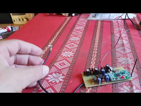

                    Disaster:
                      And later with heaviest filtering that you can imagine... yet still there is a mum whistle:

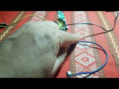

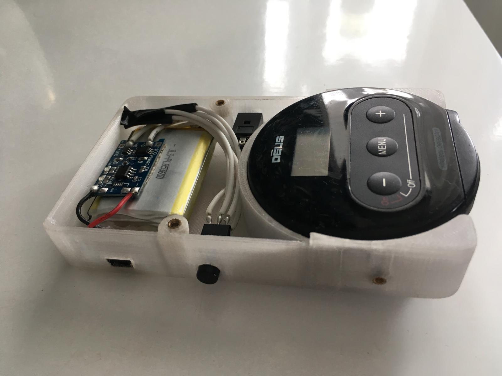

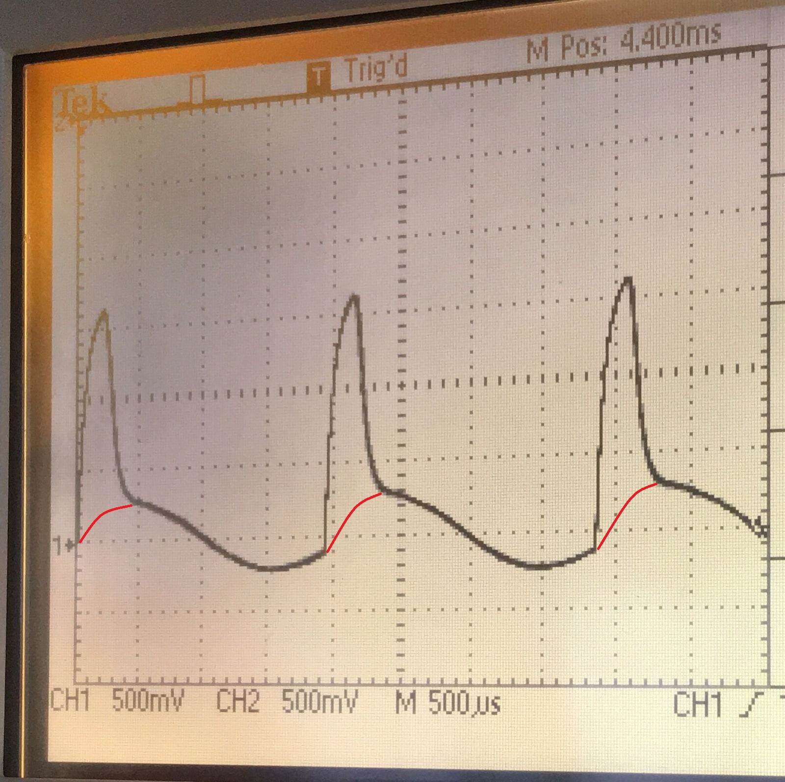

                          My project is 3d printed. I want to make it small and as nice as possible. Li-po, charger, miniusb, headphone output.. Ws4 is mono output, the headphones are 32ohm paralel= 16ohms. I ordered some cladd D amp modules (1-2W) and thin speakerd from aliexpress. tried some but gain is not enough. (don't know why) Deus remote has 8ohm 0.5W speaker but i don't know what ic has for audio. It is very loud!
                          I must research about class D noise. I cannot use lm386 because supply voltage is >4V and i need a small circuit.
                          Pam8302 on the way
                          Xpt8871 on the way
                          5128 on the way
                          Hxj8002 - sound not enough
                          Ns8002 - sound not enugh
                          I must do something wrong.
                          Osc signal is with max volume on ws4 and target waving on the coil. You can see some spikes and signal at max volume aprox 500mV peak to peak.

                            Part of the "trick" with loud remote sound is in enclosure resonance too along with excellent speaker.
                            Also perfectly optimized output.
                            Strangely enough; i never opened my remote during these 9 years, so i can't tell what's the audio amp.
                            I saw some photos done by other people but also can not say about the amp.
                            Playing with Arduinos i know that even a chip itself can produce loud audio on digital pins and only 2 transistors in push-pull configuration.
                            TDA7231 can work from 1.8v for example, i tried it.
                            Next is LM4818 which provides extra loud audio at Garrett Aces. But 6v supply.
                            MC34119 can work from 2v supply and above.
                            Don't know many other chips, don't following new trends.
                            I think that you should try bootstrap simple schematic that i posted and adjust only the values to match line level input on D-class amp.

                              Many thanks Ivconic. I added just a 220ohms resistor paralel to 8002 amplifier input and now is loud and clear. I have to monitor consumption as it is class ab. Anyway class d amps are on the way and i will test those also.
