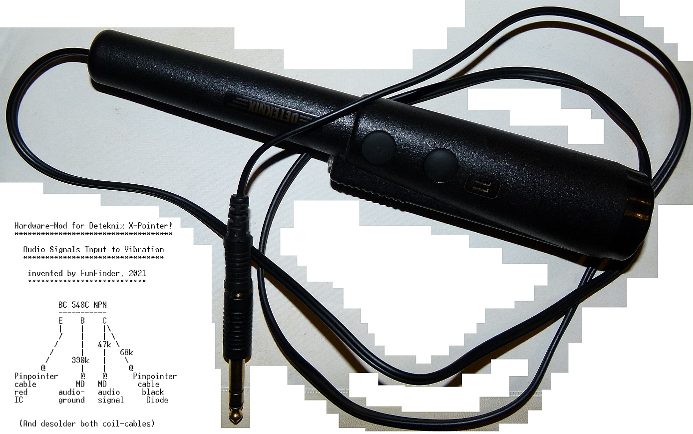

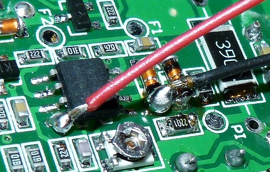

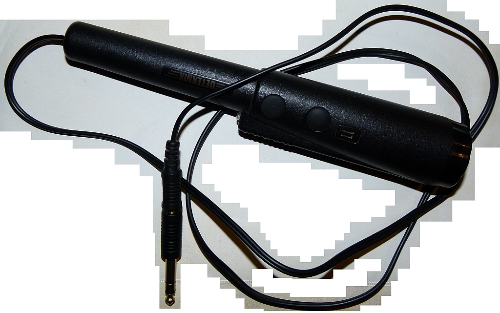

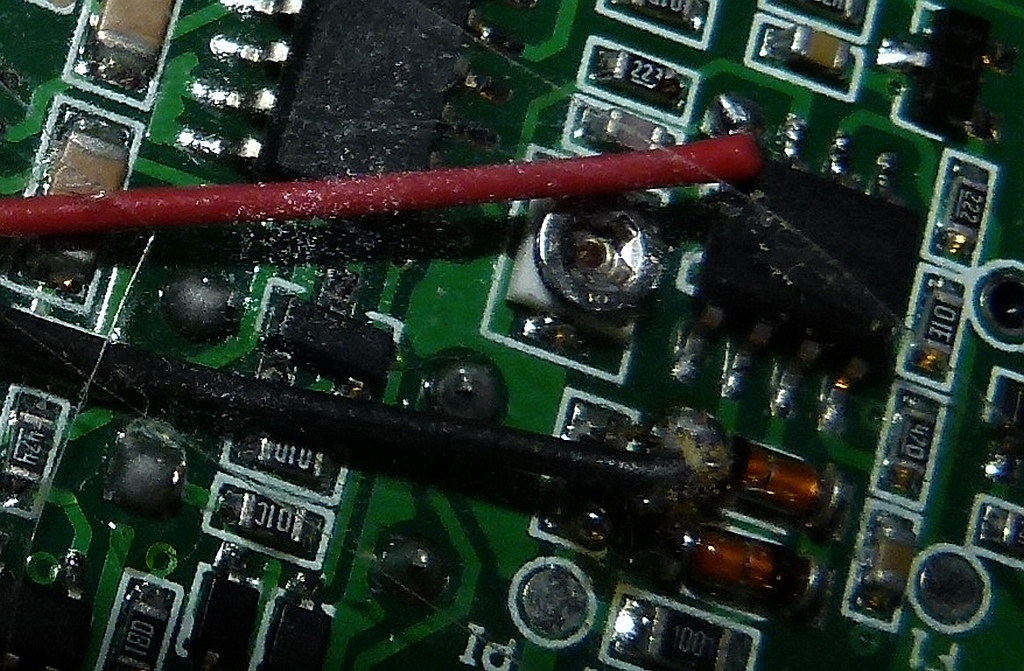

    Anyway, it took me ca. 20 hours for creating this modification. But if you have a Deteknix XPointer or if you reply to
    this posting as an interested person, I might show you the "magical trick" - because thats the deal of such a forum -
    providing others with USEFUL informations - isn't it ?! You had to wait already anyway for it since the 14. May 2021.

        OK, first a short info about vibration-detection itself:
        In the beginning its about a little bit more "fine-feeling" - per instance with my
        screw-adjustor at the Garrett-Pro-Pointer I can easily reach the doubled depth
        but not in any soil. The critical-signals even start to react on pressure and
        mineralized stones or when the screw was just 0,1mm pressed too far.
        btw. without modification you can't use the Garrett Pro-Pointer seriously.
        You will start to dig 20cm deep holes while the find is just 3-5cm away.
        And you will have at least 2 liters of whatever more of weight with you
        cause listening to music while working is no fun without a drink nearby.
        reminds me on the joke:
        A construction worker falls from the roof and his colleague cries:
        Hey, leave the bottle-opener here!
        And:
        If you use vibration its good if you can control the ground-balance or directly
        re-adjust the sensitivity with one button-press, so the coil really IS sensitive.

            Vibration detection usually has the advantage of avoiding noise but thats useless if you hit with your shovel rocks or
            stones while digging and those make much more noise! Hahaha! So you have to learn to dig as careful and quiet as
            possible, especially at night or nearby houses, roads and streets. Its also better for the animals, flowers and bugs
            and for leaving no traces behind. Create a small corner with 2 shovel-stabs, clap it out, get the find and close it as
            never would have happended there anything at all. Hahaha - sorry, again I can't tell you more ...
            Just that I could dig out all the gold-bars from your garden and you won't see the next day anything at all! Hahaha!

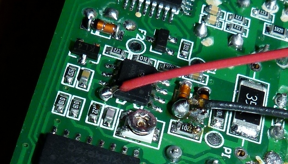

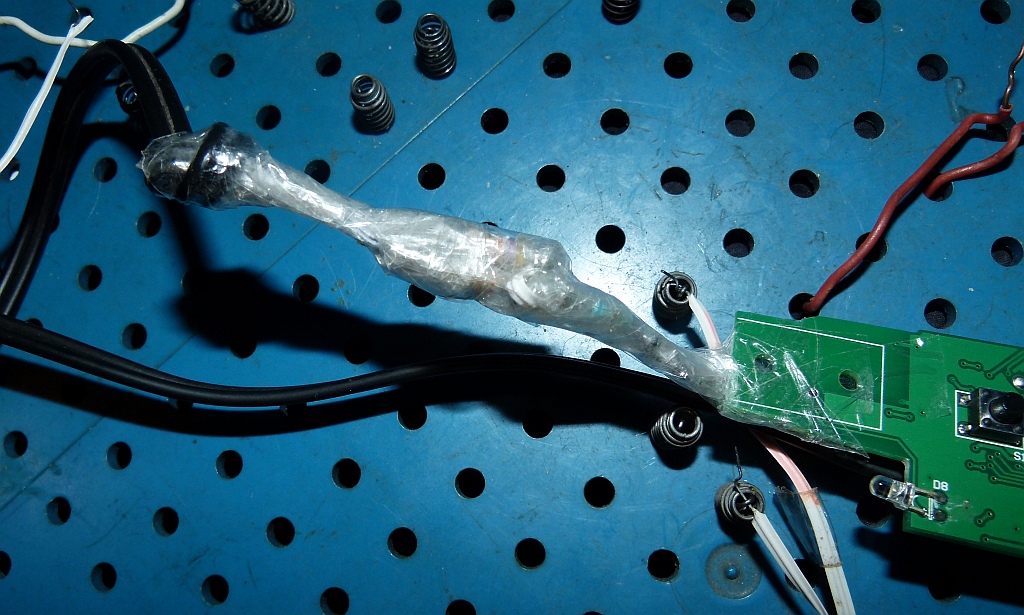

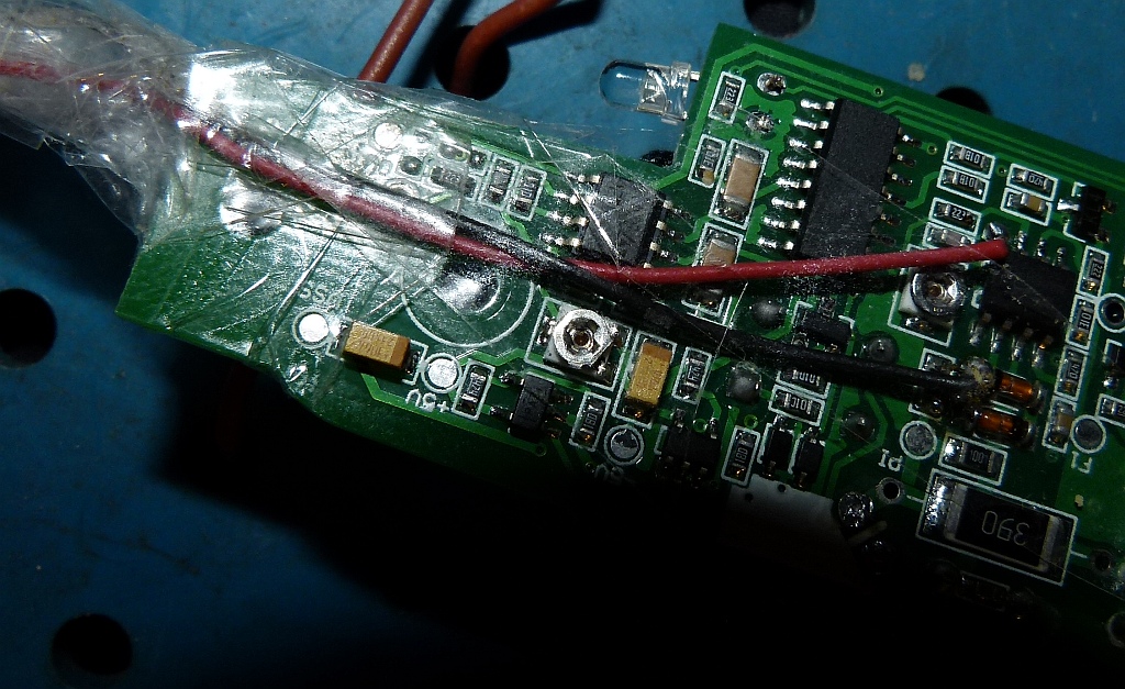

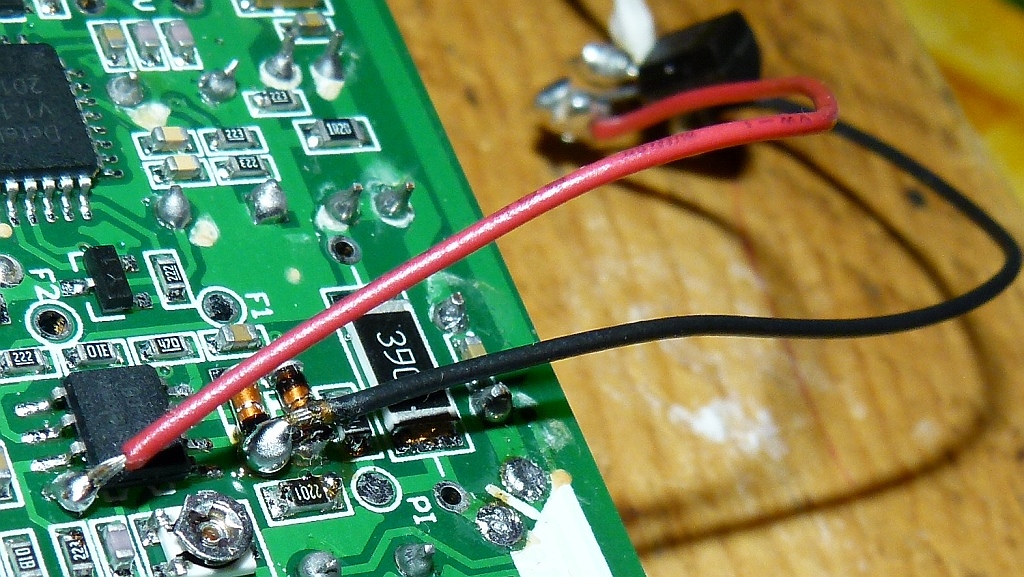

            Funny story: I made this mod just because I had no spare vibration-motor and I wanted not to destroy any pinpointer
            for it. I had not enough motivation but you can add a switch and put the electronic parts outside and you can still use it
            as a pinpointer or as a 2in1 device. Besides the already existing battery compartment is also very practical! Hahaha!
            I don't know if I've removed the piezo-beeper but usually the vibration signal is all you need for a pinpointer anyway.
            It contains also more information if it starts very slowly and then becomes stronger compared with the plain beeping.
            With vibration, drinks and music it is like within a movie and the finds are jumping out of the ground in no time at all.

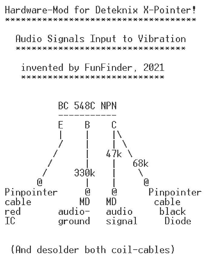

            Last but not least here's the Mod-info as text - this is a puzzle, you might need to add some space's first. Hahaha!
            And never give up hope for finding the huge treasure! Today I've found the perfect fitting picture for this attitude:
Name:	Never, never, never give up!.jpg
            But the frustrated guy would have been buried from all the crystals anyway, so it was better for him to leave!
            BC 548C NPN
            E B C
            / | 47k \
            / | | 68k
            / 330k | \
            Pinpointer @ @ Pinpointer
            cable MD MD cable
            red audio- audio black
            IC ground signal Diode

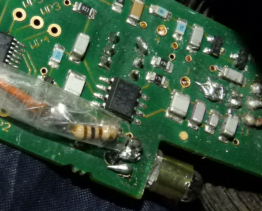

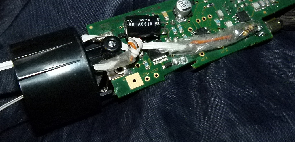

              By coincidence I found today another Pin-Pointer Mod which fits here - it was made in Nov. 2012.
              The problem was / for many still is that the white LED of the Garrett-Pro-Pointer was / is always on!
              Because the "enemy" can see this LED, per instance **** hunters who think they own the whole area!
              But with their sniffing dogs or googles they might still find you, so be careful, some are complete *****!
              I replaced the white LED with a red one and made it On-Off switchable.
              Instructions:
              - open the ProPointer but first rip out that on-off "gum-presser"
              - unsolder the white LED and solder a red LED at its formerly place
              - cut the plus pole PCB line with a knife where the LED was soldered
              - attach a cable with 100 ohm (brown black brown) to the LED's plus spot
              - solder a small press-button- or left-right-lever-switch to that wire
              - the second cable of that switch goes to the 9v battery plus pole
              - place that switch wherevery you want by melting it into the plastic
              - wind some electric-tape over the switch for dirt- and water-protection
              You can do this with every other pinpointer, too. This is just the method behind.
              For profis: hack some 7,2v LiPo accu so it fits into the 9v compartment.
              You can use it with an extra dongle, which has the 9v battery connections,
              then you can work for 15 days or over 100 hours with one charged LiPo-accu.

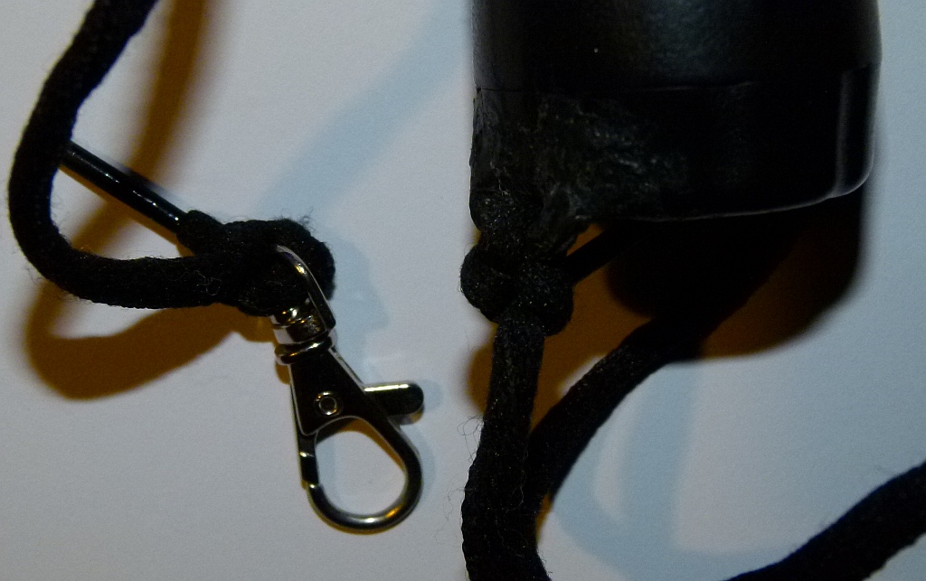

              And by that way solder some plastic part to the battery-cap with cord etc.
              Cause better attach this easy to lose thing to your throusers or belt by a cord!
