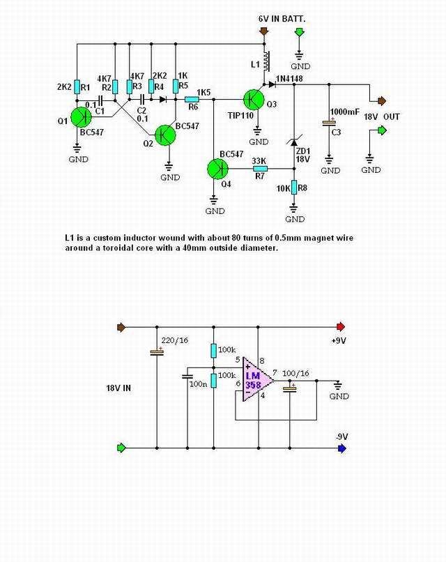

      I was tired of replacing those 9v batt. all the time...So i took one 6V / 1.3A accu. and made voltage trippler to 18 volts. On the output i put "splitter" with LM358 to gain digital ground and symetrical power supply....Audio stage i connected directly to 18 volts through one 7809 regulator....And that's all!!!
      This accu last over the 3 days on the field since Classic III (handmade) consume approx. 25 to 45 mA, dependable of working conditions....
      It showed as very usefull and good idea at the end!
      If any help than i'll be glad....

          Classic series use symetrical pow.supply +9v/-9v and separate 9v for audio,which makes 3 9v batt's...
          Although this setup is much useable for other machines too...

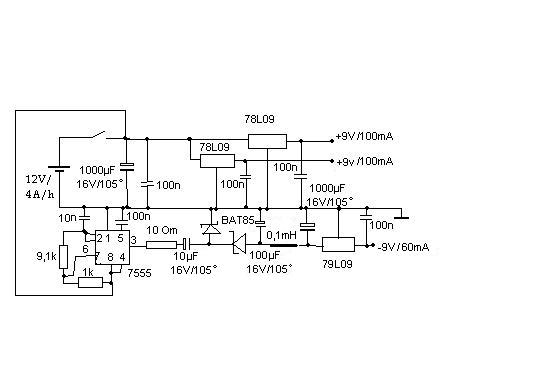

              power supply
              Hi , I use one schematic for long time and it satisfy my requirements for many voltages.
                Schematic
                Seeker you omited values...?
                Here is schematic of trippler i used. L1 could be a problem. You must use 40mm ferrite ring, otherwise Q3 can be very hot if smaller is used.Although once i managed somehow to make one with 32mm diamm. and TIP110 remained calm with 80mA power consumption from detector....
                That's how i supply my Classic III and CScope 1220B also, with one 6V 1.3Ah accu.....
                regards!

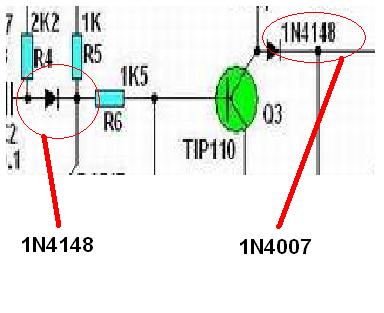

                  Oooopsss!
                  I always do make mistakes when in a hurry!
                  Here is correction....

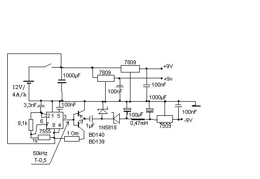

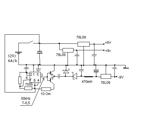

                    Hi Ivconic , sorry for my mistake, I draw schematic from my pad and watch TV. On the pictures are two variants. For up to 100mA and up to 1A.
