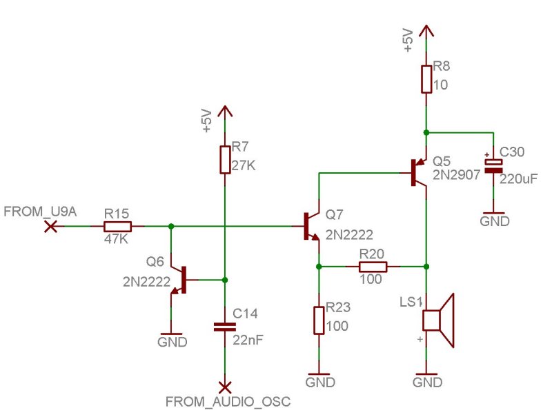

        Originally posted by hawk17966 View Post
        Positive(VCC) is wired properly,but labeled as ..7905.???
        Negative (VDD.....) is missing...
        There may be other errors in this schematic. Who knows?
        Perhaps someone here has built it.
        You are correct that the -ve supply is not shown. Also it is incorrectly labelled as VDD instead of VEE.

            If you want to try building this CoinHawk detector, I would say that it has a good chance of working. It looks like a fairly standard design for an IB detector. There are essentially two synchronously demodulated channels - all metal (resistive) and discriminate (reactive). You should be able to leave out the pinpoint channel, which would simplify things somewhat.
            Of course, you'll also need a diode pump circuit to generate the negative supply.
            This appears to be a fairly straightforward construction project, and even seems to be designed to work with a Tesoro concentric coil. Using the inductance values for this coil would give a TX frequency of 12.23KHz, with the receiver tuned to 13.31KHz, which sounds about right.
            The reason I believe this is true is because the TX and RX coils share a common connection, which is a feature of Tesoro coils.
            I also note that the wire-ORed output of U8A and U8B have a connection labelled "uP Trigger Drive". This detector will work without a microprocessor, and its only purpose must be to provide an LCD display giving phase-shift information. Once the uproc gets a trigger signal it can sample the X1 and X2 receive nodes and calculate the phase angle (or VDI number).
            You should probably try building this on stripboard (Veroboard) first.
            And yes - it is very interesting.

                  VDD (-5v) is generated by the LTC part (sorry, can't read the pn) on the far right, no doubt a voltage inverter. So the regs on the left are correct. However, I do question the audio driver... Q5 & R11.
                  - Carl
                    - Carl
                    What eagle eyes you have! I completely missed that.
                    My printed copy shows this device to be an LTC1044CP, which is a switched capacitor voltage converter.
                    I'll take a look at that.
                              OK - I've taken a look at it, and (guess what?) Carl's correct. It doesn't work.
                              There appears to be a wiring error in the schematic. Try this instead:
                              Notice the rewiring of the transistors, plus removal of R11 and R6.
