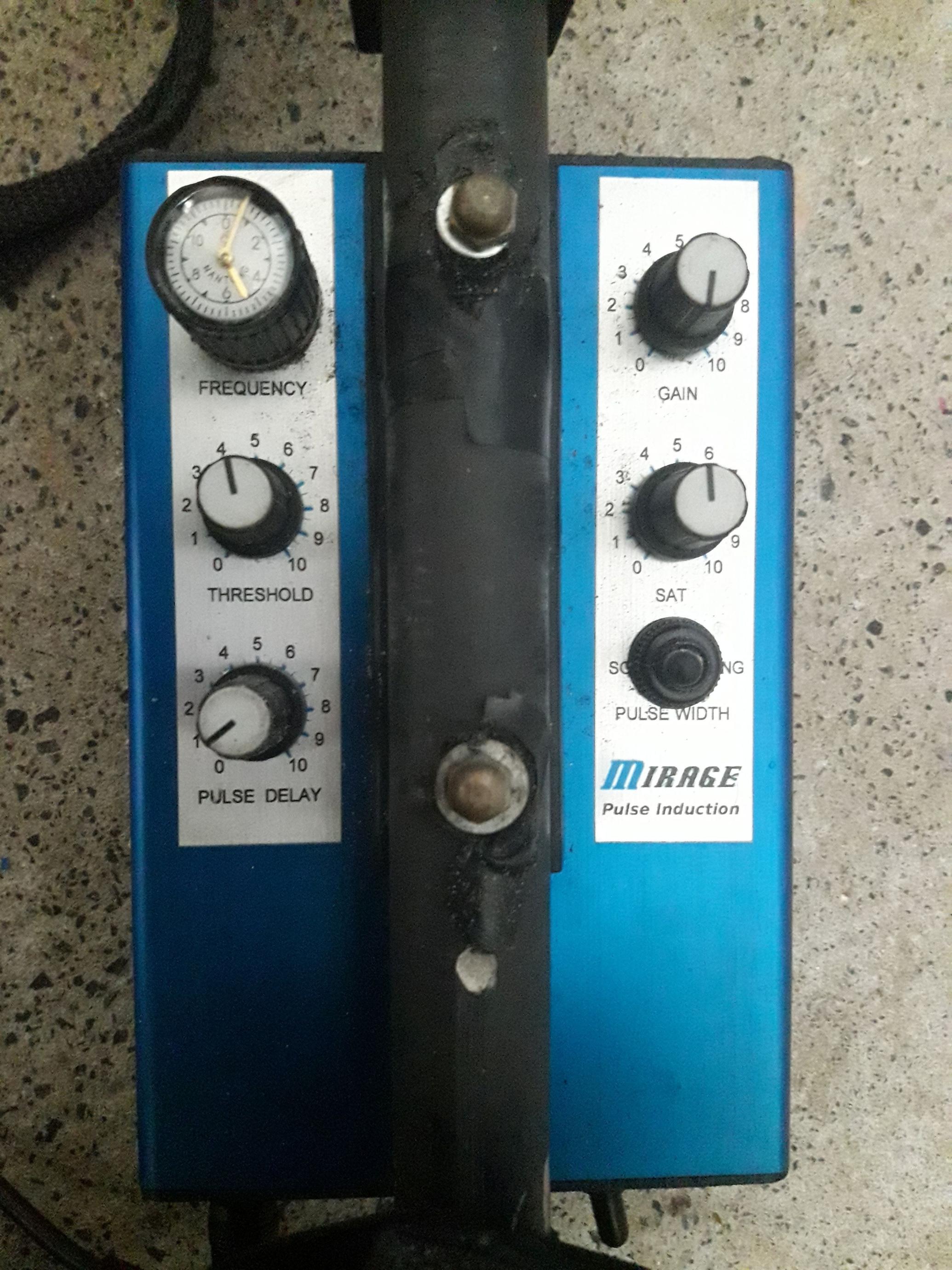

    The detector will be used on beaches, but only the coil may occasionaly be submerged.
    I hope that someone could transfer to a waterproof case and change the location of the knobs (and replace for waterproof if needed) as currently coat sleeve brushes agains knobs and settings are changed, with gloves on changing delay can also result in threshold changing. I carry the detector in right hand so I imagine a better location for knobs would be on the offside to my body like this:

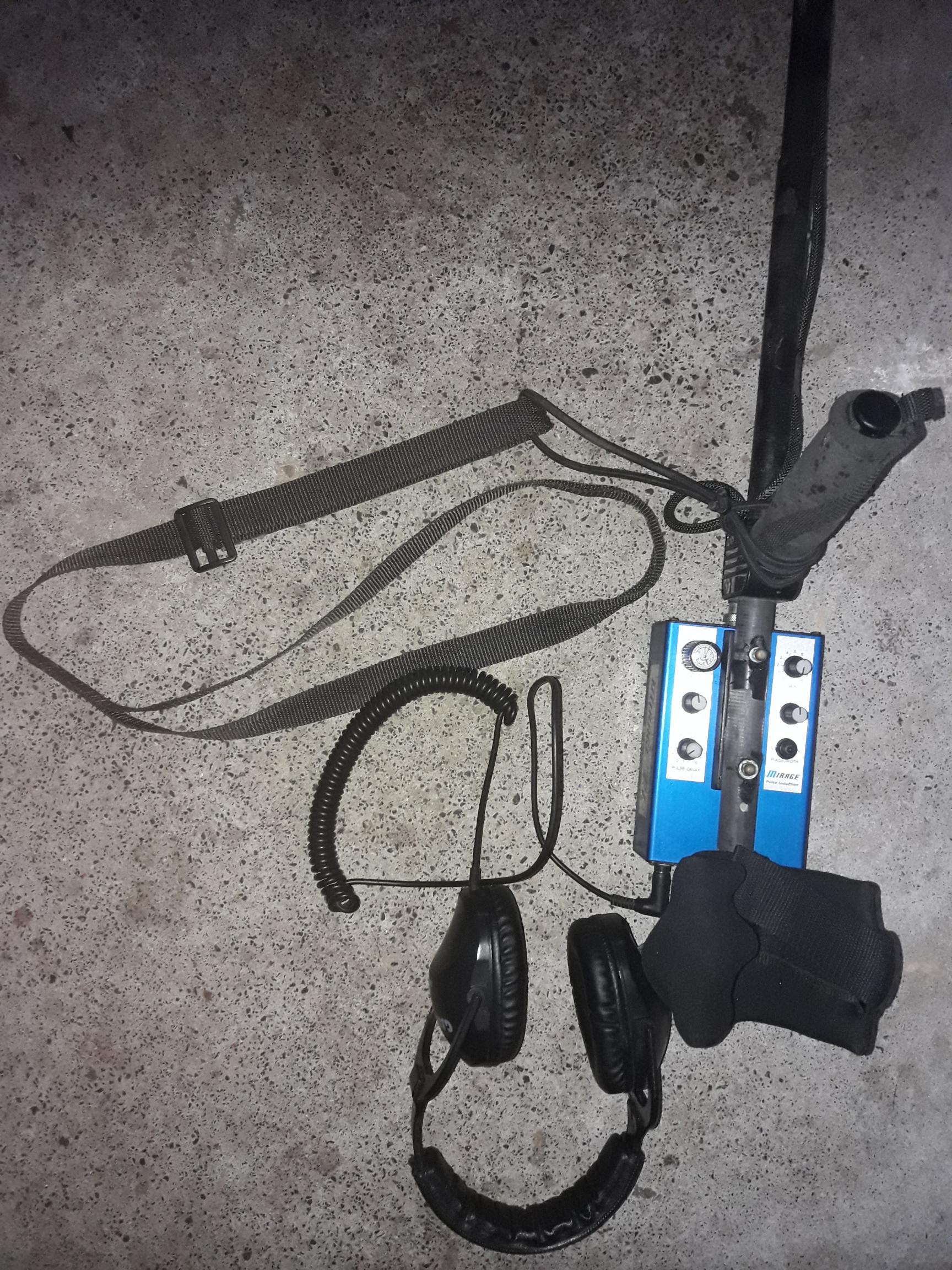

    This is how the current setup looks like.

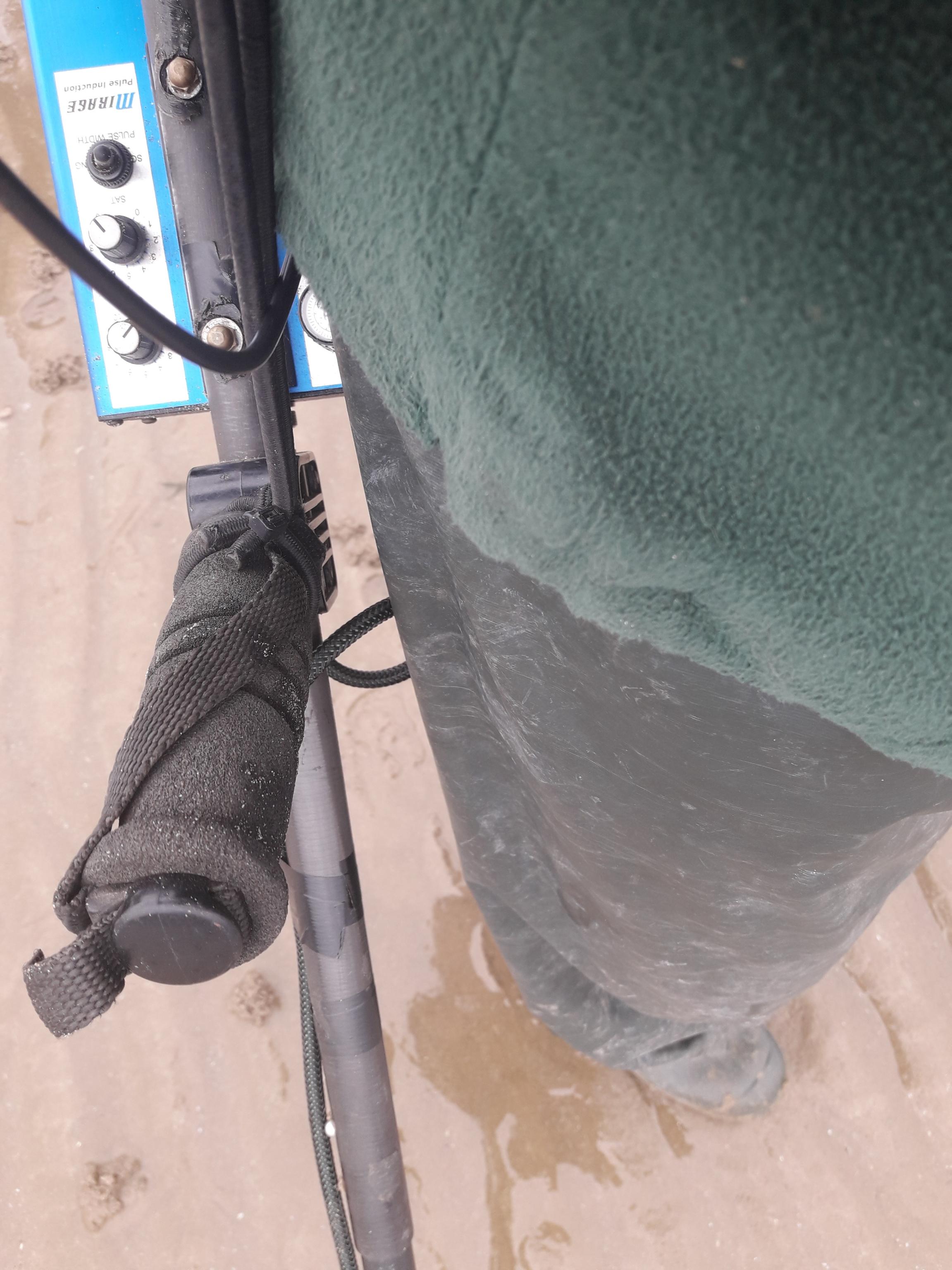

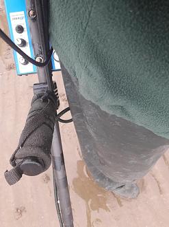

                  I had a friend analyse critically why my settings changed every time I dug a target with the Mirage. I thought it was my sleeve of baggy coat. No, not always. Periodically, the bungee at end of harness rubbed against the Threshold and Frequency knobs and periodically the cable from headphones rubbed against them. Even worse....each time I dig, being that the harness is attached to me and I do not put unit on the ground whilst digging, it is suspended from harness, the unit turns and rubs against the outside of my right leg, or right buttock resulting in the knobs being moved. Bearing in mind this unit is so fine tuned, just a movement of a fraction of an incriment of aforementioned knobs and the settings are changed and it takes up to a minute to reset. There is no joy in that whatsoever.
                  So for now, the Mirage will be temporarily retired as I cannot use it like this.
                  Picture shows the unit just prior to rubbing against right leg+buttock during digging.
                  Click image for larger version  Name:	Front view.jpg Views:	0 Size:	510.4 KB ID:	410283

                    Currently I do not have any simple solutions for you. If you can find some on eto do a conversion, all the pots and switches, speakers, battery etc. attach to the circuit board with
                    plugs. No desoldering necessary. You would need some amp waterproof seals for the pots and boots for the toggle switch. The frequency switch would have to be switched out for a
                    larger Bourne, Clarostat 10 turn pot. Waterproof coil and control box connector would also be needed.

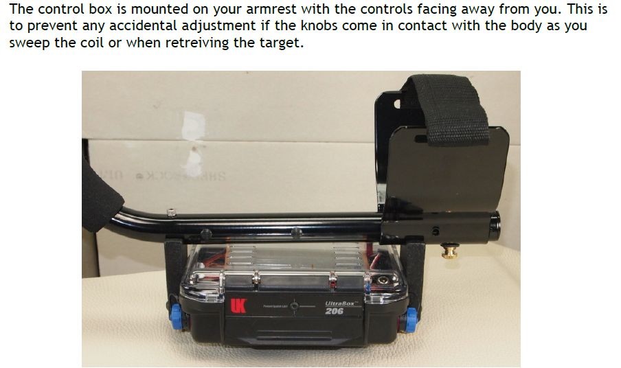

                        Like many on this forum, I took on the challenge to design a fully submersible machine, but it was too challenging in the end without having very expensive solutions (eg submarine pots that cost about $100 each!). I ended up with a splash proof version that I called the Aqualand - can be used both in the rain and on land. It is my heavily modified version of Sven's original Mirage design. It uses the highly regarded Ultrabox case and has weatherproof seals on all variable controls, switches and jacks (for dual headphones/charging port, and search coil). It includes the following controls: On/Off, LED Battery Test, Volume, Delay, Gain and Threshold. The box is small and light weight and I dropped the frequency control due to case space limitations for another pot. Because of the rubber variable control seals used, the pots need a firm hand to adjust them, so any brushing of pants or sleeves was no issue whatsoever. Field testing on a beach near power lines proved no problem whatsoever with EMI (Field Test video link here: https://www.youtube.com/watch?v=1b__o20ziJw&t=204s). The other tricky part was finding a solution to getting a demountable bracket that fitted the arm stem and this specific control box. I ended up designing a custom 3D printed set of clip-on bracket that works a treat (you can see them in the video). Another great feature is the volume circuit design. No matter where the volume control is set, the minimum volume that you hear is always at maximum amplitude, which is great for noisy environment such as at beaches with the wind.
