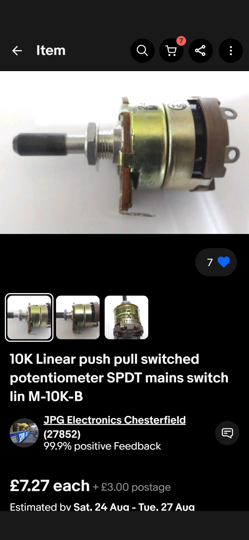

    I got a Baron from Discovery with a Pro Hunter module.
    This makes the detector work with 16 AA batteries! (8 for the Baron and 8 for the module).
    There are things to fix but I have a problem especially with the old potentiometers.
    There are 4 of them: 2 x 10k with an on/off push switch (7 solder pins) - 1 x 100k with an on/off push switch (7 solder pins) - 1 x 100k with an on/off rotary switch (5 solder pins).
    I can't find this type of potentiometer in stores, do you have any idea?
    Thanks.
    Hi the only pots I know of, with pull switches, are used in guitar volume and tone setups and usually range from 100k to 1Meg, linear or log. You could place additional resistance in parallel to the pot to get the right overall resistance but linearity will suffer.
    Click image for larger version  Name:	Screenshot_20240822-080341.png Views:	0 Size:	594.3 KB ID:	427484Just found on ebay along with many other smaller value pots

          Last one is easiest, https://www.ato.com/100k-rotary-potentiometer
          Or Ebay , https://www.ebay.com/itm/264549018346
          3 pins for the pot, 2 for the make switch.

              I don't think it fits! This potentiometer does not have on/off push. I think it has on/off and then 0k-10k regulation​
                you can fit 3-pin pot and a detached switch ON-OFF on the false panel. do not create problems to yourself.
                  Kt, you're right, but it's an additional 3 switches, additional holes and a broken original panel, which I wouldn't do. Better try repairing the existing potentiometers.​
                    maybe this will meet your expectations:
                    I would try to straighten the legs and connect the switch with short cables​. With this solution you will not destroy the casing.​
                      sorry, I posted a link to 500k, it's the right one​ 10k
