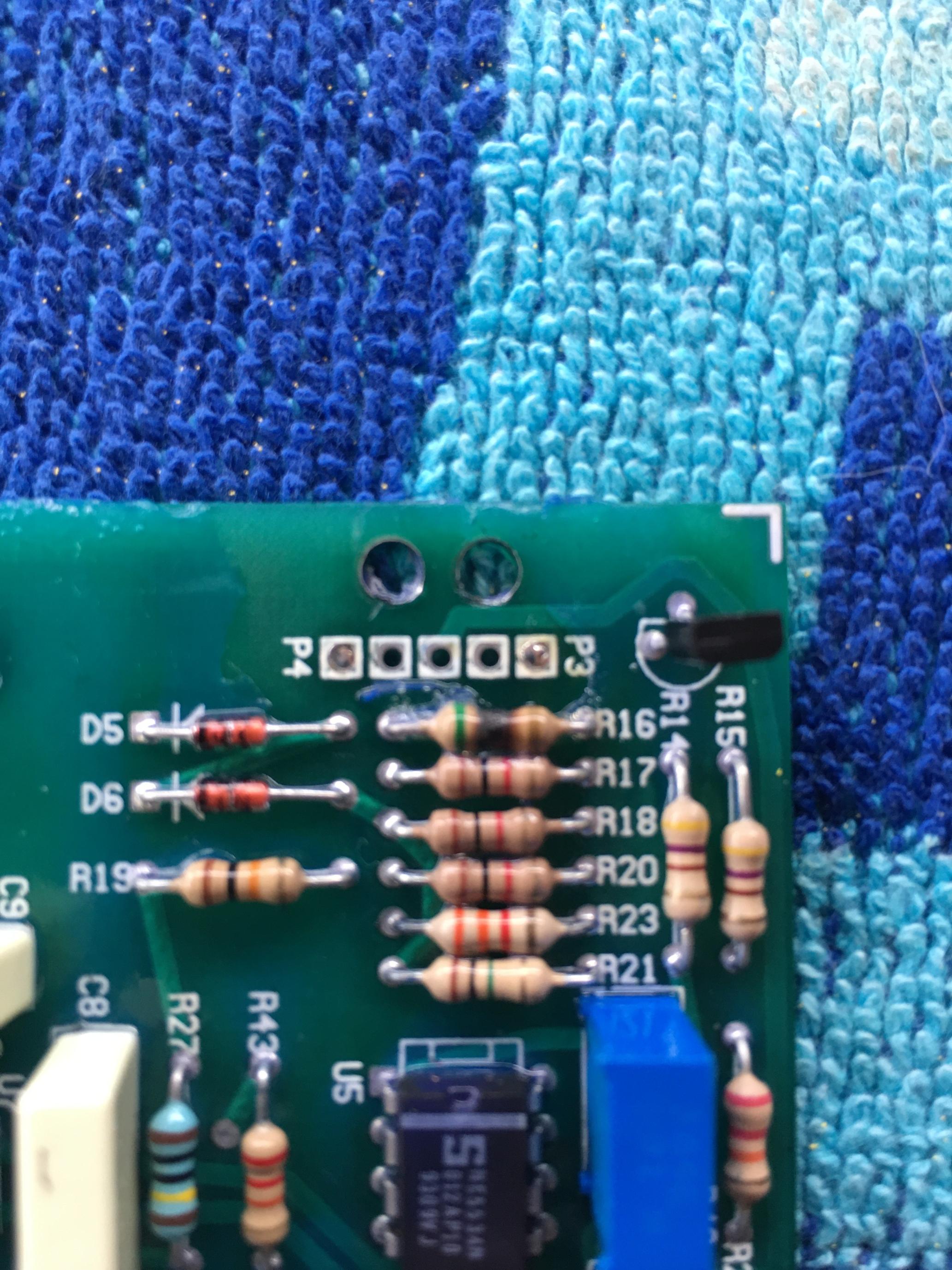

    I picked this up the other day for a decent price and it works just fine. It's not the last word in pulse delay sensitivity but I plan to use it in fast salt water (just behind where the 2 footers break). I believe the pulse delay is in the high twenties and I'm okay with that. I have stripped it down and removed just about everything. I'm guessing it only has seen one or two outings and is pristine. The O-rings were still greasy from the silicone lube and all cables are like new (have been treated with 303 Protectant already). This particular unit was from the far south of my state here in Western Australia so it was never subjected to hot temperatures as the area is cool and cloudy just about all the time. The coil is near flawless and importantly the coil cable is shiny and very pliable....no signs of any age related problems. I will probably swap headphones depending on how my other spare waterproof headphones sound. The PCB is out and although it didn't need it, I cleaned the whole board down with a specialist PCB cleaning spray. The voltage converter (charge pump) chip has been removed from the board (that's the bare spot on the board at the lower left) and will be replaced with a higher rated one to 12v (thanks to Geotech on that advice). I will replace the 6 electrolytic capacitors with new ones as well. A new snap connector power lead will also be soldered on.
    I ran a magnifying glass over the whole board and nothing appears out of the ordinary as far as dis-coloured components is concerned.
    Unfortunately I don't have the skills to actually mod this detector (faster delay) but I'm not too worried about that considering how I will be using it. All cable gland and O-rings will be replaced as well but don't appear to need it. I will also Plast-Dip the lower half of the coil for added insurance. These 950 Zero-Buoyancy coils are well regarded and are almost impossible to find in this condition....they are nice and heavy and require no effort to keep down.
    If anyone else has any other ideas then feel free to comment. I know many of you can easily mod this detector.....having a pulse delay of around 20uS would be nice but I suspect my technical abilities is the weak point.

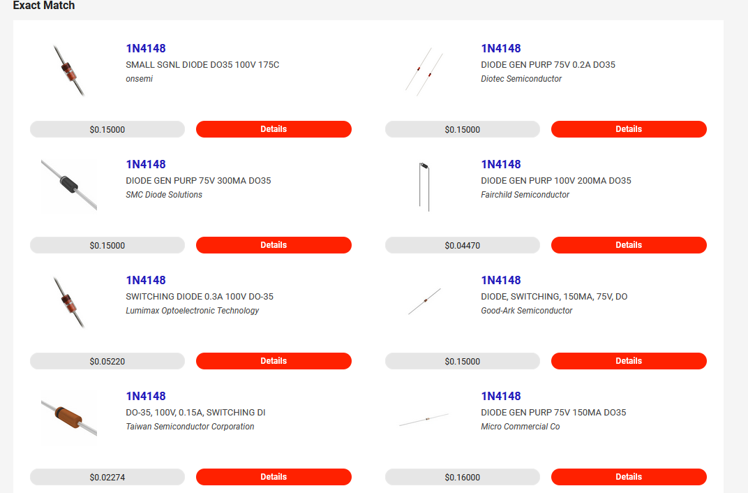

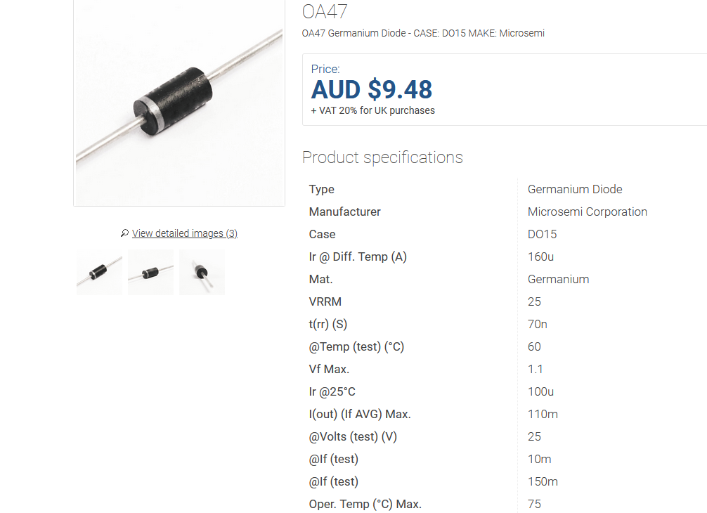

            I do need to replace the OA47 diode (glass style) for the charge pump IC. Any recommendations as these are very hard to find. The nearest would be this one
              1N4148 will work fine. The ones I have are glass.
                Thanks Carl......I shall grab some of those ones locally. Are the voltage and amperage ratings important? Seem to be between 75v-100v and 0.2A onwards
                May as well get the right product !
                  Typically 75V and 150mA which are plenty for the charge pump.
                    Well everything was going fine as far as 6 caps, 1 IC charge pump and one diode replacement was concerned.......shortly after powering on, R16 let out some smoke !!
                    Is the upgraded (to 12V) charge pump IC responsible.....everything else is to original specifications. Both the 6 x 1.5v AA pack and 8 x 1.2V NiMh gave the same smoking resistor.
                    R16 is 5.6 Ohm / 1 Watt (off the spec sheet).............can I simply change the resistor value and if so, what is recommended. Any other considerations?
                    The picture shows the R16 with it's new burnt look....coil pins directly above (coil has been removed).
                    Thanks for any help.
                    Tony
                      D5, D6?
                        Have you checked Q4? Maybe this is faulty too.
                          Originally posted by daluka View Post
                          D5, D6?
                          All diodes across the board are good.
                            you have not ​a pulse signal in TP6 (test point 6). Q3 is constantly open. Q4 is too. R16 burn.
                              just on a time of the repair. after it you have to be back the resistor to its original value.
