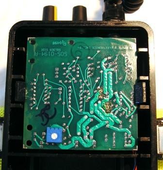

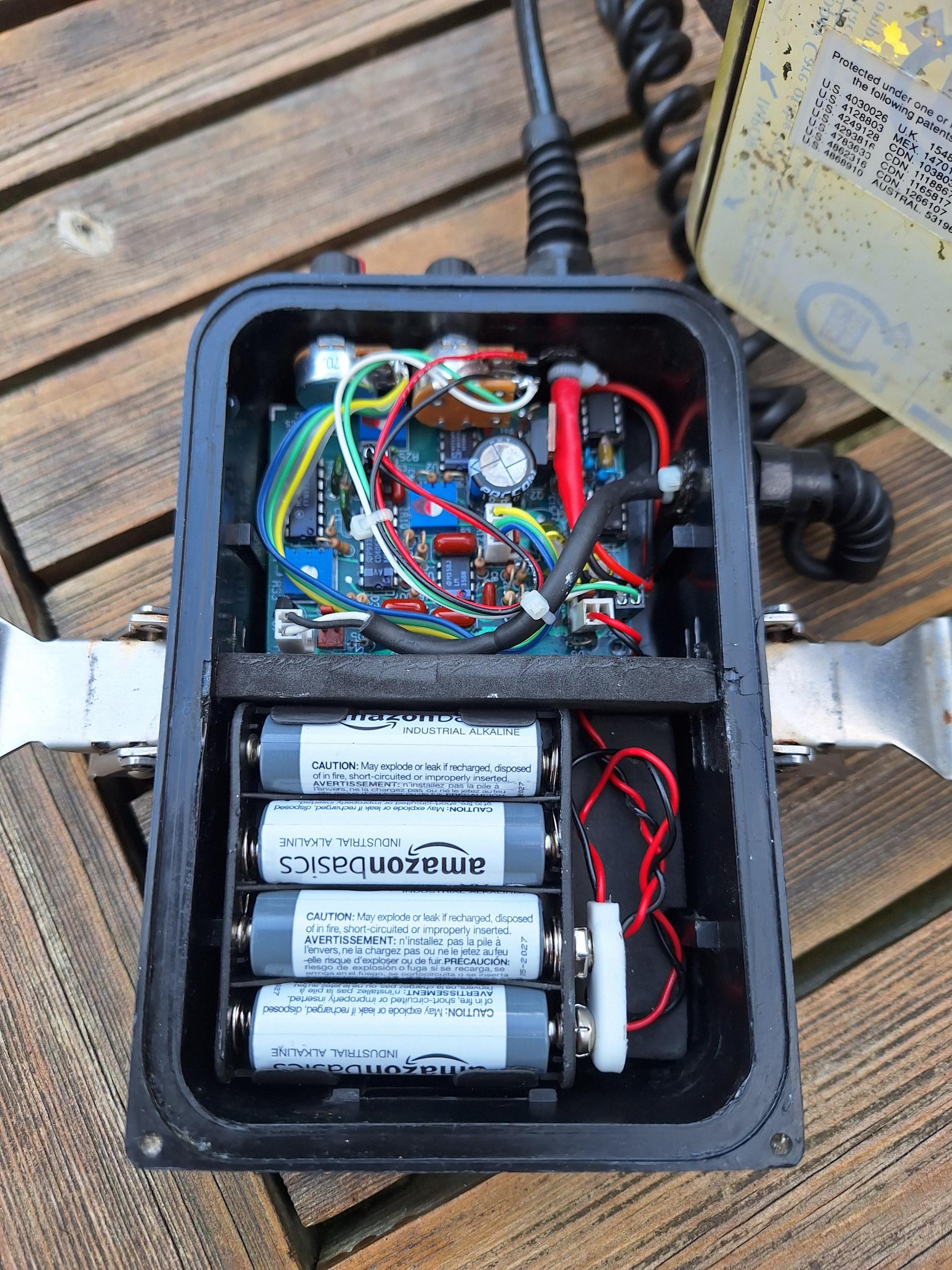

    I have a Surfmaster PI and I'm wondering if someone has better pics of the bottom of the PCB. I'm trying to work on it to do the mods but having a hard time with a section of the PCB traces. Here's what I have as a reference. The upper left area on the bottom of the PCB is a little messy (that's how it was when I bought it).

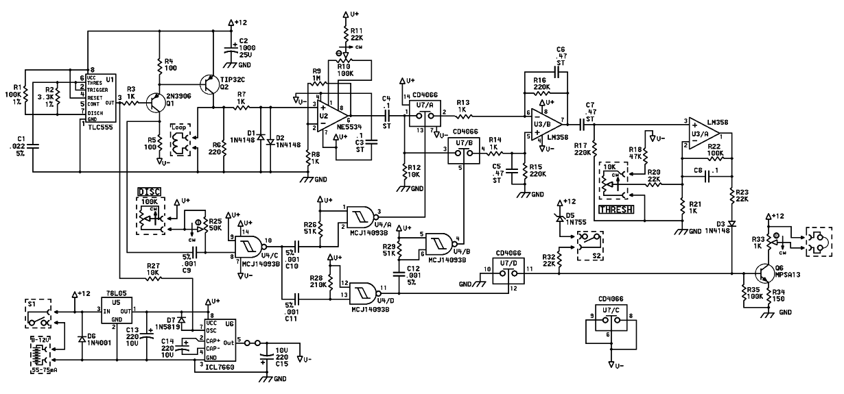

    I repaired one of these recently, but didn't take any photos of the underside of the PCB. The schematic is attached, if that helps.
    I had to replace the TX oscillator and the voltage converter, plus the battery pack. Both controls were also very scratchy and needed replacing.
    It now works as good as when it was new.

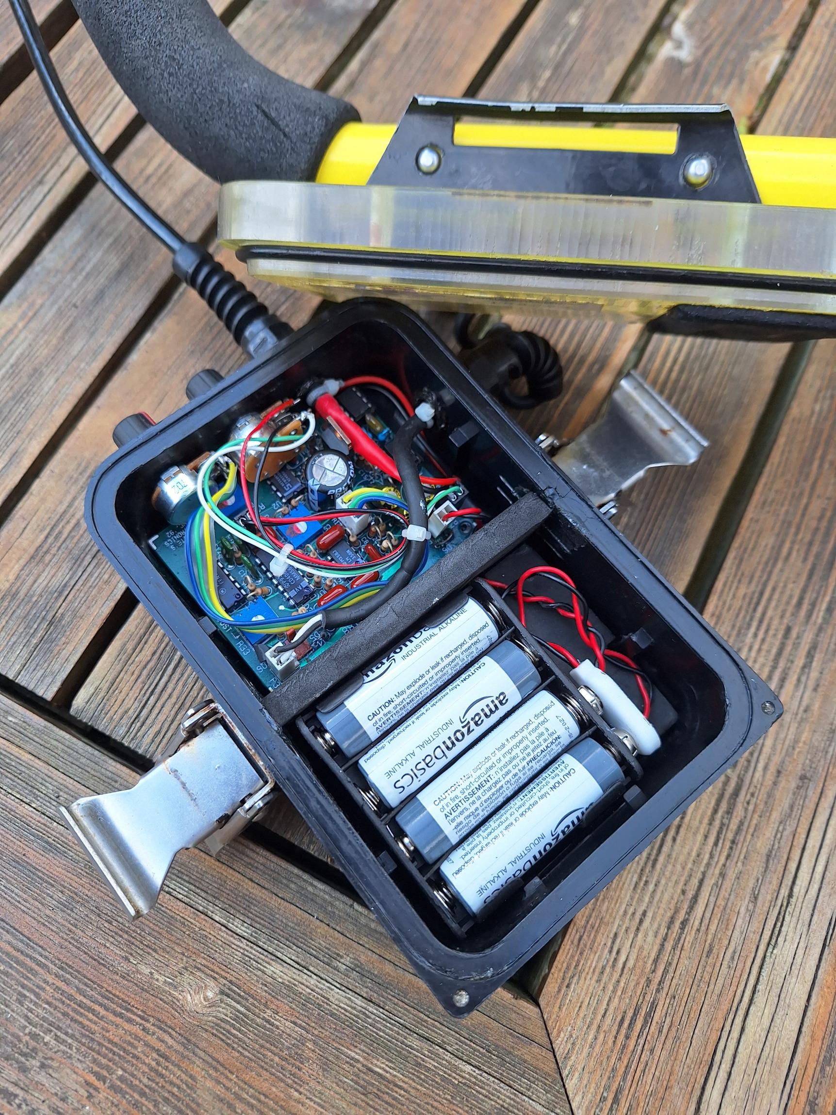

    Click image for larger version  Name:	20241004_121551.jpg Views:	0 Size:	623.5 KB ID:	430135 Click image for larger version  Name:	20241004_121642.jpg Views:	0 Size:	637.8 KB ID:	430136 Click image for larger version  Name:	20241004_121721.jpg Views:	0 Size:	612.5 KB ID:	430138 Click image for larger version  Name:	20241004_121824.jpg Views:	0 Size:	620.2 KB ID:	430139 Click image for larger version  Name:	20241004_121853.jpg Views:	0 Size:	665.0 KB ID:	430140 Click image for larger version  Name:	surfmaster-pi-schematic.png Views:	0 Size:	37.3 KB ID:	430141
      Great pics Qiaozhi. Thanks! I just printed the schematic and will try to trace it. Mine has the yellow coil.

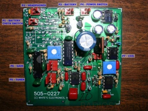

        your board revision 505-0188. you see it on bot side. i see the revision first time.
        you may upload files and compare. folder White's. https://drive.google.com/file/d/1E2g...usp=drive_link
          yes, first time I have seen 505-0188.

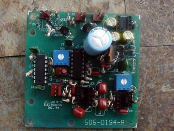

          505-0194-A
          505-0227
          They are all similar boards.

            your board looks to be a little different.
              I definitely have to sit down and trace this one. The bottom side looks different.
