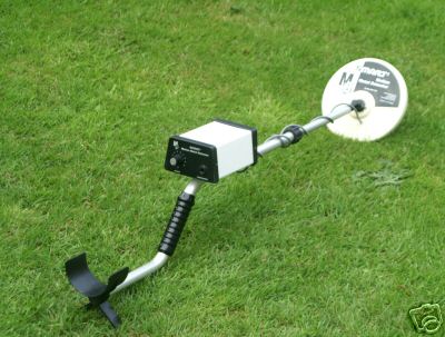

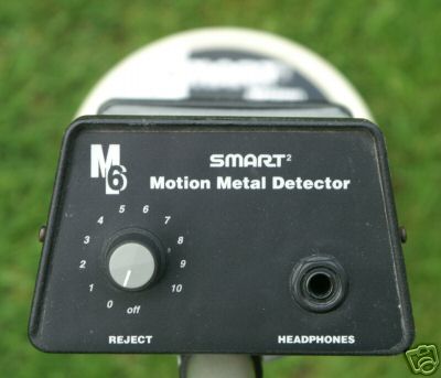

    Sometimes these Smart2 M6 detectors become available on eBay, but make sure you buy the correct model. It must be the motion detector version that contains the Rimatron 7MX PCB. See pictures below.
    Otherwise you can build one from scratch, but you will need to construct your own coil.
