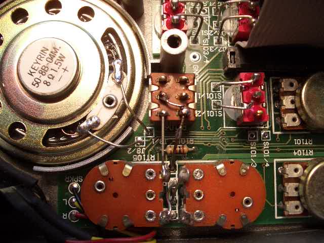

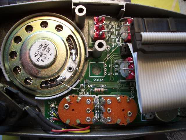

    I recently got me a Sovereign GT. I wanted to do the same mod it and looked around to see if anyone had done it yet, since the switch is actually a 3-position type, and I wasn't sure if it was going to be more trouble than it is worth.
    I opend up the GT, and everything inside it says Sovereign Elite. The main circuit board chip says the same thing on both of my Sovereigns. [Elite rev. 1.1].
    I took some pics of both ckt boards, and am looking at teh extremely slight differences right now.

        I would like to add POWER ON switch and see a space for a resistor. what is your opinion what is it?
        yours.
          kt315
          The vacant spot is actually for a switch. But not for power on/off, since the volume control acts as the power switch as well.

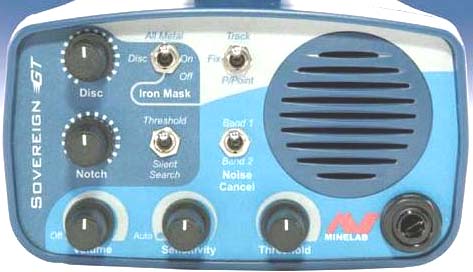

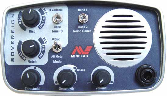

          here are the pics of the face of the Elite, and the GT. The switches and knobs are moved in different locations, but it seems that all the features that were wanted, and modded to on the older Sovereigns, were put into the GT.
