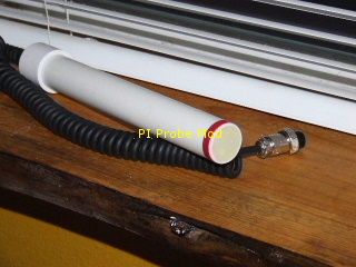

    My Finished Probe
Name:	PI Probe2.JPG
ID:	317242Here is my Finished Probe ,suspended in spray foam insulating sealant and wraped coil in rubber cable splicing form Radio Shack and used epoxy made by Super Glue called Plastic Fusion for the pipe end also heat shrink wires several times.The number of wire turns was 68 of 22 AWG and as for the pipe I used sch 1120 PVC 3/4"
    Buzz
      Buzz,
      Nice looking probe! What size ferrite cores did you use and how many? What detector is this for?
      Robert in SC
        Thanks Robert , The ferrite rod 12.3 mm(approx 1/2 inch) only used one, the core was 2 1/2 inches long and double wraped the end with which for makes for a stronger field. The Goldquest. I need to get a LCR meter but on ohms it read .7 This was a mod on a probe I had . I was only getting 3 inches and now 5 inches.
        Buzz
          Yesterday I built a third probe with a 1/2" rod, about the same as Buzz. 64 turns for 300uH. Performance was about the same as my 3/16" probe.
          "Also, is there a way to make the sides of the coil less sensitive and keep the tip sensitive?"
          This has to do with the permeability of the ferrite rod. I suspect most ferrite rods are not particularly high quality. Also the length-to-diameter ratio affects field focus. So what you probably want are long skinny ferrite rods with high permeability. However, this might also reduce the end-field, I don't recall.
