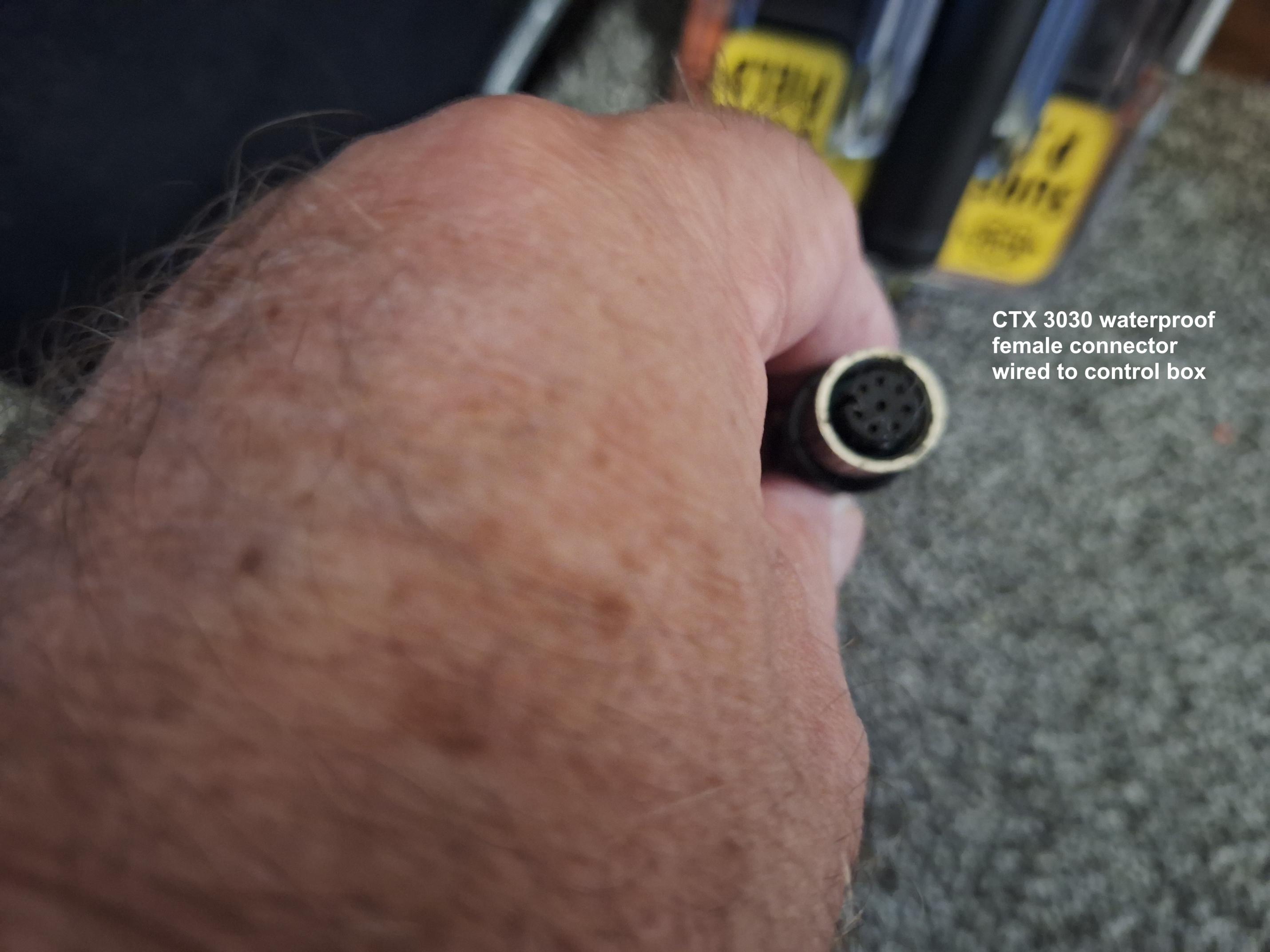

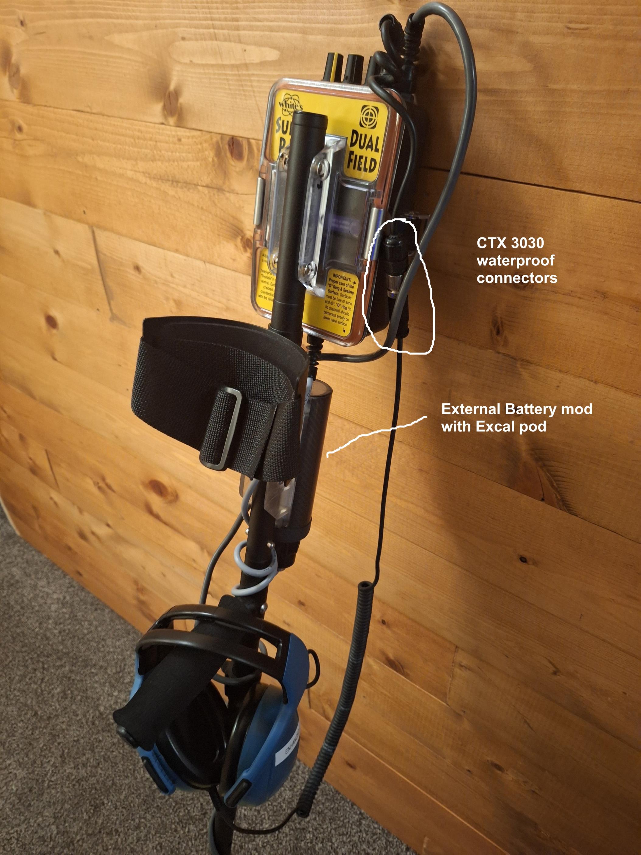

        I recently picked up a Dual Field PI that was originally owned and modified by Joe Beechnut. Joe made 2 mods to the DF, one to allow using a choice of external headphones, the other allows the use of an external battery pod for longer run times and easier/faster charging.
        Click image for larger version  Name:	3 - External Headphone mod.jpg Views:	0 Size:	549.4 KB ID:	440379
        To connect external headphones, Joe used Minelab CTX 3030 waterproof headphone connectors and added a pigtail to the control box that connects to a female CTX 3030 connector. When I ordered my Tony Eisenhower waterproof headphones, I asked Tony to wire the phones with a male CTX 3030 headphone connector, and it plugs in perfectly to the female connector on the pigtail.
        Click image for larger version  Name:	2 - CTX 3030 Female Connector connected to control box.jpg Views:	0 Size:	341.3 KB ID:	440380

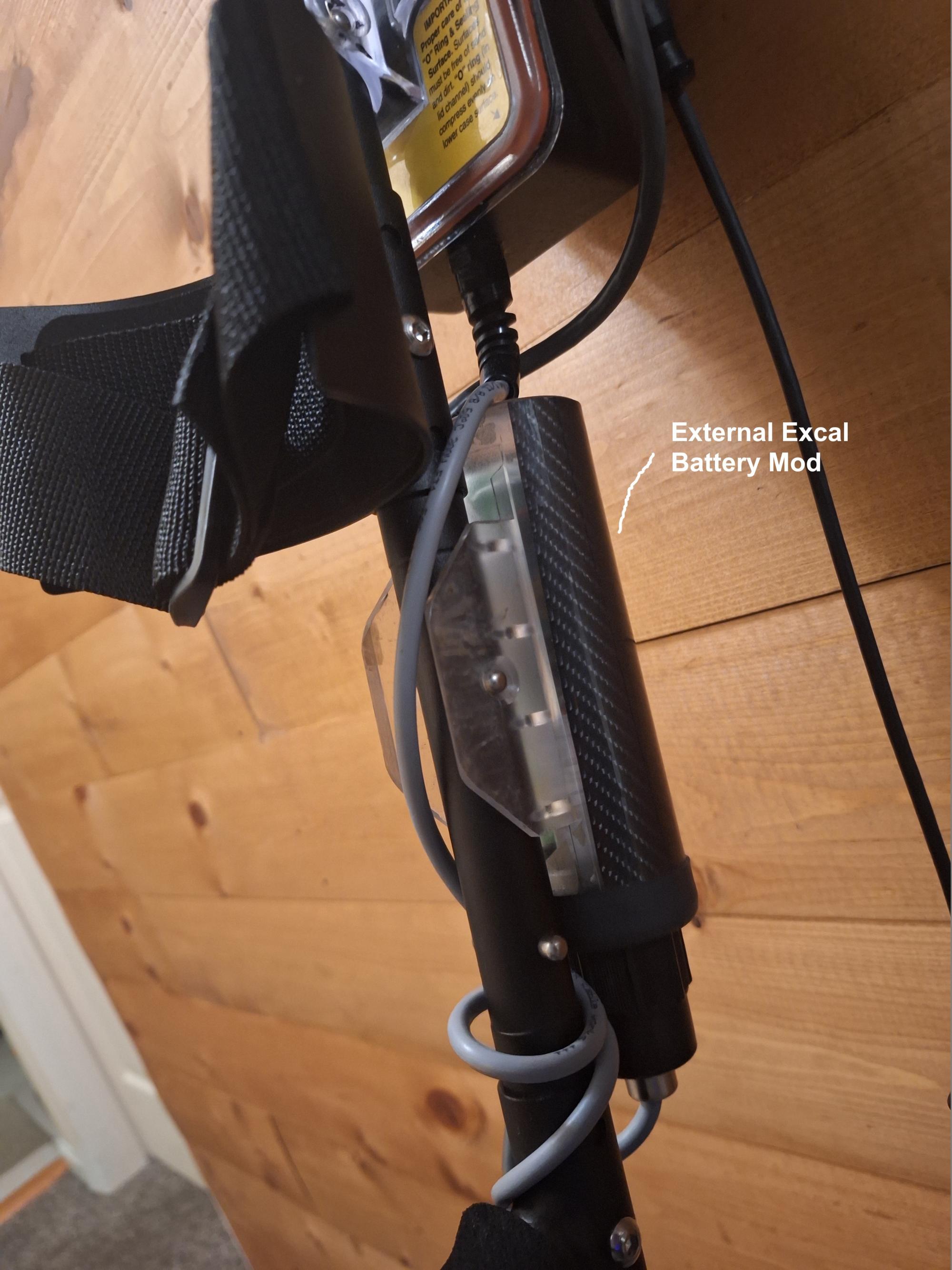

        He also added a mod that allows the use of an external Excal type battery pod, which gives the detector longer running time. And in the case of my Dual Field, eliminates the need to remove the control box lid every time I want to change/charge the batteries. Also, not having to remove the top lid, which breaks the waterproof seal, removes the potential of messing up the waterproof seal/integrity of the control box.
        Click image for larger version  Name:	4 - External Battery pod mod.jpg Views:	0 Size:	386.3 KB ID:	440381

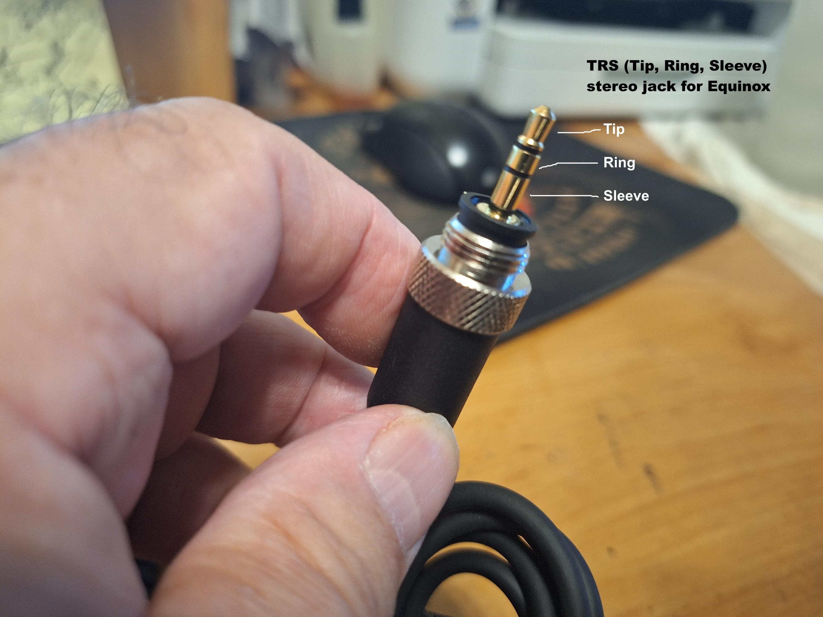

        the stereo headphone jack has three connector rings
        Like Carl said, all you need to do to allow the use of stereo headphones in a mono circuit, is to short the tip & ring, so that each side, right/left, will get the same signal.
        Click image for larger version  Name:	1 - TRS Stereo Jack for a Equinox.jpg Views:	0 Size:	318.9 KB ID:	440382
        BUT there’s a caveat you need to consider if you’re also planning to use your stereo headphones. Remember, you cut the stock waterproof headphones cable and added waterproof connectors. IF you also wanted to use a standard pair of stereo headphones with a ¼” jack, won’t work. You’d have to cut the ¼” jack off and replace with the same waterproof connector that fits the female connector you used for the control box. Doing that would turn those stereo phones to mono, and by changing the ¼” jack to match the waterproof connector, you’d be making those stereo phones dedicated only for use with the detector.
        Personally, I’d add the waterproof connectors to the stock waterproof headphones and leave it at that. Or if you want higher quality waterproof headphones, like Tony Eisenhower’s, you’d just tell Tony to use the same male waterproof connector you used when you converted the stock phones. If you use your stereo headphones for listening to music or watching movies, chances are high that they’re not waterproof, which defeats the purpose of using on a waterproof detector. And you’d have to swap the jack for a waterproof connector, so you no longer would be able to use them to listen to music/movies.
        IMHO, for detecting on the beach or in water, mono is totally fine as all we need to hear is a beep, it doesn't need to be in surround sound, lol. Stereo isn’t required since we’re not listening to music or a movie. Mono allows you to hear the beep in both ear cups, so stereo headphones really aren’t needed, unless you have a detector that’s designed to broadcast the beep in stereo. But on the beach/shallow water, there’s so much noise with kids screaming, waves crashing, go fast boats going by, that all you really need is to be able to hear the beep to know where to start digging.
