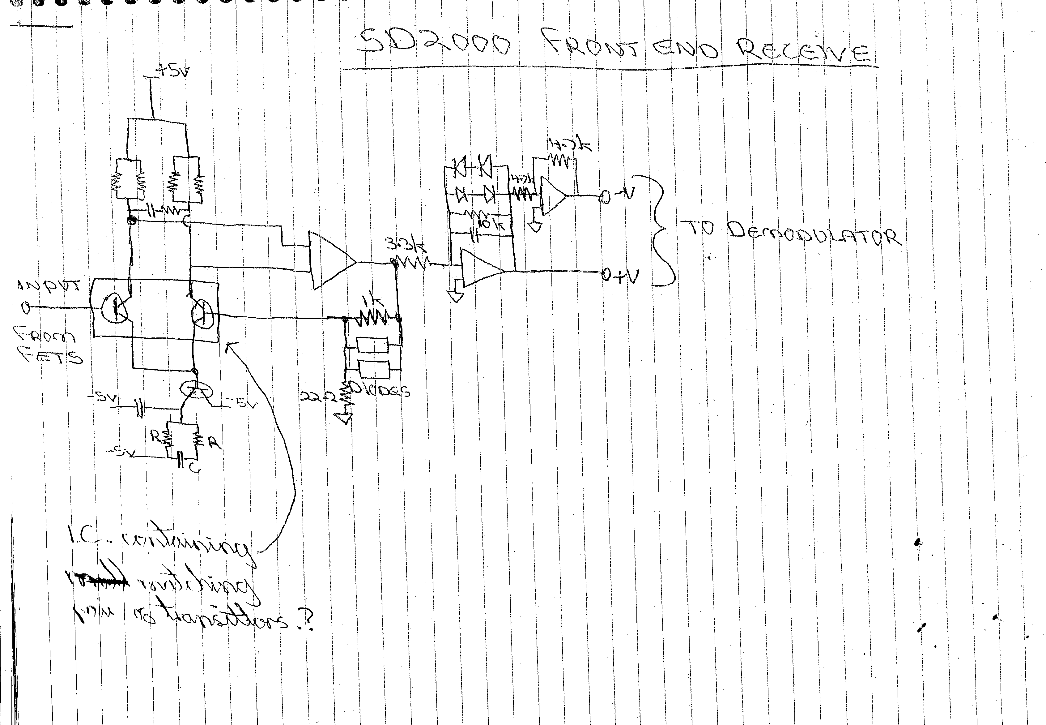

    This is an easy modification that will improve the depth and sensitivity on a Minelab SD2000 and/or their other detectors that use a LM394 in the front end. The mod is really easy, just remove the LM394 and install a SSM2210.
    They are pin for pin compatable except that the SSM2210 has much lower noise. The noise figure is about half that of the LM394.
    You can optimise the noise figure and gain by adjusting the resistors that are associated with the front end matched transistor pair. This is a real experimenters mod and is a tedious process.

      I sure hope you checked that schematic up against your own 2000 to make sure it is correct.

      Woody and Members good job on the mystery IC,it had me puzzled for years.

        It is part of the VCO audio generation, I had the number written down and now I cant find it, will put up the other chip numbers when I find my notes.
          The IC above is 4093.
          Regards Ismael

                Can't be a 4093, this is a 14 pin quad 2 input nand. However the 4053 is a 16 pin analogue multiplexer.
                Stefan
                  Hi Stefan, actually the IC above is a 14 Pin not 16 as was stated. Below is a picture of the layout and IC's we know:
                  Just to add to these images the ones in blue are actuals that I know for sure and the pink are from circuit diagrams I have. This is updated as I do know some of the missing ones but have misplaced that info!!
