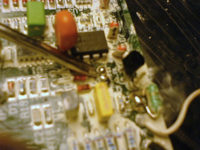

      Well Ismael, I totally stuffed up on what I thought was the coil driver fet, it is not the IRF710 but the pair of BUK455 that are connected in parallel. Now I suspect that the IRF710 is for energy recovery as the detector works with this fet disconnected from the circuit! I think that there is meant to be a pulse that goes to the gate of this fet from the output of the TLC271 but I only have 2 volts of DC at this point. No wonder the fet was getting hot...
      The 2 BUK455 fets get a little warmer with the irf710 out of circuit, The out put from the TLC271 also goes to the input of a LM393 as well as the fet gate resistor, I replaced the 393 but no change, will have some TLC271 chips in the morning to if it is the culprit. Now I wish I had looked at the gate of the irf710 before going the hog and carrying out so many mods What I think happened is that I grabbed the board while it was turned on and the 200 volt flyback on the drain went into the gate compliments of my finger.

          I have a feeling that the IRF710 is only a voltage limiter, I traced the output from the Fet and it goes through one diode and 2 resistors to the input of the TLC297, no pulses there? After checking all the associated parts I think that the job of the IRF710 is to limit the voltage across the coil, the detector works fine without the IRF710 in circuit. To me it looks like the IRF710 is operated in its resistive region, I think it maybe has something to do with the way M/L snap off the coil current before saturation. I will do some more experiments just to make sure the detector is working the way it is supposed to operate.

              I put in a pair of W20NK50Z in a To247 package. That IRF710 just clamps the voltage so that the flyback pulse does not get over 190 Volts,When I disconnected it the flyback voltage shot up to 382 volts!!! I have just installed the new front end fets that I had roll up today, that P channel fet in the input when changed makes a huge difference. Look at the pointer in the pic pointing at the new fet, can you see the little black spot? The solder pads are bigger than the fet.
