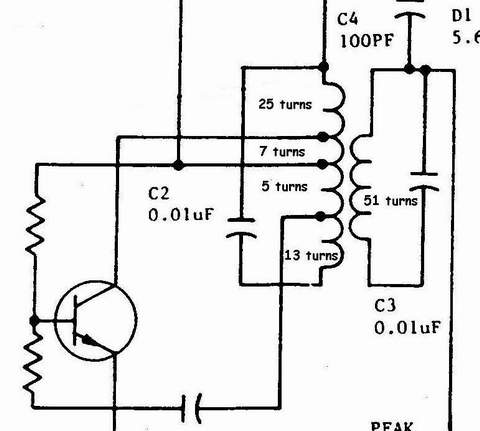

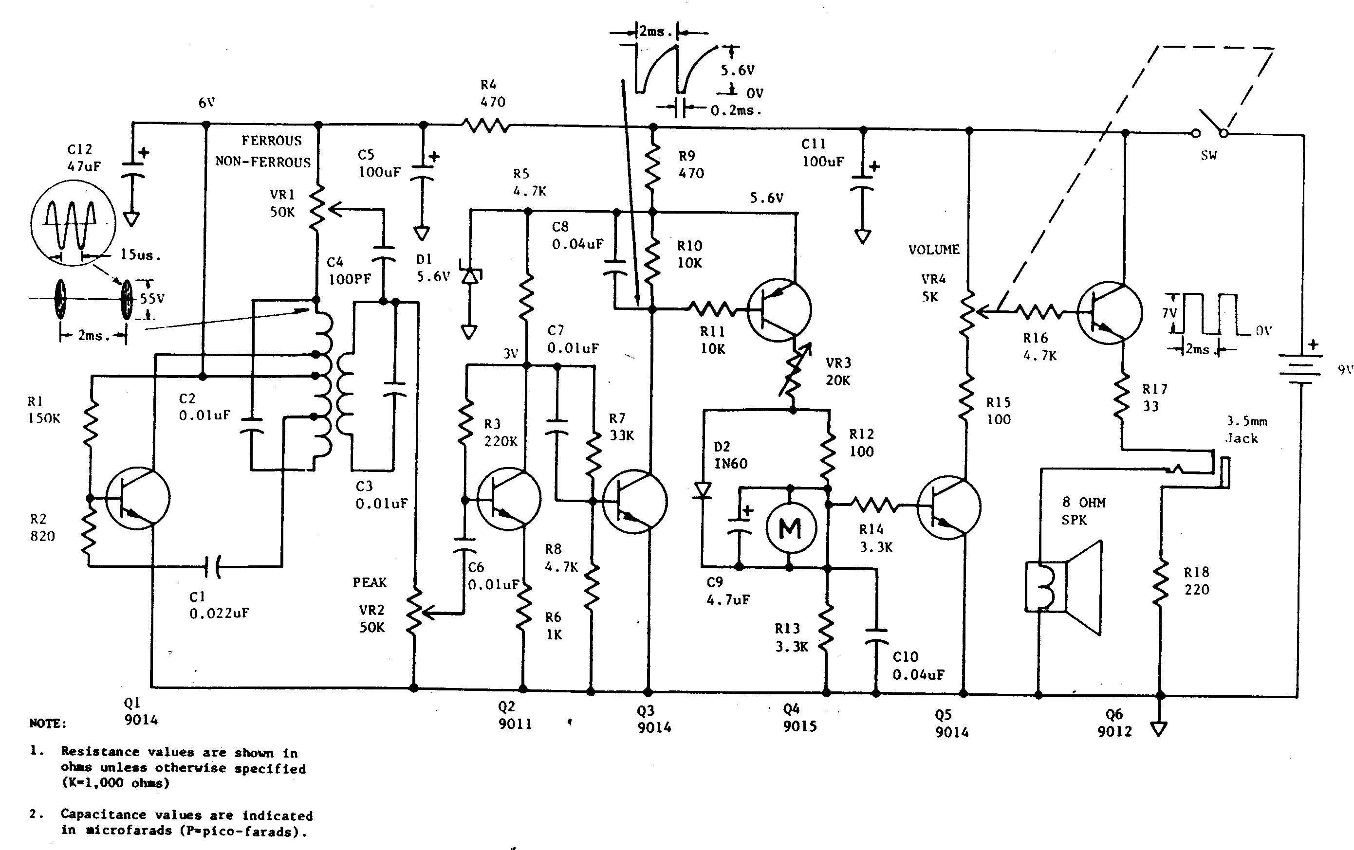

    Here's the circuit, but personally I wouldn't bother. As you can see, this detector is only a toy.

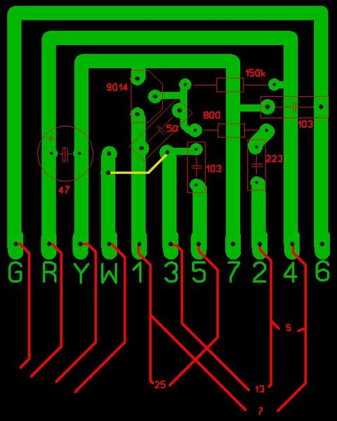

      Listing through my old files i founded out more details on Micronta 3001!
      Here is how coil was made:
      (it is double "D" coil with 16cm diameter TX is having 4 segments with 25+7+5+13 turns and RX is having 51 turns)

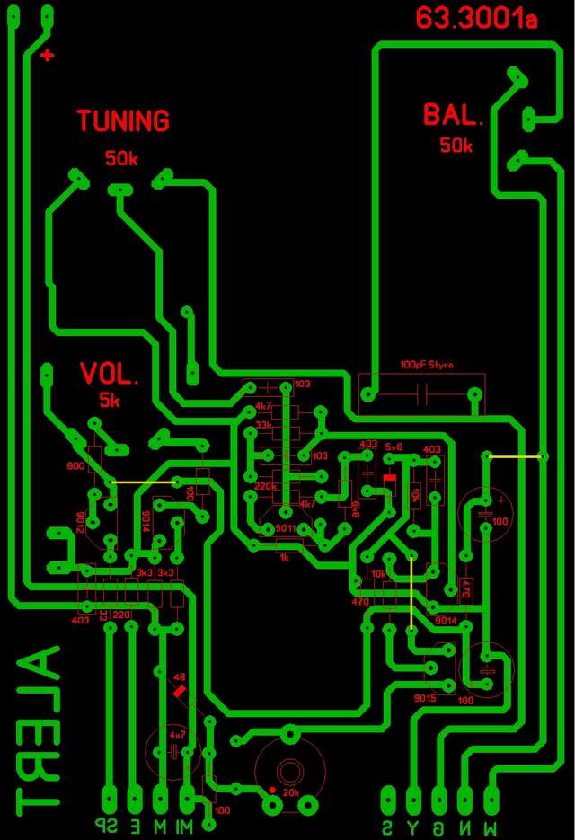

        Main pcb:
          Small pcb inside the coil:

            Good old, crapy, useless, Micronta 3001!!!
            No, really... i am tempted to make it!
              Other hand... it can be made ultra compact and used as nice pinpointer!?
              Why not?
                lol
                you make it and tell us all about it
                  lol
                  Maybe i will, it can be made on very small pcb.
                  Coil maybe a problem to make such small to use as pp.
                  I've seen original 3001 in action, not that good!
                  Yet it is much better than most of pinpointers i have seen so far.
